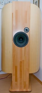

Hollowboy with the wing, do you mean a rectangle shape that extends past the side of the driver?
Like this pic, but make it asymmetric.

Thanks for the image Hollowboy, I'll think about how I can do this - at least I'll give it a test with cardboard and see how it changes things.
