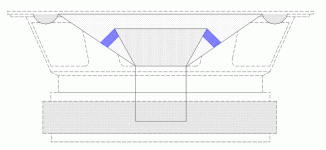

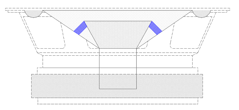

Any whizzers I own automatically get the $0.98 tweak and with rare exception, its rim gets kneaded to attenuate its bell modes.

Thanks guys! I'll keep plugging away at this.. Break in, modpodge, and the $0.98 tweak are all on the list of things to try.
Dave - thanks for the great illustration! I'm going to start with GM's advice on break-in and crank up some hours.. Lousymusician's post confirms that specific improvements in my area of concern are possible as well.

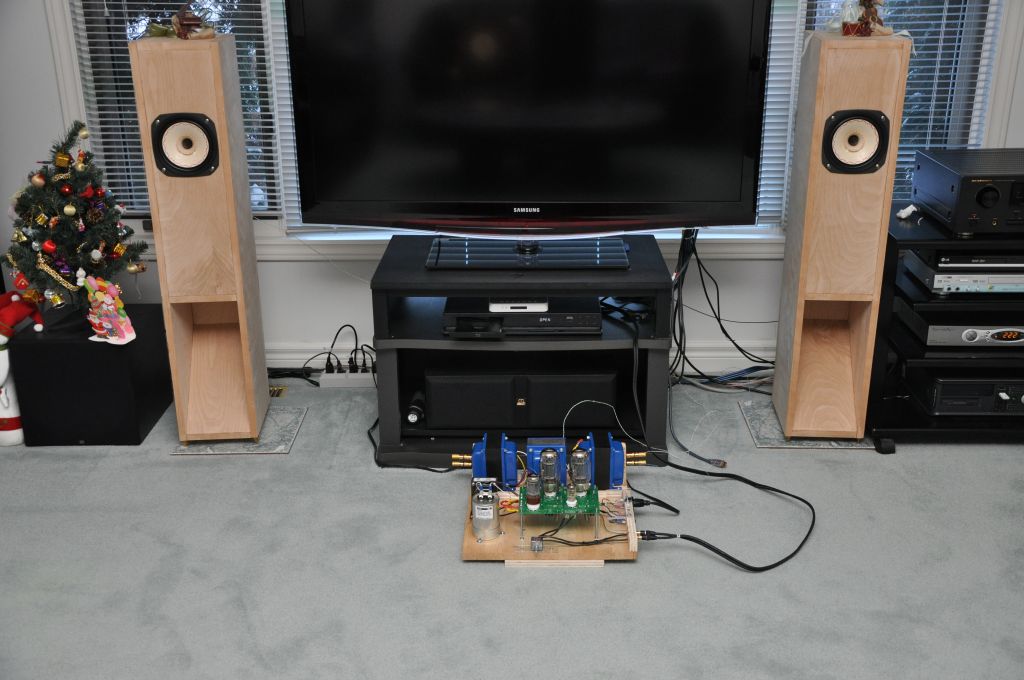

I have build the HCC using 167En from info & help from this site and driving it with another diy build-the simple SE.
Loving it, the only problem is the setup is so revealing that it exposed all the bad recordings.
Wondering whether you are using BSC with your HCC? Based on listening and measurements I find it indispensable.

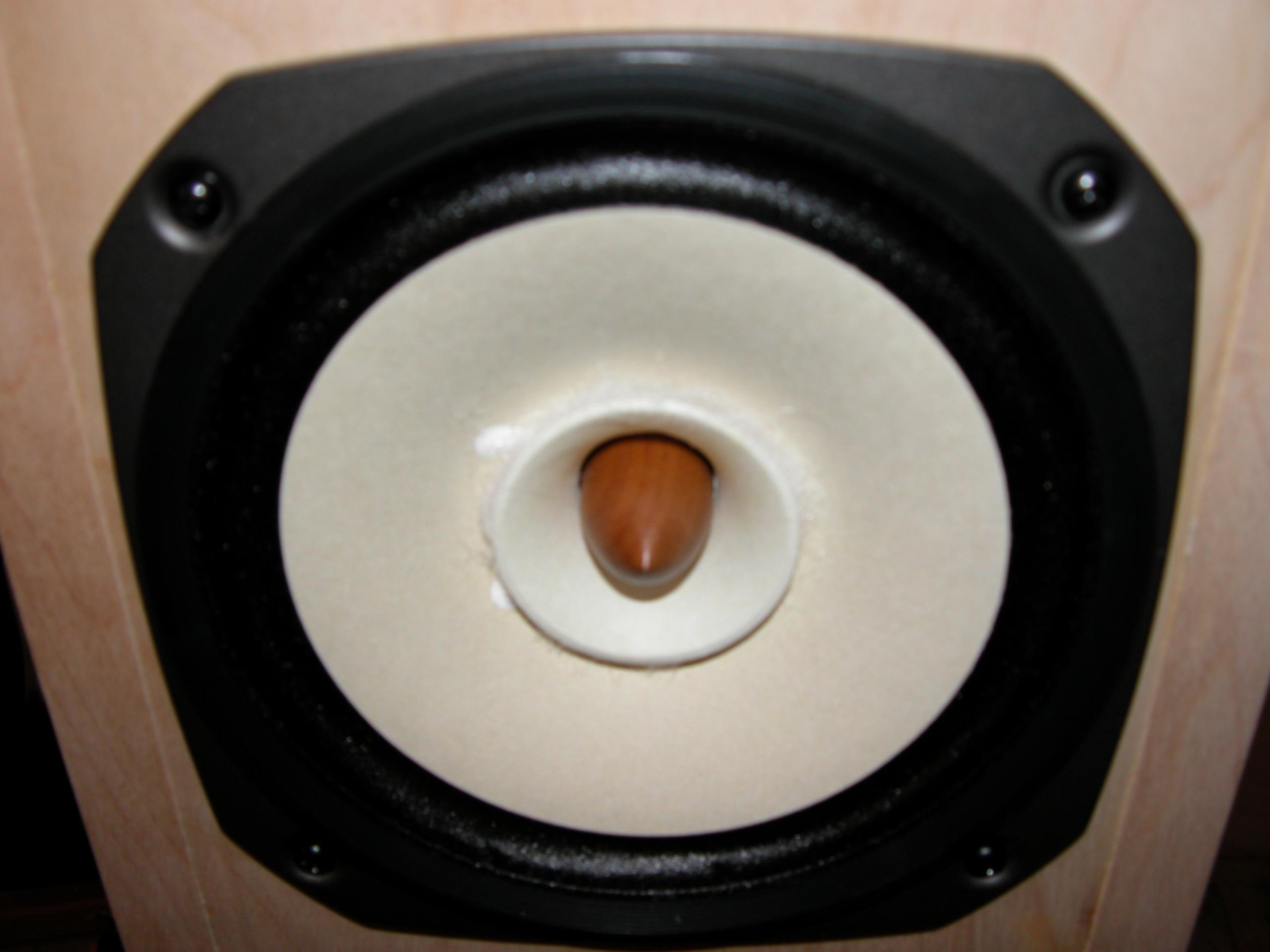

There has been some progress with the whizzer issues I have been having. Last night I teased out some acoustical batting into a long thin bundle of threads and loosely wrapped it around the whizzer and the cone. To say it made a difference was an understatement, at first I thought most of the highs went along with the sibilance and odd high frequency rubbish I was hearing, then I started to notice that things that sounded somewhat lost before like a brush on a cymbal were for the first time clearly audible.

I should mention all of the sibilance was abruptly eliminated with the whizzer tweak, and I am not aware of any deficit in the high frequency response.

So if I were to rank the relative importance of the tweaks I've done so far I would say:
  1. Whizzer damping tweak
