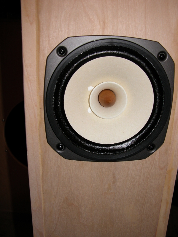

I ordered a set of phase plugs from planet10 today.. I hope to hear some improvement in HF directivity and some reduction in sibilance as a minimum. It's quite pronounced on some material (vocals, but also some percussive sounds) even at reasonable Spl levels beyond say 80dB or so at my listening position.
These drivers need to break in, but I am not sure what to expect yet other than a possible improvement in bass extension..
I've got about 16 hours of run in time on these drivers so far..

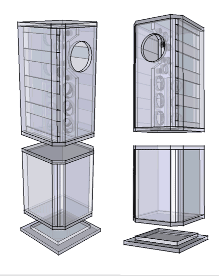

At the expense of a more fiddly build, an additional box to consider for the FE167 is the Fonken167. In its lastest iteration there is sufficient space in the (optional) base to support a woofer -- the design was tweaked to make this easier,
I've thought about this design but am limited by my woodworking skills. Also, how much more will I gain vs a ML-TL in terms of time, effort and $$$? I'm not convinced its worth it or should I be?????

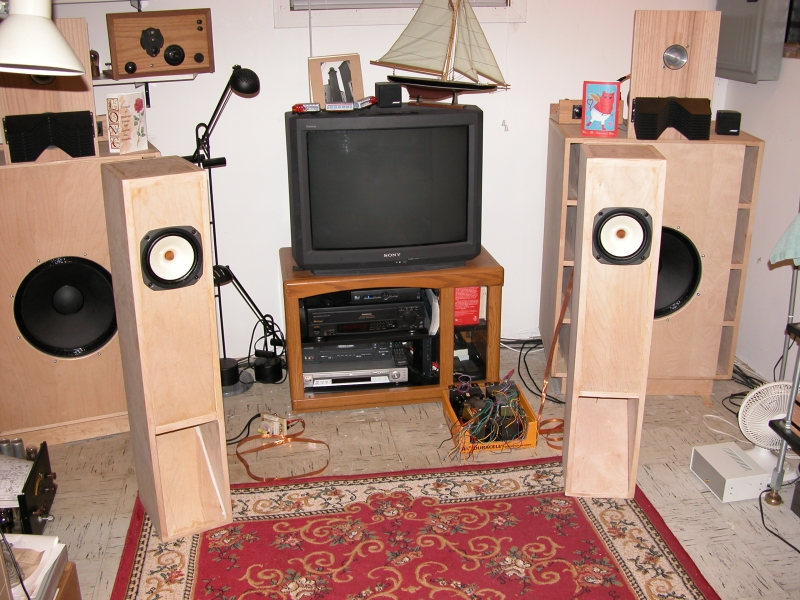

They have improved noticeably in 20hrs of use. They will suit the intended purpose quite well. (Audio fests, small parties, change of pace, etc.)
My reference system is very large diy Onken bass cabs with 16" Iconic 165-8 woofers, so I am well acquainted with what a good bottom end sounds like. Subjectively there just wasn't any bass without BSC with the FE167 - what there is with it sounds pretty good actually. (Room measurements confirm both.)

While the HCC is not an Abby I think they are sounding better every day.. I use them a lot - I guess it is the attraction of something new to play with.. Now I have to figure out where I can put them so that I can use them regularly because ultimately this room belongs to the Onkens..
My speakers look a bit industrial, but I've always cared more about the performance than appearance although these days I try to make something that has at least a little WAF amongst other things..

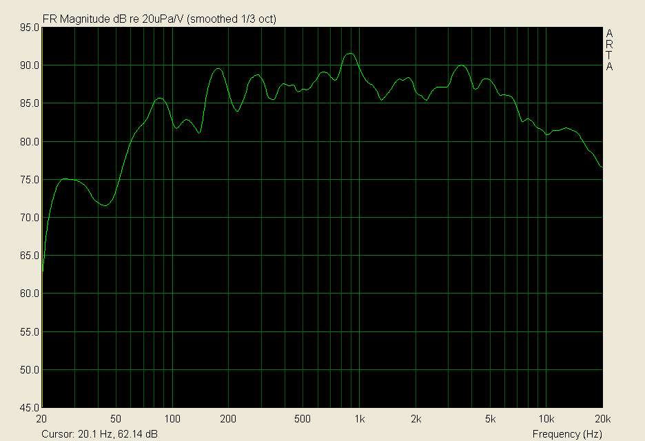

As Promised: In Room FR Measurements
The attached graph is the result of my most careful (not very) measurement in a very cluttered listening room. Note that I have used 1/3 octave smoothing, the spl levels referenced are accurate to within a couple of dB based on comparison with my long ago calibrated spl meter.
The response could be considered flat within +/- 5dB from 60Hz - 15kHz excluding the peak at 900Hz, which considering the environment this was done in is something of a miracle. There is a lot of room interaction, probably in an anechoic chamber or outdoors the response would be significantly flatter.
Note that I would not consider this measurement (the best of several) to be anything like definitive. I'm playing with Arta and measuring my latest speaker system is all - and I am on a learning curve as far as man cave acoustical measurements are concerned.
Also despite what you might possibly and mistakenly suspect from these measurements they sound quite good. While not in Onken territory, they image quite well, have a subjectively smooth if somewhat bright sounding presentation and resolve better than I expected. They are quite listenable on a wide range of material which is a BIG surprise - I'm currently listening to Depeche Mode and they are doing quite well. Despite what the measurement indicates about treble response I am not aware subjectively of any lack of HF extension. Occasionally I am aware that something like a high hat, snare or synthesizer sounds quite wrong, and there are still hints of sibilance here and there - they do seem to be improving.. I expect the phase plugs will help a lot with the HF performance. They do seem very quick, and the bass is well controlled (what there is of it). They do not go very deep, but what bass there is sounds well controlled. The BVR horn end contributes most of the low end..(Obviously?)

I carefully installed the phase plugs tonight and spent about an hour listening. I also ran them in "break-in mode" for a short period of time at around 800mW at 30Hz. (About 20 minutes)
I really did notice some significant improvement in imaging on axis, and a reduction in sibilance as well..
I reswept them and the 190Hz high Q resonance has moved up to about 210Hz and is somewhat lower in amplitude since I removed the dust cap.. The whizzers buzz at certain discrete frequencies out to 600Hz where I stopped sweeping.. (There is only so much one's ears can take.. ) Overall the phase plugs improved a not great situation considerably so if full range drivers are really your bag I think this is a good tweak to spend some money on.
Subjectively the imaging improved from my dedicated listening position, highs seemed considerably smoother, complex multi-layer vocal tracks gained clarity, subjectively off-axis dispersion has improved to some degree. (Umm, still not great.) Not sure what the measurements will reveal, but I expect there will be some improvement in high frequency response & smoothness.
The phase plugs are beautifully finished and popped in with a minimum of fuss once I cut out the dust caps.. Incidentally the sharpest X-Acto knife blade is just sharp enough. I installed a new one on my knife and it was just adequately sharp so in short do not use a used one!!
