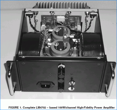

... LM4702 was most probably designed only with BJT Power transistors in mind
- like those big darlingtons used in that 100watt amplifier application note
Here is a picture of that 100 watt beefy looking thing:
Lineup: Great picture = tells it all.

From link(s) below: " ... Do I need a heat sink for the LM4702?
You do not need a heat sink on the LM4702 itself. However, it is necessary to use a heat sink on the output stage. The LM4702 does have internal thermal protection, but this does not monitor the output stage. ..."
I'm speculating a little bit here: National would, of course, like to build a "one size fits all" type of power amp / pre-amp input stage chip and I bet there are plenty of mass market manufacturing customers who will want it that way (for reduced inventory headaches, etc.). The "BIG" heat sink (as AndrewT points out) is certainly needed for those cases of very significant rail voltage and power output, ~=> +/- 50 VDC or more, and if (as most manufacturers will probably want to do) there is one single power supply for a whole mass market production device (for cost savings, low parts count), then mounting the die on a extra "BIG" heat sink will fulfill the requirement. Additionally, the manufacturers will also want a common heat sink for the '4702 and any output drivers, and that "BIG" heat sink tab will thermaly stablize (and thermaly lock) the input parts and output parts together = more accurate voltage following and better over all specs like THD, popcorn noise rejection, CMRR, etc.
Good eyes, Lineup: This is very interesting: http://www.werple.net.au/~gnb/audio/lm4702.html >> " ... At 10 Volts RMS output, THD+N is about 0.005% across a 20 Hz to 20 KHz bandwidth. ... It steadily drops to about 0.0015% at maximum output voltage. ..." (It would seem that there is a decimal place error: /=/ 0.015% ?) " ... At very low output voltages the data sheet shows that THD+N rises to over 0.1% ..." (this is more likely National's reality than the author's).
Interesting design & build suggestions all over this web page like: http://www.werple.net.au/~gnb/audio/images/4702GndPinConn2d30.jpg (& http://www.werple.net.au/~gnb/audio/images/4702GndCurrent1b10.jpg ), http://www.werple.net.au/~gnb/audio/images/4702Heatsinking1e20.jpg ... setting the "mute function": http://www.werple.net.au/~gnb/audio/images/4702MuteResistor1d5.jpg
So, best advise to DIY designers using the /4702: use a common heat sink for this chip and the output drivers, if possible, and pay close attention to your star ground scenarios.
Thanks should be given to Glenn Baddeley (glennb) for the research and web pages above. This page had been hit 5000+ times so there is a lot of interest in this chip besides us here at DIYAudio ...

From Lineup's second link above = http://www.tech-diy.com/Amplifiers/LM4702_Sanken.htm : " ... National recommends that you use 2 toroidal transformers and full wave bridges for the positive and negative supply rails and I won't quibble with them. ..."
National recommends?? I would have said "suggests" instead as trying to reduce CMRR (crosstalk) inside the chip, externally, is a serious mis-use of resources. Also having common ground references between the two bridge/filters of the twio supplies might lead to ground loop questions, defeating the purpose of dual supplies : http://www.tech-diy.com/Amplifiers/LM4702_Power.gif ...
Better to have seperate, isolated mono-block amp chips than multiple transformers and multiple diodes sets of two power supplies if the effort is to reduce or improve crosstalk specs. Also tying two supply sources together at the ground(s) for alternate voltage sources (for other boards & equipment?) is more easily resolved with simple linear voltage regulation (LM317, etc.) = better specs ... No?
Interesting as well: " ... he Sanken devices with their built in temperature sensing diodes make it unnecessary to use a Vbe multiplier to prevent thermal runaway. ..." Is this more justification for using a common heat sink for the '4702 and the output drivers ?
Very nice job BTW, Lineup !! A mighty fine "one off" DIY board and layout ...
