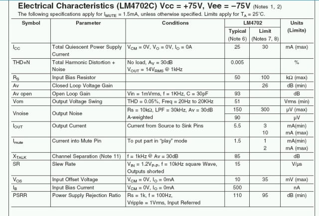

You do not say which chip you use (A,B or C) or your operating voltage, but I am sure National Semiconductors would be pleased that you have improved their THD by two orders of magnitude.
The quoted THD + N is only 0.005% by no means a magical figure at all.

Hi Routhan,
This is a page from their data sheet. I do not see erata anywhere. Besides, this is also with no load. Add a load and see how this value drops on any distrotion analyser.
But I don't quote anything, this is from National. If you look at the graphs a little further, then you also see mpre revealing things not just numbers.
Maybe their appnotes have a different specification. If that is the case I doubt if either are correct. I do not always believe what I read. Put it on test and see if this is really the case after the addition of some other components in a real environment driving non resistive loads at elevated temperatures with ripple on the power supply and noisy non lab environments. The results may be far from perfect.
Anyway as you may notice - FastEddy is suggesting a little project and I am keen regardless if THD is 1% or 1 micro%, if it sound good then this is a starting place.
If after I build one, and I don't like it, it goes to the dustbin and I have learned something. Maybe, I also like it and rave about it.

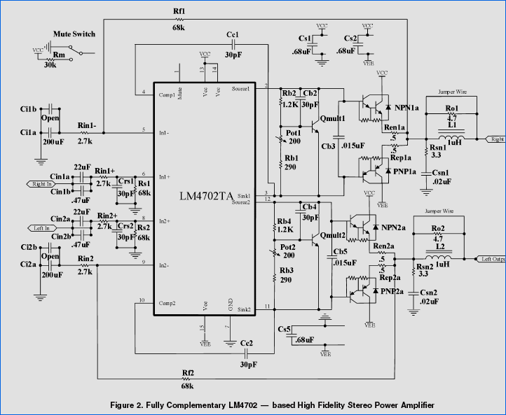

About LM4702 and the Applications of useing it.
hi
A little rave about LM4702 from National mentioned here.
It is a 150/200 Volt output devices driver
for easy make of powerful amplifier.
If it will do for Hifi like they say, may depend on HOW you use it.
There is an application, for download:
Application Note 1490 LM4702 Power Amplifier
See this PDF: http://www.national.com/an/AN/AN-1490.pdf
Here is this AN-1490 Schematic.
Se my attachment.
I say, there has to be many ways to use this chip better!
If only LM4702 has got 50% of the things they say it has,
it might be possible to make quite a good and powerful amp.
And use some better circuit than this app note.
For example replace those Output Darlingtons with some other transistors,
that we, the audio people, more frequently use (read: in 95% of all our designs)
Regards

re that 4702 schematic.
What does Cb2 &Cb4 do (across the Vbe multiplier base to collector)
Any thoughts on why they suggest such high values for the global NFB and input R & C?
Why is Csn1 & 2 set to 20nF (Zobel)?
The rest of the Thiel seems to have been thought about rather than the usual 10r etc.
I agree, dump the integrated Darlingtons and go discrete.

FastEddy said:Lineup: " ... For example replace those Output Darlingtons with some other transistors,
that we, the audio people, more frequently use ..."
I agree.
... I was hoping to find some way to use the LM4702B to drive complimentary pairs of power MOSFETs
( "Complementary Dual Differential Cascoded Topology running in Class AB" )
Such a MOSFET driving use of LM4702 might be very possible.
I can't say for sure, as I haven't studied LM4702 enough.
Reading both datasheet and that application note more closely
may answer some questions.
I have a slight remembering of a topic with LM4702 project
but it may as well be some similar chip they used.
LM4702 is not the only of this type.
And I also do not know anything about which of these type chips
may have the best qualities.
What do they cost?
My hope with my post,
was mainly to inspire some members to try this chip
in a different and maybe more optimal circuit.
This is a good project in Chip Amps forum,
for more flexible and more creative amplifiers
than with LM1875 LM3875 LM3886.
(Nothing bad from me about those - they are all good amps for many people).
Each topic/project needs one or two DRIVING FORCES
to become alive and stay alive to finally give some good result.
Hope one of those of our 'good leaders of projects' would get interested enough
to give LM4702 a good try out.
