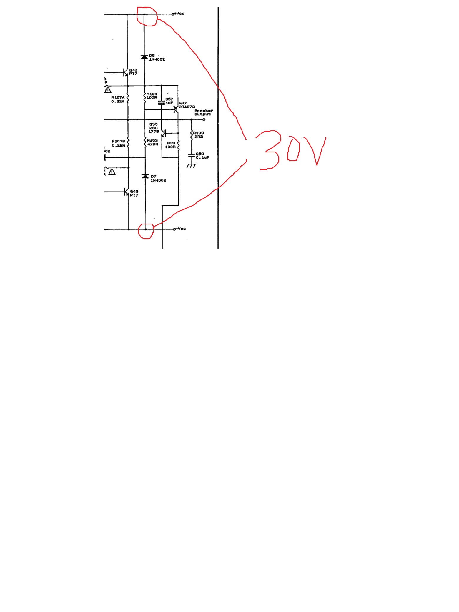

Well it was all going so well until my mate decided to upgrade the old caps! He reported no sound, I managed to check it today but have no idea what its doing. I knew I should have done it myself but it sounded so good I dont blame him
I checked all the polarity of the caps first of all and its all fine. The issue is
no sound
no bias voltage
dc offset rises very quickly
I did some basic checks but was too scared to test further due to dc rising to more than 1v in a matter of seconds. I'm a little annoyed as it was painful enough to fix in the first place and now this. I very briefly looked at the solder job and it also looked ok before I ran out of time and had to leave.
Any suggestions please? I plan to go back soon but honestly no idea whats causing it and dont have time to waste there. I was told there was no smoke or bangs and the fuses was not blown and lights came on when I checked.
Please help!!!

Its a case of back to basics I'm afraid. Always check the supplies are correct first though.
It could be anything but if both channels are the same then it suggests a supply issue.

You will never believe it after 2 hours on the phone turns out a diode was shorted!!!!!
The main diode bridge (4 main diodes) one was faulty!!
LOL what in hell was he doing?
I followed your advice, there was no voltage on one side, so he swapped main caps over quickly and same problem on one side, tracked it back to find one diode was just dead! not shorted just dead!
His victory cry (opposite to war cry) indicates the amp was working again. Its using an old 4 amp diode original I believe is 3, was a risk as we were both scared something might blow up LOL. I advised to replace all to new just in case.
Job done again LOL!! And thanks again!
