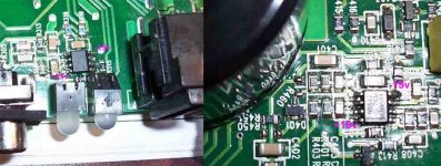

what is this?
and socket u102

I'd recommend ordering replacements for all op-amps, the two regulators (LM337T and LM317T are the part numbers), the capacitor and the 10 ohm resistors. Order extras of each component in case there is a problem that causes the newly replaced components to fail. You won't reconnect the preamp board until you have the main board working properly (as was done on the 7801 repair).
ok my parts arrived from mouser today and i installed both power regulators and the 2 op-amps. i am getting 15 volt at the omp amp but after about 30 seconds i cooked the op-amp again. is it possible to install them upside down? all i did was lined up the letters the same direction from the pieces i pulled out . i am also getting a humming noise from the board that i never had before.
After removing the defective op-amp, confirm that the voltage on pin 4 is approximately negative 15v. Also confirm that the voltage on pin 8 is approximately positive 15v.
If the markings were orientated the same as the other IC, it was likely installed properly. There is a white dot near pin 1 on the board. There is either a dimple or a cutout on the end of the op-amp nearest pin 1.
here is a picture. but my one op-amp starts smoking as soon as i put power to it. is it possible they are defective right from the manufacturer? should i change this out now or look for other problems first?
im still uncertain how to verify oreintation of the chips i cant see the dimple or a cut out

i replaced the 072c that was smoking and i think i must have crewed up the install because it seems to be working now. but now the 2nd op-amp that i replaced is getting hot (595-NE5532D) i am getting +- 15v on the 4 and 8 legs, i cant leave the power to it very long because it gets really hot. its not smoking but im sure it will if i let it be.
i am getting a lot of static or white noise when i hook up a speaker.
i also replaced the 2 large power regulators and i have +-49 volt at either transistor.
i replaced 2 op-amps there is a picture of both on the previous page.
The second op-amp (driving the class D amplifier) may run hot if the amp is in protect but it shouldn't run too hot to touch. If it's getting really hot, it's probably defective also.
You won't get any audio without either the preamp board or the jumpers in place on the connector that goes to the preamp board. The preamp board likely has defective op-amps so you shouldn't plug it in yet.

well i changed out both op amps. and i put resisted power to it and smoked both the op amps. now i need to order some more i only ordered 2 of each. so im out of parts for the time being.
i bought 2 identical broken amps at the same time because i figured it would be easier to learn this way. i have a perfectly fime preamp board i can swap in for the time being.
while im waiting on parts to arrive can i start soldering the preamp board? do i need to replace all 14 legged "074c" on the preamp board? i have 4 of them and one 8 legged 072c (ill have to wait for that one)
If the voltage isn't excessive, there's no reason for the op-amps to fail (particularly the one near the RCA jacks).
