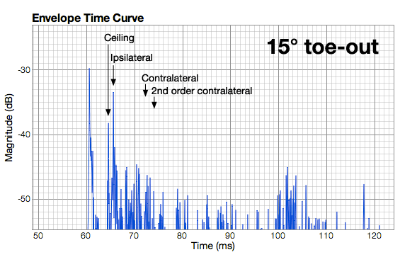

Remeasured my Nathan's with 45° toe-in and 15° toe-out. Here's a little animation of the left speaker:
So in those exampples, the loudspeakers are identical, the room hasn't changed and so if the early reflection pattern does not matter, then the two situations should sound that same. Right?
So do they sound the same?
If they don't then there is more to the problem than just the rooms RT60 and or the loudspeakers polar reponse, since neither of those things changed.
