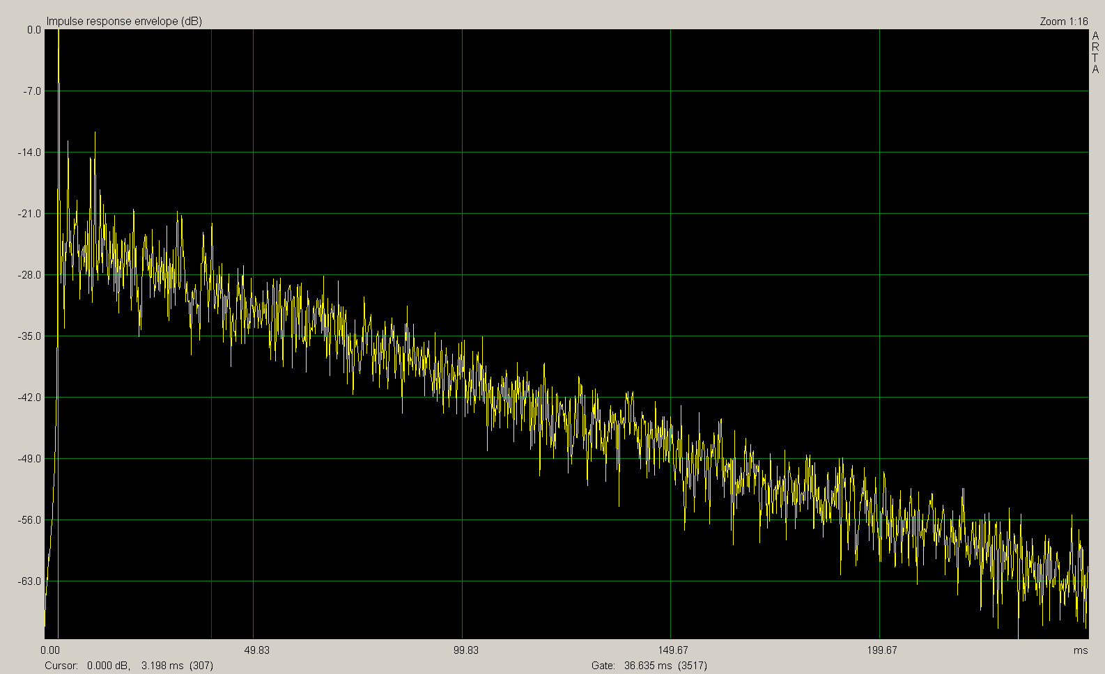

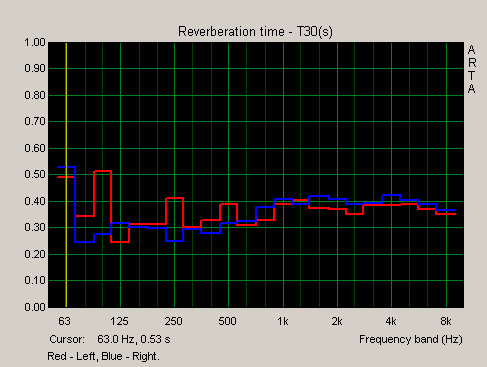

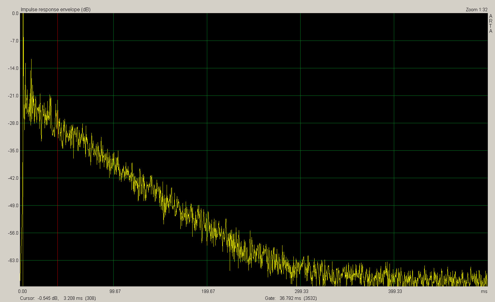

This doesn't make sense to me - how many reflections must a ray go through before it can be considered diffuse ?Two big problems. First is that the sound in a small room does not get difuse until after the T60 is actually gone. So basically the field never meets the assumptions used in defining T60 and its measurement.
Sound travels the same speed in small or large rooms - in the small room a given ray will reflect many more times in its journey in the same time interval than it will in a large room.
So if anything, the reflections in a small room will become diffuse and semi-randomized in their physical orientation and phase in a shorter period of time than a large room.
Does it get diffuse before the RT60 time is up ? Well as I asked, how many reflections do you need ? Imagine a small room like mine 3.45m x 4.8m x 2.4m. Measured RT30 is 0.4 seconds give or take in the midrange/treble, (third image attachment) for a ray to travel along the longest axis of the room takes about 14ms.
So worst case scenario of a reflection primarily along the long axis of the room is that we can still get 20 consecutive reflections into 280ms - well under the RT30 of the room. This is worst case - every other reflection angle will result in many more reflections for the same time period, for example imagine a single ray from the speaker at an angle that first bounces off the floor, then the side-wall, then the ceiling - all of which could happen within 14ms or so, so some radiation directions at odd angles could experience as much as 60 reflections in the same 280ms period, even in an empty shoebox room, let alone one littered with objects that will introduce further diffusion.
As far as I'm concerned, that's plenty of reflections per ray departure angle to become diffuse well under the RT60 time.
I've attached a couple of expanded time and amplitude scale versions of one of the ETC's I presented earlier in the thread - showing a full 70dB range, and 250ms and 500ms respectively. I've highlighted the last individually discernible discrete reflection at around 36ms in red, beyond that all I see even when zooming in is statistical variations, and the overall envelope decline is a perfect straight line from 36ms to nearly 300ms. (Beyond this the fan noise from my computer is setting the noise floor) 90% of the decay time is linear decay without discrete reflections poking their head above the overall reverberation.
I don't see a problem with this as a measure of the decay time of the room, particularly when broken down into different frequency ranges ?
Unstable in what way ? Two identical measurements one after another don't match ? Or two measurements with slight microphone location differences don't match ? Just because the time period is shorter I don't see why the measurement suddenly becomes non-deterministic. I haven't noticed any measurement to measurement variations, and small positional changes of the microphone of a foot or so make almost no difference, providing the mic is sufficiently away from nearby objects. Perhaps if you notice inconsistencies in readings, its the way your software/hardware does the measurements. ARTA uses linear regression to determine the slope of the envelope decay in each frequency band rather than just taking a reading at a specific time delay, which should be fairly resistant to random fluctuations.Second is that it is so short that it becomes statistically unstable - different measurements give different results, its not stable. T60 or T30 have lost their appeal even in large rooms as a meaningful metric. They are even less meaningful in a small room.

Your results look very good, but I suspect that they are the exception rather than the norm. Decays in small rooms are seldom as linear as you are showing.
At any rate, I don't make RT60 measurements and don't really see any reason to, except that they might differentiate my room from a "normal" room, but thats all. There is no "ideal" RT60 in a small room (as there is in a large room), you can never get it very high, so there isn't really a reason to measure it. Just make the small room as reverberant as you can (at HFs) and your done.
And when the reverberation time gets down into the ears integration time? What does that mean?
As I said, my friends who do architectural design seriously discount RT60 for use in anything, and that's in an area where there are no questions about its measurement.

I think that's missing the point though. Just because the direct field and early reflections dominate the sound in a small room, doesn't mean the diffuse field (reverberation) doesn't exist, isn't heard, or can't be measured.Lots. Even the sound field in a concert hall isn't perfectly diffuse (homogeneous and isotropic). This is what Toole writes about RT60:
"In a small listening room we are in a transitional sound field, consisting of the direct sound, several strong early reflections, and a much diminished late reflected sound field. What we hear is dominated by the directional char- acteristics of the loudspeakers and the acoustic behavior of the room boundaries at the locations of the strong early reflections. RT reveals nothing of this. As a measure, it is not incorrect; it is just not useful as an indicator of how reproduced music or films will sound. Nevertheless, ex- cessive reflected sound is undesirable, and an RT mea- surement can tell us that we are “in the ballpark,” but so can our ears, or an acoustically aware visual inspection."
Just because you're not fully in a reverberant field doesn't somehow invalidate measuring the overall decay of the room in terms of RT60, even if the target value of RT60 is quite different than a concert hall. It's still a measure of how quickly energy decays in the room, and an indicator of how well damped the room is for a given room size, and is a directly applicable measurement to make when making overall damping changes in the room.
Depending on how you contrive speaker directivity and where in the room you put diffusion or absorption, you can reduce early reflections without significantly affecting the overall reverberant field and decay time of the room, or contrarily you can keep early reflections relatively the same in level, but significantly reduce the total reverberation time of the room. The two scenarios sound very different, which is why you can't characterise the room only by RT60, but it's still a useful measure for one aspect of the room.
Early reflections can be measured by looking at the early discrete spikes in the ETC curve, as per earlier in this thread, while the overall decay time of the room can be looked at with the RT60, as measured by the linear regression of the envelope decay of each frequency band.
What would cause the decay to be significantly non-linear in a small room ? Large differences in damping in different parts of the room ?Simon
I usually find most "normal" living rooms too reverberant, not the other way around.At any rate, I don't make RT60 measurements and don't really see any reason to, except that they might differentiate my room from a "normal" room, but thats all. There is no "ideal" RT60 in a small room (as there is in a large room), you can never get it very high, so there isn't really a reason to measure it. Just make the small room as reverberant as you can (at HFs) and your done.
This room I find tolerable but still a bit on the too reverberant side. I aim more for around 0.3s.
I don't think there's any danger of that...however if the decay in the room is too slow it certainly impacts on the perception of the envelope of musical passages, particularly those with high crest factors, and it can also mask low level reverberation and details in the recording. This is what I don't like about a room that's too reverberant, I'd rather have a bit drier response that is more revealing of what's actually in the recording. For some reason I also find an overly reverberant room is a lot more unpleasant and difficult to listen to at high volume levels than a room that is better damped. I always enjoy loud classic rock much better in a well damped room for example.And when the reverberation time gets down into the ears integration time? What does that mean?
