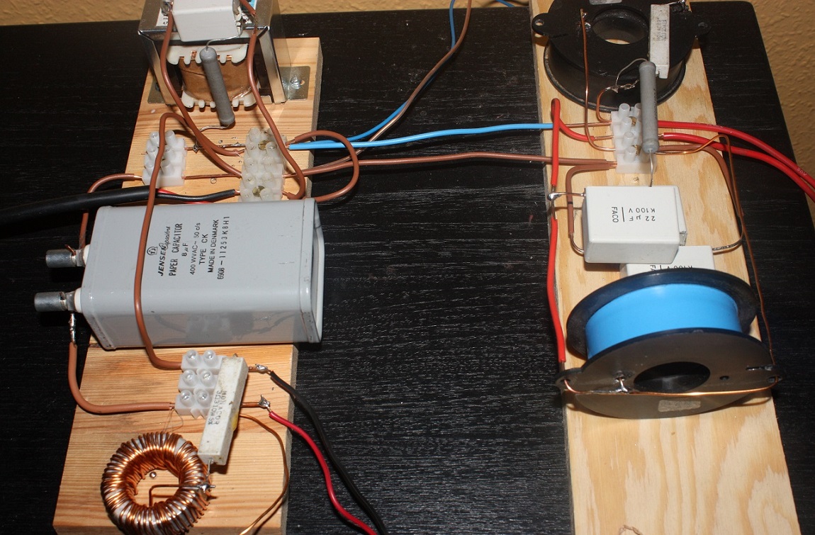

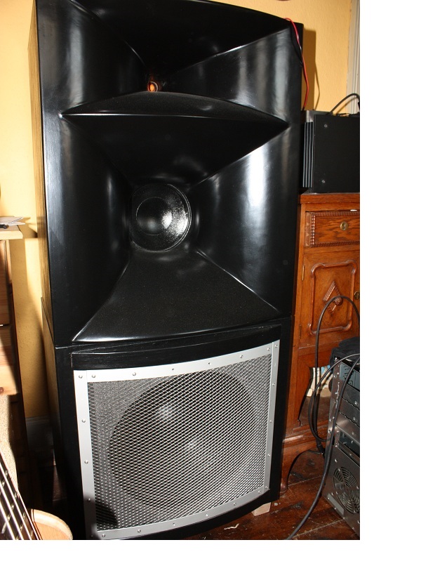

mine is a 3way
resistor is mounted on tweeter, but still have influence on tuning pitch ;)
and you may also know the possible problems with noise
no effects or anything, just 'pitch clean' I think it's called :D
it was built as an experiment to try the different design principles
I was bit over enthusiastic, and the speaker got too heavy to move anywhere
so now I think of it more like a studio allround speaker
funny thing, and far more OT, but the crossover still turned out more less the same way I would have done for music/hifi :scratch2:
but somehow I can't help thinking how much the same things with pitch tuning etc also have influence on how a common hifi speaker reproduces music

funny thing, and far OT, but the crossover still turned out more less the same way I would have done for music/hifi
That's a beautiful speaker!

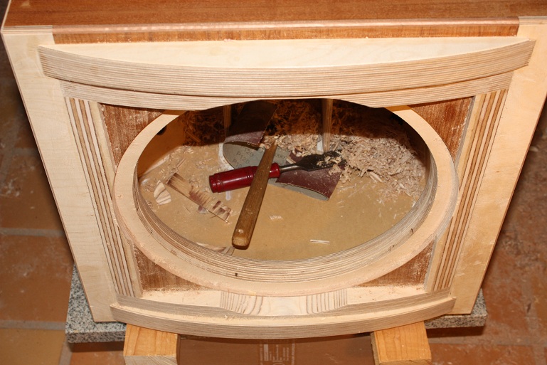

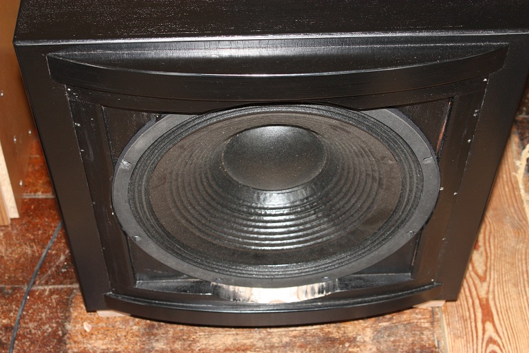

ehh, no not really small woofer box, as such
woofer is selected especially for smallish 79liter VAS (Fs/38hz, Qts/0.33)
and box is closed and calculated for smooth rolloff
very solid, and very clean
