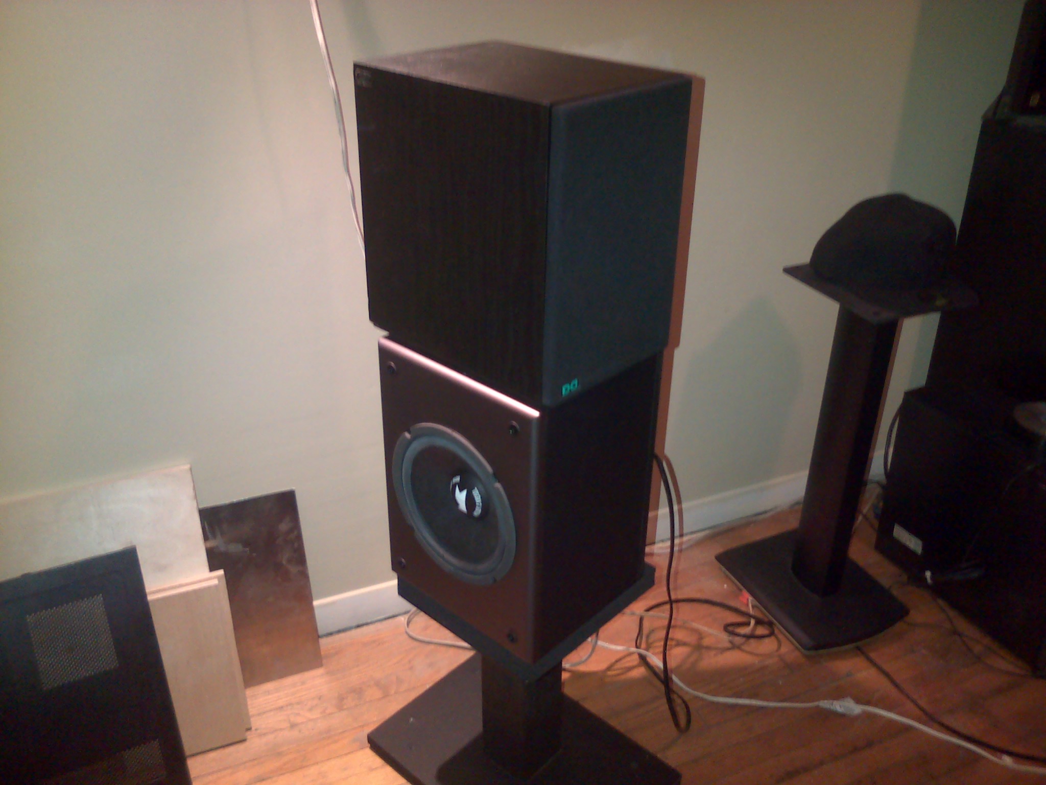

I was never very fond of these minis but do really like some of there qualities. Since I'm modifying my others I have been playing around with them and ended up stacking only to save a little space working on the room. It absolutely made them little 6.5's sound much much bigger opposed to having the sw's on the floor. Not only because of the obvious presence of more bass, it expanded sound stage greatly I was surprised.
One more thing, coaxials sound good and image well usually.Tthis obviously comes from c-c spacing being zero. When crossover is well matched it takes care of front-back time alignment - then there is no phase match problems even off-axis vertically! Speakers that use coaxial mid-tweeters a coming to "real" high end now, done By TAD and KEF, not to forget Genelec monitors.

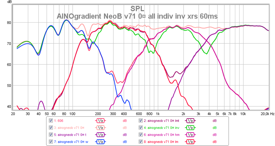

Other thig that I have found/seen with minidsp - LR4 slopes require more precise phase match than LR2 because things happen faster, in a narrower band. This can be one reason for the difficulty of making LR4 sound good.
Here is my present AINOgradient XO graph, acoustic response at 1m little below tweeter axis. 60ms gating to show bass better.

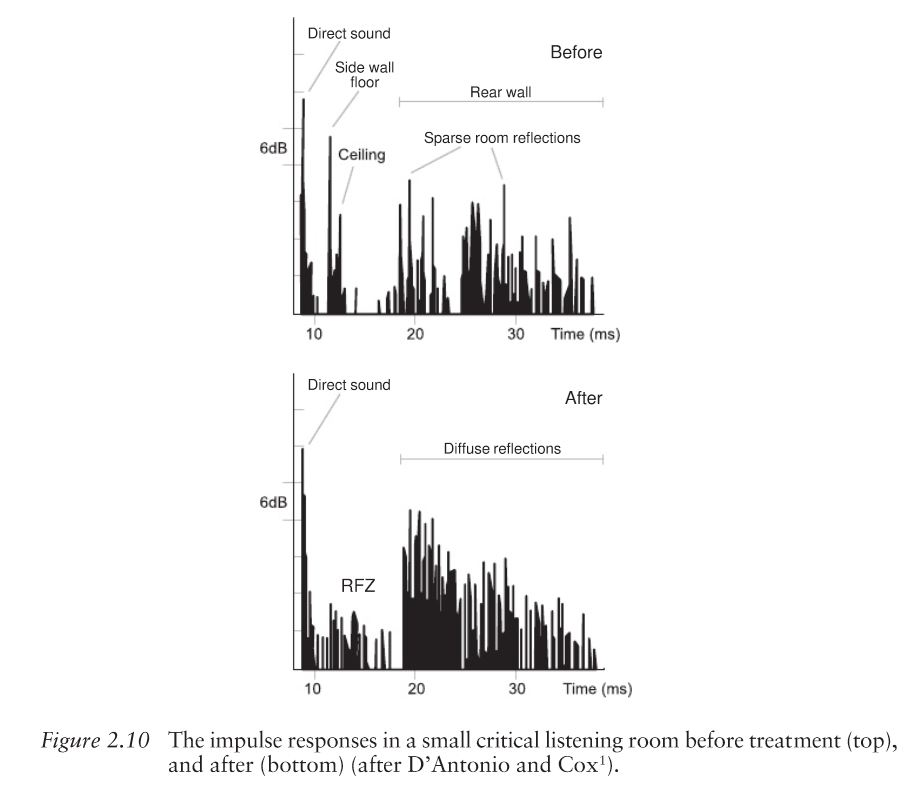

Big sound and relation to speakers seems to have been well covered here.
However, not much has been mentioned about acoustics which also play a vital role.
An ETC that measures like the "After" illustration will yield big sound. There are other means too. Generally speaking, a bigger space will more easily give a spacious soundfield.
