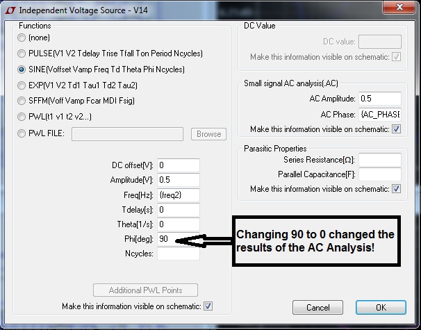

Well that is turning out to be an odd one. The single voltage source that I was using had also been used for time-domain ("transient") simulations, and so it had a sine wave set up, for that, on the left side of the voltage source setup window. But the "AC Analysis" supposedly uses the "AC Amplitude" and "AC Phase" fields on the right side of the box, in the "Small Signal AC Analysis" section, right?!
Well, somehow, changing the phase angle in the transient sine wave field from 90 to 0 caused the output to change, for the AC Analysis! Setting it back to 90 gave the same result as before. (But I think they're both wrong, since the gain ought to be around 41.5 dBv, I think.)
I am investigating. For example, the output level varies wildly as Phi is changed from 0 to 2 degrees. And with and without only an 8 ohm R load it's wildly different. Some change I made must have caused something pathological in my schematic. It's late and I have to go to bed now but I will post the LT-Spice files tomorrow evening.
I was using LT-Spice version 4.19i, dated July 2013. I synced to 4.19u and got no change in that behavior.

Well that is turning out to be an odd one... But I think they're both wrong, since the gain ought to be around 41.5 dBv, I think...

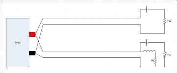

1. Use one amplifier channel to drive a biwire setup and a monowire setup. This removes any possibility that the amplifier voltage output could be a factor in difference.
2. Use resistors for all tweeter and woofer loads. This removes any possibility of driver/enclosure/reflection interaction from the measurement.
3. Using single tone signals, make sure that there is indeed a null in difference between tweeter signals. Stay well above the crossover frequency. Null must be both resistor match and capacitor match. It is important that the system be exactly nulled at the frequencies where the two tone test occurs.
4. Watching the difference signal on a scope, bring up the low frequency content. If there is a difference within the system as a result of the monowiring dissipation difference, it will rear it's ugly head right in front of you as a modulation of the tweeter difference envelope. Actually, it will go from the null to a SAM.
Remember, the difference can be a result of simple amplitude modulation, or more importantly, a difference as a consequence of a phase shift. It will not be possible to discern the difference using one scope channel, and direct zero crossing measurement will not be very easy to control with respect to setup design as a result of parasitics.

Pano:
All you need are two very well matched capacitors, two well matched resistors, one lone inductor and one woofer resistor.
No need to match inductors or woof loads.
I've drawn the relevant items required. Note that for the biwire side, there is no need for a woofer load.
The top is the biwire aspect, tweeter portion only.
The bottom is the monowire.
There will be no difference between the two when the signal is tweeter only. When a LF signal is introduced, it's current will only go to the w load. If you want, you could even use DC.
If you want stronger signal, lower the w load from 8 to .5...
