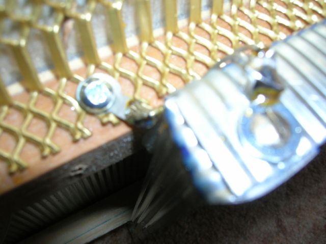

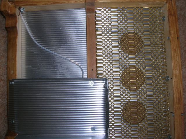

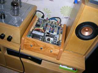

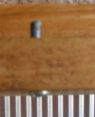

Something like this channel for the heat,
Slight angle and silicone washers.
This also gives me a double skin, taken from the ideas of the exhaust pipes on Japanese motor bikes to stop the blueing on the manifold. They put a double skin inside the pipes and it stopped the chrome going blue. Heat reduction.
The heat should create a chimney effect inside the channel. To be tried!
I have put pins through the top that now engage with the front panel, just me being safety conscious. (nuts recessed into the wood)Its now impossible to remove the top plate without physically breaking it apart unless the two screws are removed from the back.(the top is a slide forward fit).
The fit still looks the same.
Still lots to do.
Regards
M. Gregg
Still lots to do.
Regards
M. Gregg

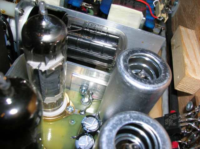

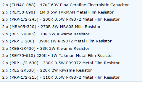

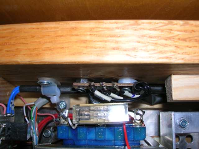

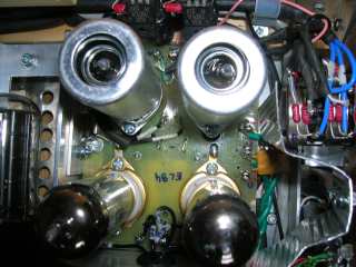

Just some more,
I have moved the caps for the screen supply on the EF86's and added a heat shield to protect the front panel. The caps have been moved quite some distance, the resistor from the B+ supply is still straight on under the board.
So there is only two kimber film caps under the board the rest is resistors BOM is attached for the RH84 with EF86 driver,
Still more to do, the fuses that are temporary mounted on the OP Tx's for each channel for initial power up (200mA QB) just in case. Will be moved and fuse holders mounted on the back panel.
The control doubler is protected by SS fusing off the heater supply. The 5y3 heater supply is protected by SS 4A fuse mounted from a spare valve base connection to the heater connection, same as the 100 ohm anode resistors.
I used Kimber Kap for the coupling, RRR resistors and Kiwame/takman MF 1W for the feedback. The BOM also contains parts for the Cathode standard fixed bias, however I used the 5V reg and 110 ohm RRR resistor with Muse 220uF bypass and 22Vzener combination. These cathode components are mounted behind the EF86 cans for heat protection and easy bias check.
Still more to do, Its been on test for about 3 hours. You have to test it don't you..
Regards
M. Gregg

Something I would add,
The 260G power Tx seems to have a lot of stray flux. On first power up I had some magnetic coupling with the one channel. This was fixed by lifting the OP Tx and power Tx with cork tile off the chassis.
If I was to build again I would make the chassis slightly larger (not a lot) just enough to keep the OP Tx's further into the right hand corner. Its the price of trying to shrink the size..
NB the base plate is aluminium and lifting the Tx's cured it! You would think it would be a problem with steel..anyway's.
I will use the internal ducting for the Rectifier, however the EL84's are biased very hot in this circuit. So some top venting may be required, I'll have to see its running with the top open at the moment so I can get an idea of the temp and heating of components. I am also glad I mounted the 260G on the cork it runs quite warm and I don't want the small chassis base plate heating up. its working well at the moment! Power Tx and chassis are just warm to the touch.

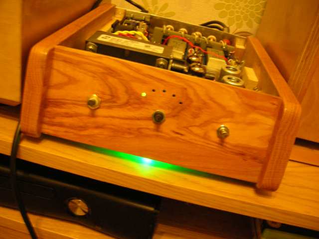

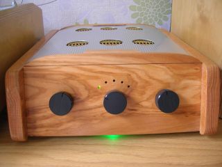

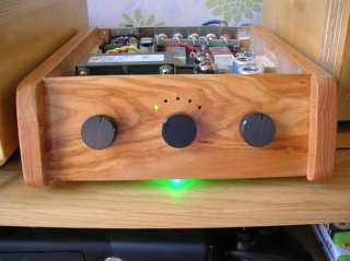

First test in the box,
Some extra venting and earth bonding of mesh to top plate and back plate to earth connection.
The weather is quite warm and its just warm to the touch with constant warm air out of the back and top vents.
WAF is high, she walked though and looked and the Ohhh where are the valves?..there inside..
Still a few things to do..
Its playing the Eurythmics greatest hits at the moment...there must be an Angel playing with my heart...Da, Da, da....
Regards
M. Gregg

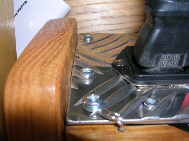

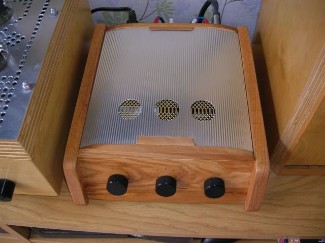

Final instalment,
I have made some more vents in the top plate, after 5 hours of playing the top plate started getting hot. I tried it without the top channel for the rectifier thinking the new vents would sort the heat, and it got to hot to touch in about 1 hour, so the channel went back in. Its just warm now and has been on for about 4.5 hours. Again just lashed in for a test!
Same layout as for the front mesh and additional bonding.
I could have just used a mesh top plate. However it would show all the internals. As it is now I can just see the tubes glowing if I look at the right angle.
So its Van Halen volume 1 at the moment..
The slide forward top and then push down at the back so there are just 2 screws at the back works well.
I'm not a fan of Hammond mains Tx's I am running it at just over half power and it gets quite warm. The heater winding is drawing about 1.5 A and its rated for 5A, The B+ is rated 200mA and running at 100mA, Rec winding is running at about 2A its rated at 3A. The voltage doubler for the control is working well.
I have kept all electrolytic caps above the board so they can be changed easily/or uprated.
Do I like the sound ...yes.
I guess you already know its the RH84 EF86 driving EL84.
You can just see the LED's not selected in a dark room, they look OFF in the daylight.
Regards
M. Gregg

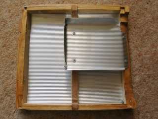

Final update..
Mains transformer mounted on 6mm nuts with vent holes under it.
The Mains Tx runs cooler, and it makes quite a difference to bottom plate heat.
Temp fusing for the B+ now removed and permanent fusing before the first cap after the rectifier fitted to back panel.
..I can't strip it.. don't want to. Its playing now
How can I play it if its in bits..Just another manic Monday..
Might have to have a drink later and think about it!
Humm how much would another set of Tx's be
Regards
M. Gregg

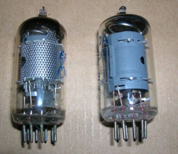

Just thought I would add this,
The EL84 cathode cap seems to make a big difference in the RH84. YMMV.
Silmic II made it sound very dark but interesting...strange because I normally like silmic II
Muse ZX seem to be open and is the favourite at the moment. I'm running 220uF 25V.
so much to do...
