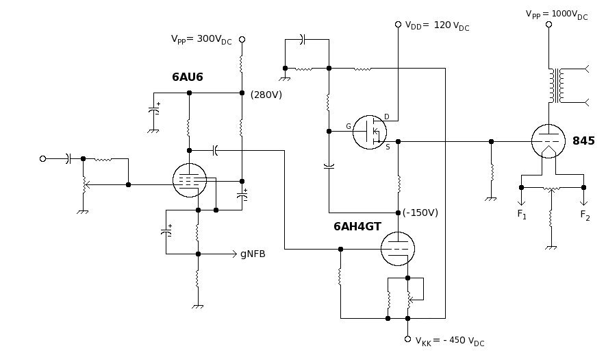

Regarding MOSFETs and nonlinear capacitances:
Cgd is indeed not a constant but it is not extremely nonlinear as long as you don't go into low Vgd conditions - how low, depends on the actual MOSFET but usually most of the problems are avoided by having a minimum Vgd of about 5-10V. In general, the nonlinearity is higher on lower max Vds rated MOSFETs.
As long as low Vgd is avoided, look for the lowest Cgd (reverse transfer capacitance).
For truly low capacitance, a self-cascoded follower can be used. In this design, there is another MOSFET 'on top' of the follower one, and it's gate is referenced to Vgd_minimum + Ggs_threshold over the output of the follower (This usually ends up being about 10-15V minimum). It is fairly easy to do with a high resistance divider from follower output to +V, with the resistor from follower output to cascode MOSFET (the top one) gate bypassed by a good low inductance capacitor. Relevant protection diodes and gate stopper resistors must be applied of course! This arrangement reduces the apparent Cgd of the follower MOSFET about as much as it's apparent Cgs is reduced due to follower operation - in essence, the top MOSFET bootstraps the Cgd of the bottom one, and the bottom MOSFET drives the Cgd of the top one, for which it has plenty of current available.
It is possible to do this with a BJT-MOSFET combo (BJT for bottom, MOSFET for top device) but not truly suitable for A2 operation as the BJT will suddenly require current from the tube driver stage when grid current of the output stage becomes positive. Even though this load is reduced by Beta of the BJT, it is a much more abrupt change than what you get on MOSFETs, even though the input capacitance of such a combo can be made truly miniscule.
Finally, the Cgs of a MOSFET in a follower conenction is usually reduced proportional to it's Gm. For a given MOSFET architecture, Cgs is roughly proportional with Gm, which is again proportional to it's current handling (think of an incerase in Cgs, Gm, Idmax as paralleling MOSFETs). Unfortunately, so is Cgd - which is why, when chosing MOSFETs for follower applications, it is necessary to use the one with the lowest current handling that satisfies your needs (plus safety factor, of course), as this will give you the lowest Cgd.
mosfet power supplies: +-150V is not enought, it should be +150 -300 or more
That is what I used in my amp. +150 and -300 volts. Easy voltages to make from a 120 volt transformer secondary, which is verry common here.

Here is a very preliminary design. This includes little more than basic topology.

Hello Giaime,
please consider to use the Gomes Totem pole with 12AX7, it has a gain of 70 and output impedance of 500 ohm; the V+ is about 480V .
In origin this was used to drive a plate of 211 push pull (double Tomem driven from a input unbal/bal. trasf.).
PLEASE leave the FET; it is a non sense with georgeus 211 (in my opinion).

In every case is not raccomanded to drive in A2 the grid of big power triodes.
With the Gomes circuit you can have a simply but very efficently way to drive the grid of 211.
With 1250 Vdc and -80 v of bias you have about 60 mA of current, with a load of 10k you will reach about 19w (of course if you use a good 211 not a chinese!). The dissipation of ther tube is about 75w. If you stay within this spec, the Gomes circuit works fine.
The main problem is not the grid current (you don't need!) but the quality of output trasf. It MUST be at the highest level otherwise you can design the best circuit in the world since the Roman empire but the sonic results (mainly in the low frequencies) wil be poor. This means that it is expensive; I worked on some of different circuit and the problem is always the same.

Giaime said:Why this bashing of A2 operation? What kind of problems?
I've heard rumours that grid circuit nonlinearities can compromise sonic quality. I suppose that can happen if your driver has too high Zo. Sounds like a good interstage xfmr or a MOSFET source follower will fix it. I like to use strong drivers that can charge up the input/stray capacitance and improve clipping behaviour on transients anyway.
Other than that, it's an audiophile rumour. Who knows?
Maybe this person never built (or heard) a GOOD A2 amp. I realize that it is real easy to build a bad A2 amp. And to build a good one you need an expensive IT transformer, or a FET. Most cathode followers will be asymetrical, and sound bad. Many poorly designed A2 amplifiers do not sound good. Some tubes like the 811A REQUIRE A2 operation unless operated at very high plate voltages. There have been several nice sounding 811A amplifiers built.
Yes about 19 watts is what you get from a 211 in A1. It is relatively easy to get 30 watts or more in A2 without violating the specs. If you don't turn up the volume, you never enter A2, but you have more headroom for transients. You can have clipped transients, or loud ones that MAY have some A2 coloration on them.
And by the way I have seen over 40 watts at 5% distortion using Chinese 211's. I certainly am not going to test NOS ones (I only have 2) at this power level.
Those are just my opinions. I have built several A2 amps. All of my DHT designs have A2 capability. It is useful on many tubes (including Chinese 300B's). Even if the tube goes non linear in the grid current region the resulting distortion is less objectional than clipping.

I agree that for any tube amplifier, especially a SE amplifier, that the single most important component is the output transformer. In my case I got the OPT's from a person that took a lot of peoples money and gave them NOTHING. The fact that I got anything from him is unusual, the fact that they are good transformers is really unusual. These transformers weigh over 10Kg each. I ran a frequency response test at 10 watts and got 22 Hz to 33KHz. I am sure that they are not capable of full power at 20Hz but the entire amplifier was built for about $400USD.
I got the transformers first, then started to design the best amplifier that I could around them that fit my budget. I do that with a lot of my designs. I started out to build the "Poor Man's Ongaku" form an article in an old Sound Practices magazine. I was not impressed with the sound that I got from my version of that circuit, so I started changing things. The amp that is on my 845SE web page is the result. It bears no resemblance to the original Ongaku design. I also wanted to use 845's (which can be operated in A2) and 838's (which MUST be operated in A2) because I had some NOS tubes.
True the 211 is not specified for A2 operation. A2 was not common in the 1930's when the original data sheet was written. The RCA data sheet that I have (dated 1936) does list class B modulator service with a plate dissipation of 100 watts. In later books 100 watts was listed for all classes of operation. The data listed for class B operation (1250 plate voltage case) shows a bias voltage of -100 volts, but a peak AF drive voltage of 205 volts (1/2 of 410) this is 105 volts positive on the grid. It also shows a drive POWER of 4 watts (1/2 of 8) dissipated in the GRID. Even in 1936 they were driving the grid positive. Look at the plate curves, they only go to - 125 volts, but show positive values to +225 volts. Plot a load line for a reasonable load (5 to 10 K) and you will see that the curves remain linear well into the positive grid region.
I am not stating that everyone should consider A2 operation. It does require careful design. I am saying that it should not be automatically discounted because it is difficult and uncommon. This started as an exercise in "theoretical" design. It is good engineering practice to consider all possible design solutions, then narrow down the choices based on the given constraints. The common constraints are budget, size, power dissipation, etc. We have all presented our opinions, but it is up to the designer to choose his particular design path.
I built this 845SE amplifier, I also built a push - pull 300B amplifier, and several other smaller SE amplifiers. They are all placed in a rack so that I can use any one of them. The 845SE does not get used as much as the others due to the amount of heat it generates. In the summer here the outside temperature reaches 36 degrees C most days. Even with air conditioning I can run that amp for about 1 hour before it gets too hot in here. It is also quite large. I usually listen to one of the small SE amps. When I want to get loud I will turn on the 300B P-P or the 845SE depending upon my music choices.

tubelab.com said:Been here built that! Look at the 845SE on my web page.
http://www.tubelab.com/845SE.htm
Look at the second schematic on that page.
I started out building an Ongaku clone, and after several itterations wound up with the amp that you see on that page. The power supply makes a BIG difference in the sound. I have done two power supply designs, and I am still not happy with it. I have a power supply from an old Motorola police radio base station that puts out 1500 volts at 1/2 AMP! It gives the best sound, but weighs 120 pounds and the transformer buzzes loudly.
I use mofet drive. I wanted to be able to drive 211's and 845's interchangeably which requires at least 200 volts peak to peak! I have since used this circuit to drive an 833A, which can draw grid current of over 100mA. You can't get this from a single stage. Even if you could, I don't think that an ECC83 has the slew rate capabilities to swing near this much voltage at say 50 KHz. For that you need current. I think you might get there with the 12AT7 at about 10 mA (or both sides in parallel at 20mA). I have been using them (CCS loaded) in my latest amps because 5842's have become scarce and expensive.
I have called the CCS, mosfet drive combination PowerDrive. I spent a couple of months experimenting with this when I first figured it out. I thought about the large capacitances associated with power mosfets (gate - source and reverse transfer) and didn't think that they apply in a source follower. There is however a significant gate to drain capacitance. This is not always specified. I work in a building full of CMOS IC designers, so I picked a few brains. I was told that this capacitance is not constant, and depends on the "channel depth" and "channel width". These are big words that are related to the voltage and current across the device. OK, you just can't look this up on a data sheet, it depends on the application. So, I ordered a bunch of high voltage mosfets and set up a test fixture. I drove them with a CCS loaded 5842 and measured the frequency response. I wasn't smart enough to document everything, but I did find that the Toshiba 2SK2700 has no problem hitting 500KHz at 100 volts P-P. I use this one in all PowerDrive designs. It can take 900 volts.
Just a suggestion, but use 1/2 of a 12AT7 CCS loaded for the first stage. A low Mu triode or triode connected pentode that can handle a plate voltage of 500 volts. I would try a 6BL7, 6BX7, or a triode wired EL-34. Use a CCS load and mosfet followers between each stage. In other words copy my design without the expensive tubes. It works with 211's AND 845's only by adjusting the bias.
Hi TubeLab,
I read your Powerdrive design with great interests. I want to build a single-ended power amplifier using 805. I want to use your Powerdrive to drive the 805 to A2. Will it be feasible and sounding good? If yes, when will your Powerdrive be available for sale?
I want to try the IXYS 10M45 CCS chips that you recommend for plate load on these forums and I will buy some from the Digikey. Can the chips be used to replace the cathode resistor of a self-biased cathode follower (e.g. 6EM7) easily? If yes, can you elaborate?
Thanks.
