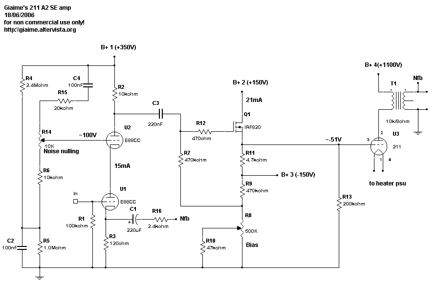

Updated design. What do you think?
Please note noise cancellation tecniques Yes I've studied a lot on Broskie's articles.
And a theory question: when calculating the resistor needed for a given feedback ratio, in the voltage divider formed by the resistor and the cathode resistor of the input tube, do I have to count the cathode resistor alone or I have to consider the total impedance seen at the cathode (formed by Rk || rk)? In that case, R16 should be halved...
And also, is there a better way to inject feedback in a cascode circuit than this?

In regards to the Rk || rk question it depends on how big one is relative to the other, if the overall feedback node impedance is significantly lower than R3 by itself (and here I believe it is) then the value of R16 should be adjusted. This probably most easily accomplished at the testing phase of things as the internal cathode resistance is probably pretty small, and not precisely known.
Also you don't really need or want C1 in the feedback path, the values of R3 || R16 can be tweaked to give you the bias voltage you want on the cathode of the 12AT7. I suspect that C1 will introduce quite a lot of low frequency phase shift and also result in boosted response in the subsonic region where your transformer can't handle it, this is probably not an issue unless you play records.

Thank you very much Kevin for your reply.
But... rk isn't (Ra+ra)/(mu+1)? This leads to about 100ohm if I am not wrong, pratically halving the impedance seen at the cathode node.
You're right about C1. But how to mantain the bypassing of rk of the cascode (I must do this or the gain will be too low) and accept negative feedback?
Maybe the upper triode's grid could be a place to put error signal? However there the gain will be quite low, but maybe it will be enought.

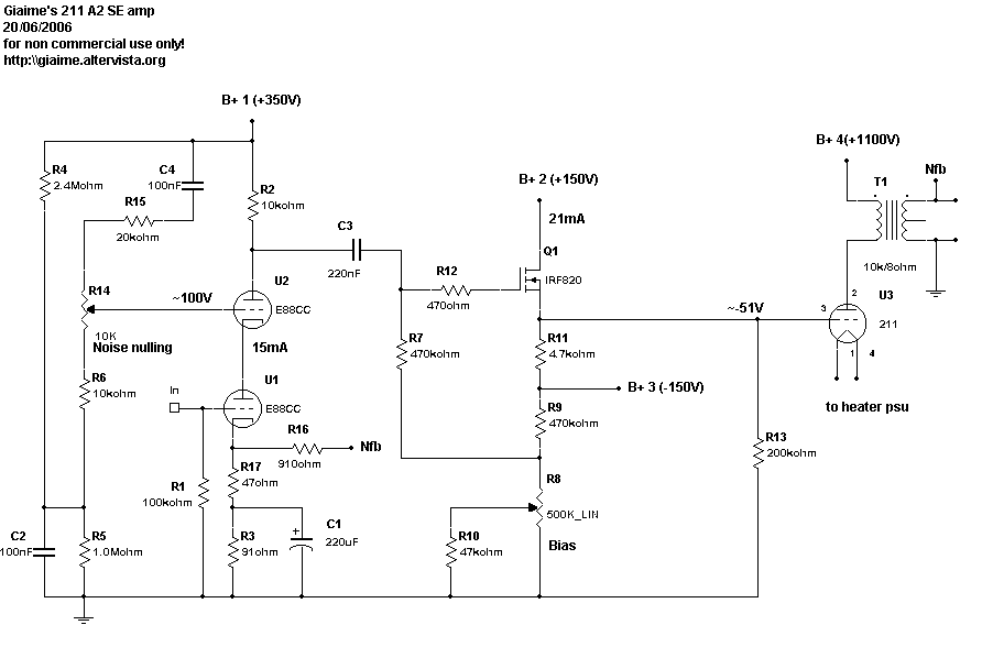

Put a small unbypassed resistor in series with a larger, bypassed resistor, then inject the feedback across the small resistor.
Now I did it, and I'll be extremely grateful to you if you continue your priceless suggestions on the forum

Thank you very much George and Kevin, your help is much appreciated.
I'm not sure I understood the nfb connection you suggest. Is this correct?
I also have verified the difference between 1/B and ACL, as Kevin said, and I have to underline that this difference is negligible (0.005%) not only when A is very large, but when the feedback factor is low, so A*B is very large, and 1/AB tends to zero. In fact here I'm using -6dB of feedback only, giving an input sensitivity of 1.72Vrms for a power output of 40W on 8ohm (that I consider the extreme maximum).
Note that I have adjusted the cathode resistor of the first stage, because now rk is in parallel with the feedback resistor (and the OPT secondary, which is negligible) and so to mantain the same value it has to be increased (from 120 to 138ohm).
I have still doubts about the decreased open loop gain due to a portion of rk unbypassed. But: if there's a feedback signal there, won't the 47ohm resistor be effectively bypassed (AC ground)?
Also, but I think those things are meant to be tweaked in the real world, not on paper, we have still to consider the total impedance seen at the cathode of the cascode circuit. If I'm right and I remember well what Broskie said about cascode, the impedance seen at the anode of the lower tube is Ra/(mu+1), so about 300ohm. This, divided another time for (mu+1), gives about 8ohm at the lower triode's cathode. Is this effectively in parallel with Rk?

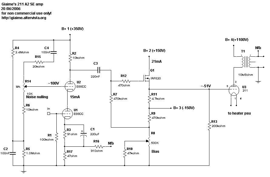

That is what I had in mind, except that I usually swap the positions of R17 and the R3 - C1 pair. This way the small amount of AC current that flows from the output through R16, R17 and C1 will not go through C1. With the current phobia about putting electrolytics in the cathode circuit of a voltage amplifier, why stress the capacitor any further?
I think tubelab is right on this one, there will be much less signal current flowing through that cap with his suggested orientation, and regardless of where you locate it is still part of the feedback network.
Another reason to do it the other way is it makes altering the operating point of that amplifier stage very easy as you can basically change the cathode resistor with no interaction with the rfb resistor.
Good low voltage blackgates are still available and are very good. I'm not a big fan of EL types either. In some cases though the circuit performance will be a lot better with them than without. Your other option is to use fixed bias on the grid of the lower tube and connect it directly to the feedback network or ground if global nfb is not used.
In theory at least the impedance at the feedback node will be small but not zero due to the limited loop gain, it may be that reducing the value of the 47 ohm resistor and scaling rfb may give you a little additional loop gain although I doubt it will make a significant difference, it might still be worth trying.
Like Tubelab I eschew the use of global negative feedback and I suspect substituting a lower mu driver tube or using an 845 (which many seem to prefer incidentally) would eliminate the need for nfb.
I tried varying amounts of nfb in my early se designs as well as an otl and pp amplifiers, and invariably came to the conclusion that the amplifier in question (even the OTL) sounded best with no feedback.
Should you need a lower source impedance I recommend you trade power output by choosing an operating point optimized for a higher primary Z - in many cases this will help dynamic linearity as well, while giving you a lower source impedance/higher damping factor.

Thank you very much Kevin. In fact, I designed the input stage to accept 845 output tubes: a little tweak on bias, mosfet power supplies and OPT primary impedance can allow the 845 to be used, of course one must eliminate global NFB.
I'm very sad that this design will remain on paper for looooooong time
Edit: an updated version of the schematic online soon on my site, at the usual address. I'm working on an 845 variant.

Ps. updated schematic of the 211 beast online.
The deepest listening test I've done on NFB on tube amps... is like your tests George, hooking a guitar to the amp and a speaker combo
I did this for the EL36 PP amp I'm working on. I liked it very much when cleanly driven hard by a guitar preamp, It's extremely loud even now that has no more than 5W. Obviously, I liked it better without feedback, even if I'm using only 4dB or so.
I have yet to audition it with music and hi-fi rig.
