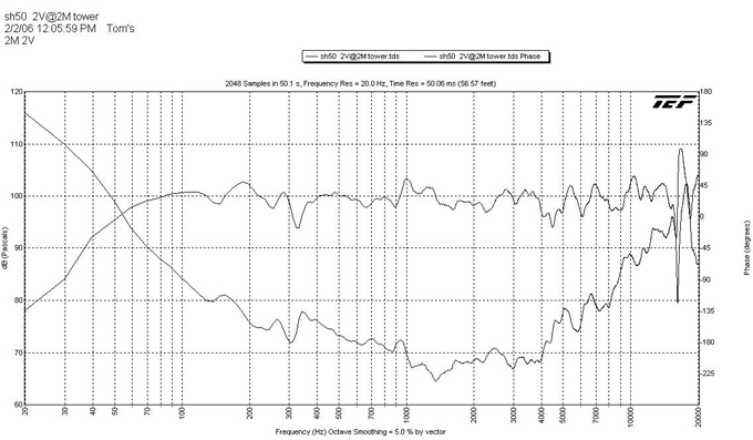

As if dealing with how drivers add or cancel spatially, the next problem is the two fold issue that the drivers are not simple resistive loads and in a horn system, each range has it’s own magnitude and phase response before adding filtering and one has to equalize the response in addition to providing a crossover. Here, in addition to the crossover part, one usually has to add 3 parts (R,L,C) to address a single bump.
Clearly, the only way to design crossovers like this is using measurements and a computer program, there is no way to design a proper crossover for real drivers even in a simple cabinet by look up tables and tweaking as was the practice in the old days.
Attached is a measurement for a 3 way full range horn I was working on some years ago. This was an SH-50 synergy horn measured on a tower about 25 feet off the ground with the mic at two meters using a TEF-20 at 1/20th octave smoothing. The crossover frequencies are around 250Hz and 1200Hz. The phase rise in the upper part is due to where the TEF places “time =0” which here is about 5/16 inch late relative to actual, otherwise, it looks like one driver instead of 7. It is a 3 way system and can reproduce a square wave from fair to very good looking on an oscilloscope, from about 260Hz to about 2900Hz and has no nulls or outside lobes in it’s pattern.
For what we do, the concern about having everything add up into one source is because for large spaces one needs a lot of acoustic power, for that one needs a lot of drivers. The down side of “a lot of drivers” is those systems usually radiate a complex interference pattern such that if the wind blows even a small amount or if you move around, there are audible changes. Also the large interference arrays that are so popular now, produce a difference spectrum at every seat and distance. With a constant directivity point source like this, the sound spectrum is the same essentially everywhere in the pattern and only gets quieter with distance.
It is hard to describe how large a difference reducing or eliminating the self interference makes in large scale sound but it really is large. We have been selling a lot of speakers for stadium sound upgrades.
If you have headphones hooked up to your computer, try this video Mike from the shop took at a stadium demo Tuesday. Listen to the sound as he walks around and keep in mind, this is all coming from the three speakers (one aimed right, one left and one forward) are the little black blob under the scoreboard.
Danley Sound Labs, Inc.'s Videos | Facebook
That system is active as the power levels add an entirely new layer of issues to passive crossover design, active is so much easier.
Best,
Tom Danley.
