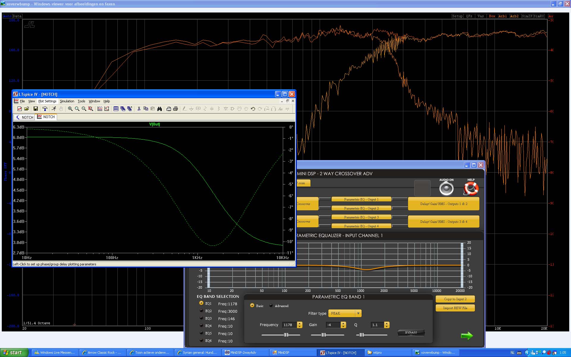

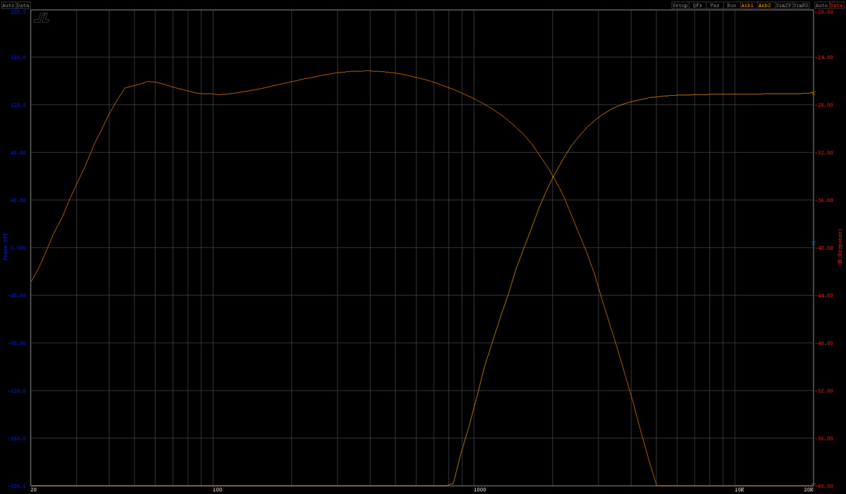

On AlanB's post, I'd like to share the approach I have been taking for a while.
The first step is to measure the drivers in their enclosure, and to fine tune with MiniDSP the curves that work best to get the desired combined response. Next step is to translate this into an analog xover that mimicks these curves. The top screen shows a simulation of one leg of the analog filter in LTSpice. The final step is to build the filter and measure it's behaviour.
This is what came out at the end of the process.
Now, why not stop after the DSP-stage? Some reasons for this (but it is highly dependent on the end use):
- I like to see the amplification including the xover as close as possible to the drivers. With DSP, you get gain structure issues, which you don't have with analog.
- analog sounds better to me (although not by a wide margin).
- analog is way cheaper, even using high quality components, than DSP.
