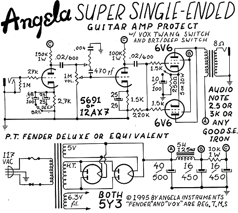

Thank you for replying... SSE can mean stereo single ended but what about super single ended by Angela... I will post a schematic. Thanks for minding and correcting me.

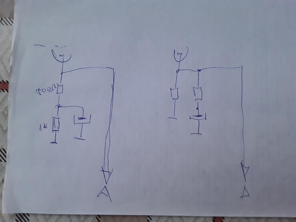

Thanks for minding that one... Yeah i did not notice the negative feedback is not connected properly, that is because I was in a rush and i draw what came to mind pretty quickly (pretty wrong from my point), I will post a new schematic of feedback. View attachment 622764
Still wrong.
Thanks for the clarification. Just to let you know, the moderators will likely move this thread over to the Instruments and Amps forum where I see you've also posted. Unlike some boards (like Audio Asylum and Audio Karma) they like to keep tube stereo and instrument amps separate on here. Most people on this forum are probably not familiar with the Angela schematic. I don't think I've ever seen it discussed on a guitar amp forum either, actually, so I guess it's not real common.
If all you have is SE output transformers and want more power it is an alternative approach if your OTs have the right primary impedance for the tubes you're using. A more common approach would be to use a different tube that puts out more power rather than running a pair in parallel.

As was pointed out above, the EL86 only needs 200v on the plate so if you are using that tube you don't really need a power transformer that can put out 270-285v as you mentioned in your other thread. That would seem to be a good thing since maybe you can use a PT you already have. I know guitar amps often run tubes pretty hard but you can adjust the cathode resistor to vary the plate dissipation if necessary. Although, if your budget is limited you might not want to run them so hard that their life is limited.
Also, if you run them in parallel, the correct OT primary impedance would be 1.25k. Do you have an OT with that spec? It seems pretty low and not a common value, in my experience.
You might consider building a simpler, standard SE amp, not PSE (parallel single-ended) and just use a more efficient speaker. Remember, doubling the wattage of the amp only increases the speaker output by 3db, which is perceived as just slightly louder. You can arrive at the same perceived volume by just using a speaker that's 3db more efficient.

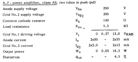

Incidentally, the datasheet (snippet attached) has a section on push-pull operation, and recommends 250V B+ and a 5.5k output transformer primary impedance, for 18.5 watts output @4.5% distortion (that's still "clean" to us guitarists).

According to the G.E. datasheet http://www.mif.pg.gda.pl/homepages/frank/sheets/093/6/6CW5.pdf 25 watts @ 1 % THD are obtainable from a pair of 6CW5/EL86's.

Well, that's what the G.E. datasheet says at page 2, Push-Pull Class AB1 Amplifier, Values For Two Tubes. Do you really call biasing a tube with a plate dissipation rating of 12 W at 11,4 W cold?
*IMHO* it is most important for 6CW5/15CW5 tubes to keep the 200 V screen voltage limit. As the Hohner example proves, overrating plate voltage won't do too much harm.
