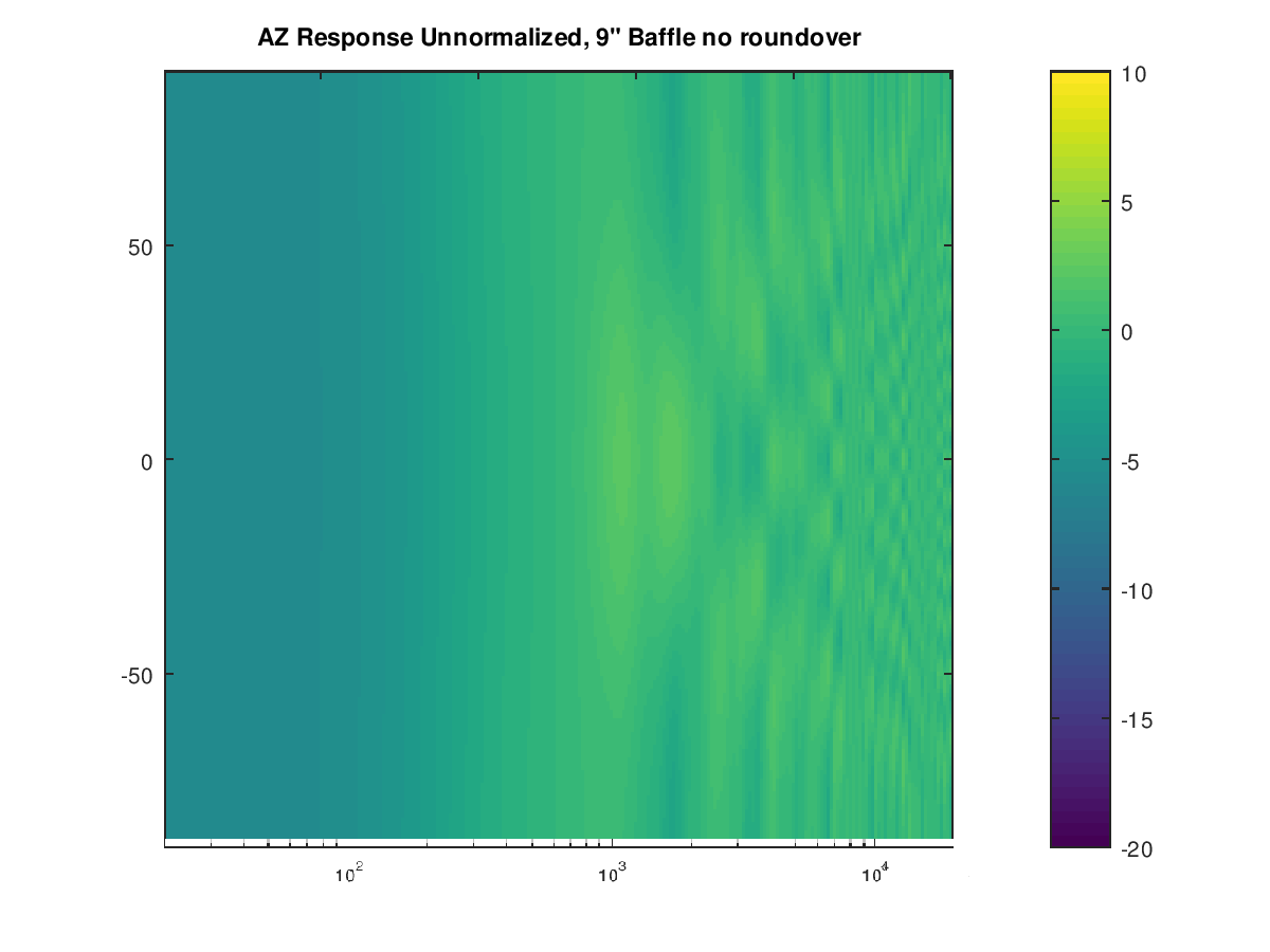

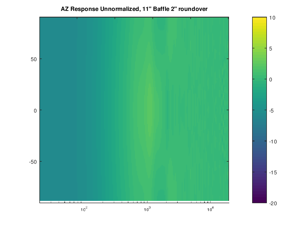

I'm fairly well convinced that I prefer a wide horizontal dispersion, and a narrow vertical dispersion. The lateral reflections give us the sense of being in a space, but without masking the details of the direct sound nearly as much as vertical reflections do.
As such, baffle edge diffraction is concerning to me. I've come down with a cold, so I can't spend time in my cold garage building things, but I will share the simulations I ran, and give a bit of analysis.
I have simulated a point source driver on the center line of 2 different baffles. One is 9 inches wide, with no roundover. The other has a total width of 11 inches, but uses a 2" roundover on each side (so the flat front part is only 7" wide).
You can easily see the interference pattern at high frequencies caused by the harsh edges, which is greatly reduced by the roundovers. The roundovers lead to much more consistency in space, which makes equalization of the remaining baffle edge effects almost universally good regardless of the position. In contrast, equalizing for the on-axis response without roundovers can exacerbate issues off-axis.
The interference pattern exists above the baffle step, but not below. Therefore narrower baffles (with baffle steps at higher frequencies) have more consistency between on-axis and off-axis response across a wider frequency range than wider baffles.
If there are errors in this simulation, I apologize in advance... it's new to me.
