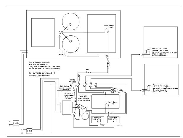

Cortez said:Hi Mike !
ISo I think the conventional layout, what Mike wanted to improve
is when there are only the wires #1 and #2, because then noise
currents would create voltage on the resistance of wire #2.
And what Mike is using: #3 to route everything, noise and interference
from the interconnect cable's ground wire to our main GND reference
point with a low impedance path, and to the PCB we are using wire #1 (wire #2 isnt there).
Am I right ?

AndrewT said:Hi,
what if two or more pieces of interconnected audio equipment have the safety ground used as the main/only audio ground?
I think you end up doing the trick of having interconnects with the shield only connected at one end. WFM once.
More general info on grounding in Rane's AN110.
Only internally, all of the connections between system components are normal interconnects.
I pu together an drawing to answer the earlier question about the safety grounds.
Mike.
I guess your design has 2 specialites, so lets separate them:
1) Using flat cables, improves high frequency behaviour based on the skin effect.
>>>Yes, It creates a low noise reference/return loop for the input stage.
2) grounding the input directly from the RCA to the main GND
>>>This very effectively bypasses high frequency noise around the sensitive signal path.
There is 3 GND points on this model:
>>> Yes I would call them return loops:
Am I right ?
>>>Correct.
AndrewT said:Hi Mikeb,
Is the first statement true?
What are the consequences of the first and second?
Can we have your answer?
>>> Yes the first statement is true. Technically there should be no signals routed through the safety ground, but then RF noise choses it's owen path of least resistance. My layout attempts to remove any path through the signal returns.
>>>As for the second, (hopefully my system layout picture was readable. I tried using my schematic entry program and I wasn't sure how it ended up in the post) If multiple safety grounds are used they need to be plugged into the same power. There is no loop back through the circuitry and little chance for a noise voltage to be developed by this connection.
>>>The biggest problem will be the voltages induced in the chassis by the amp and preamp transformers seeing this connection as a loop.. This I have always minimised through hooking up the transformers to minimize any AC voltage between the amp and preamp with no cables connected between them.
Mike

Mike:
> I wanted to point out that there is no wire # 1
So then your design has just wire #2 and #3 ?
Cause later you said my post is correct with #1 + #3.
Wich one is actually your layout then ?
> this approach works if you think about where noise
> being picked up on the interconnecting cables and where
> the noise circulating between component supplies can go
So, in your design the point is: everything from the input ground goes
directly to the main ground, so it is not going through the PCB, right ?
Otherwise your chassis is connected to the safety earth ?

>>>Cortez,
The posts are (i'm) getting confused between my original post and the concept that the images I sent conveyed.
I interperted your reply to be discussing the 1-3 return I originally posted, not the version I'm using with 1 missing in the images I posted. This is my mistake.
Confusing this as well are the posts by ! (?) talking about power supplies rejecting high frequencies by design... (Ground is a whole other world.)
My focus and comments have all been related to grounding and the path for both noise and return currents back to the common reference point in the power supply. By doing this the noise floor is lowered and the susceptability to noise (RF - hum) pickup is reduced.
I guess that, because it all makes sense to me, I'm leaving out pieces of the discussion that would help to clarify my meaning here. Or, the common understanding of grounding is making this all not fit. Who knows?
I'll re-do the layout so it's readable and we can see where this goes from there.
As you can figure, I'm a newbie to this stuff.
And Yes, the chassis and the circuit ground can be connected to the safety ground without any sonic penalties...
Mike.

Mike:
Ok, so there was 2 different layout discussed here.
So lets clear it now, your suggested latest design is when
wires #2 and #3 are used only, right ?
Otherwise with a layout like this the signal ground can go back to
the source only through our PS, right ? Isnt that a possible problem ?
But in that case when an other device has also an earthed GND,
the signal ground wires could transmit earth currents too, couldnt they ?

Hi Mikeb,
Plug two pieces of equipment into the same dual outlet mains socket each with their own safety ground used as the only multi-purpose ground as you have described ( I cannot read your diagram). Interconnect them with a conventional audio coax using the RCA ground at each end to the chassis ground and it is almost guaranteed to generate hum. This is completely at odds with your statement
I have a feeling you have experimented with your multi-purpose safety ground on the power amp and reached a preliminary conclusion that the idea of this simple grounding can be applied to all equipment without realising that all your other connected equipment was properly earthed and grounded using separated safety and audio grounds. The correct wiring of the other equipment saved your mis-wired amp from showing the symptoms you have managed to hide.
Please come back and confirm how you have achieved your magic.
I cannot believe this, it is misleading, no, I will go further, it is completely wrong......If multiple safety grounds are used they need to be plugged into the same power. There is no loop back through the circuitry .....
>>> This has been my point from the start. If the noise voltage created by the loop does not circulate through the gain stages, and the ground is a low impedance, clean ground, there is no hum.
>>>The problems are usually created poor grounding starting at the transformer. What I proposed was a means to control both the return paths and the effectiveness of the ground net.
>>>The definition of ground, as I interpert it is, an unvarying reference for the supplies and hence the circuitry. One should be able to sink or source any amount of electrons from ground and not upset it's basic charge, which relative to the rails should be zero (at all frequencies of interest). In the real world one can only achieve degree of success in this. When this does not happen the ground becomes another input into your circuit.
Which is why I attempt to control the return paths as well.
>>> This is an interesting set of comments. I've spent 30 years experimenting with what I call the circuit environment. The first 15 in audio, the second in semiconductor manufacturing. Specifically investigating: power supplies, grounding and layout. Professionally, I develop process monitoring applications where my circuits need to function flawlessly in the presence of strong RF fields. I'm still employed and not starving.
>>>My involvement in this thread was purely with the intent to throw a concept out there and a suggested implementation. Hopefully to discuss the finer points of implementation and get feedback based on results. I thought the chip amp approach would minimize the number of internal circuit related layout problems. So far the response has been it can't work.
>>>I've been trying. Obviously it's magic.
Hi Mikeb,
glad to hear from you.
Any chance you could re-post a legible version of your grounding scheme so we can see if it is magic or just a clever way to connect the grounds?
ps that's a difficult read, mixing quotes with new postings. You're getting as bad as Beppe before he realised there was a better way.
Thanks for asking about re-posting the layout. I have to redraw it so I needed a little incentive to feel that I wasn't just ******* in the wind.
It'll be posted sometime tomorrow. Mike.
Hi Mike !
Obviously you didnt noticed my Q to you while I was OFFing, sorry!
So there was 2 different layout from you, discussed here.
Let's clear it now, your suggested latest design is
when wires #2 and #3 are used only withou #1, right ?
http://www.diyaudio.com/forums/attachment.php?s=&postid=900011&stamp=1145856645
But with a layout like this, the signal ground can go back to the source (RCA)
only through our PS (through wire #2) and after that on the noisy wire #3, right ?
Isn't that a possible problem ?
Or #3 and #1 withour #2 is also a good way of grounding right on this base ?
Because then we would have the low impedance grounding (#3) far from the PCB but we also
have a direct, separate, "clean" wire from the PCB to the source (RCA) ground (#1).
But in that case when both device is earthed at GND, the signal
Otherwise I would like to thank you very much your tenacity to answering me/us !
> It would be mitigated by the local decoupling caps
So in your opinion, there wont be a 20kHz load to the main caps ?
