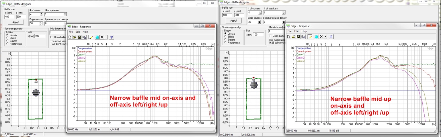

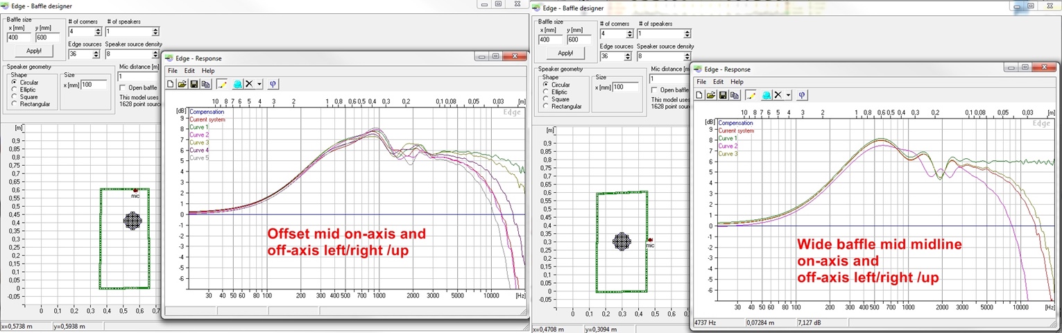

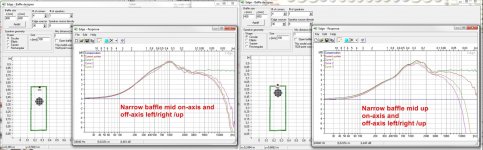

Some more Edge excercises!
A 100mm (4") midrange on narrow/wide baffle, off-axis left/right/up
We notice that an offset mid might be very smooth on-axis but left/right offaxis response show different and quite strong deviations from linearity. Will this do harm to imaging?

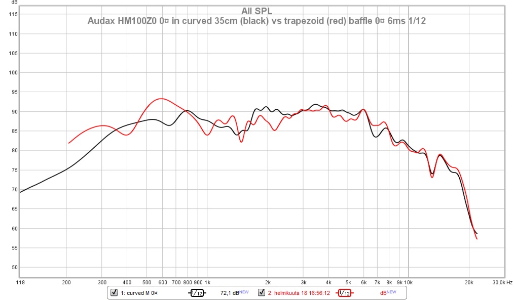

Measurements of a curved 35cm wide baffle, midrange up crame 5cm from top of baffle
The mid exhibits a baffle width-related dip around 1,5kHz. So, definitely the way to go is to put mid on top of the tweeter in a narrow or trapezoid baffle. The baffle might have wide bevels to make it narrow, in Avalon or Diapason style!
