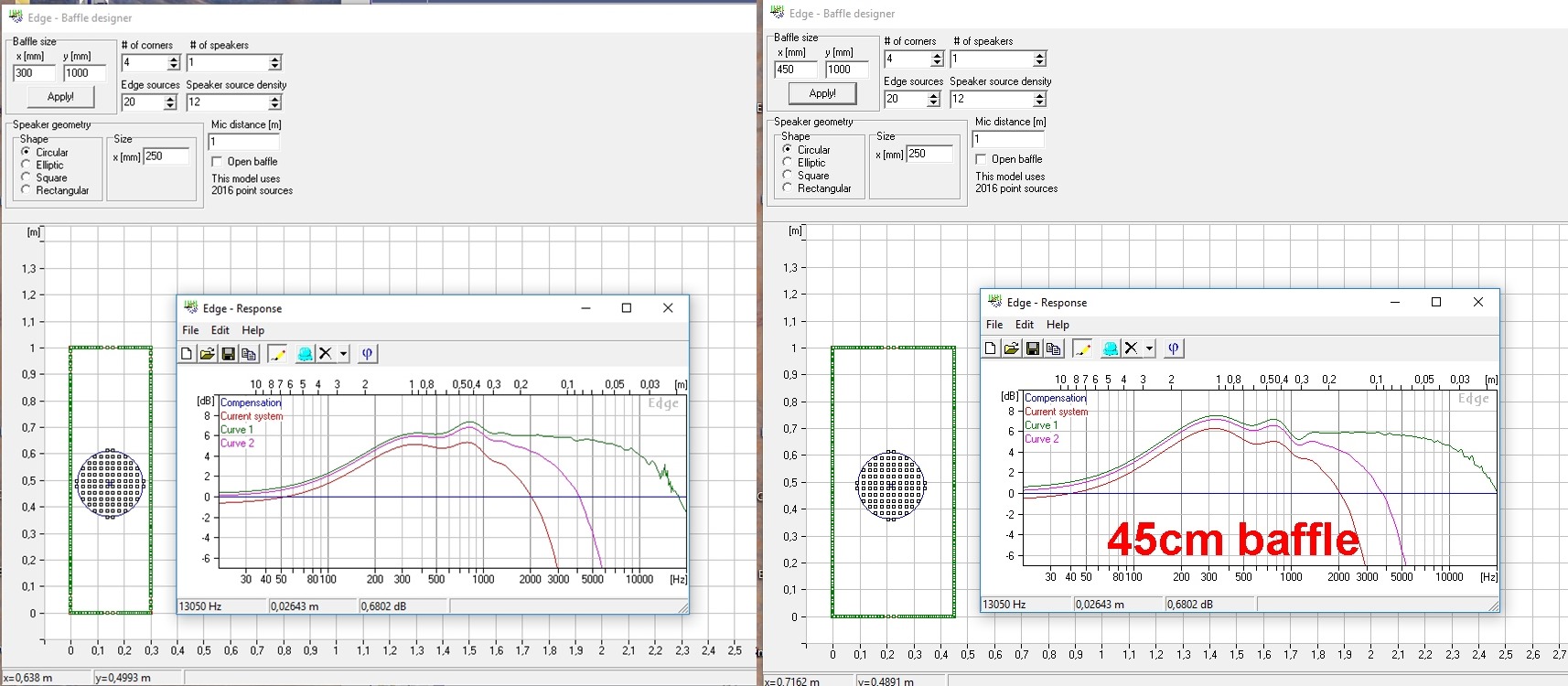

A large baffle is not detrimental to imaging, on the contrary. Soffit mounting of control room monitorsMaking the cabinet at least 16' wide as a minimum. This just seems really large to me, when it comes to imaging.
Actually I don't like those diffraction wiggles between 1-3kHz at all! My ideal baffle is wide curved like Sonus Stradivari! But that is more difficult to "hide" in a room. Perhaps i will try Magico Q style moderate width curved baffle next!
You mean kind of like this?
/\ Thank you JReave. Not that I will understand the software yet, or how to use it. But now I know how people are getting simulated results, and THAT helps me as much as anything. It is shocking to me, how much I learn from the replies to my threads! I have never been on a forum more helpful and forthcoming to newbies as this one.

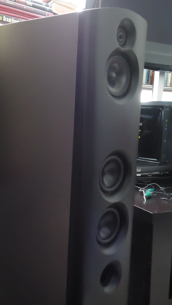

jReave -no, that model has the drivers way too deep in the baffle! Even the mid should be flush mounted when it is crossed rather high like I and Flaxxer are planning.
Well, the drivers aren't actually that deep but they look it because they're just small drivers (3 1/2"). But yes, when I posted and compared the photos, I said to myself, I think maybe I screwed up and rear mounted the mid too deep. I've finally arrived at the measurement stage and the tweeter and woofers seem to be fine so far but I'm noticing some funny off-axis behavior with the mid. More measurements to do when I am able but at this stage in my build, there's no way I'll be re-doing the baffles.

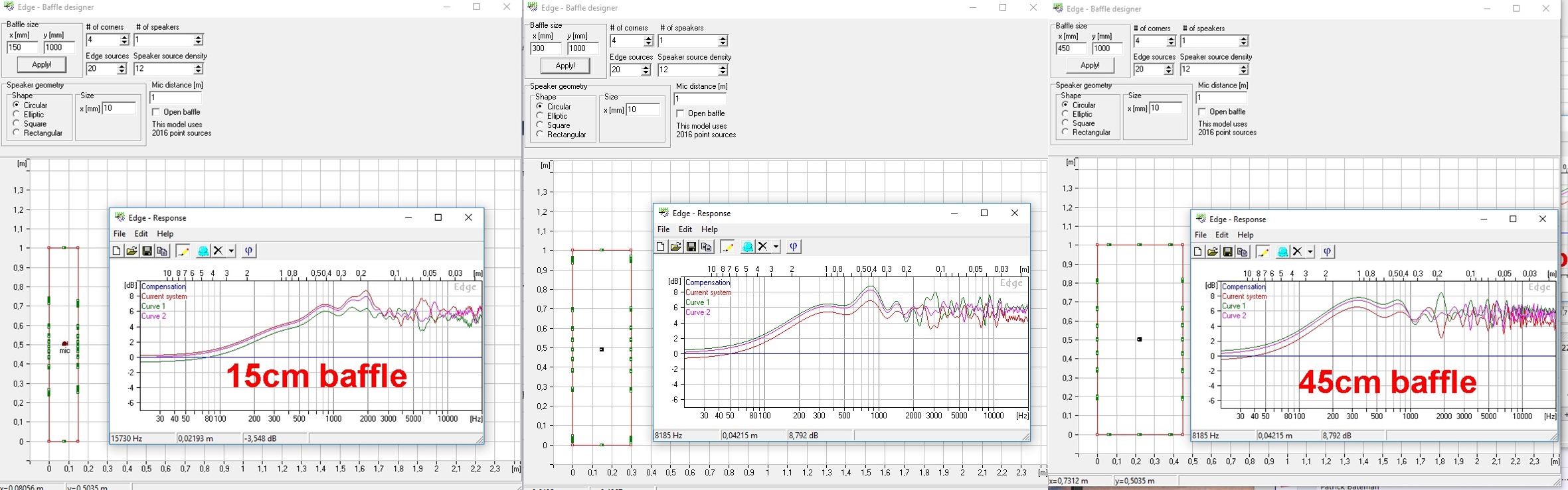

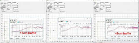

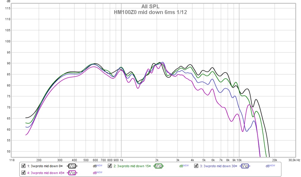

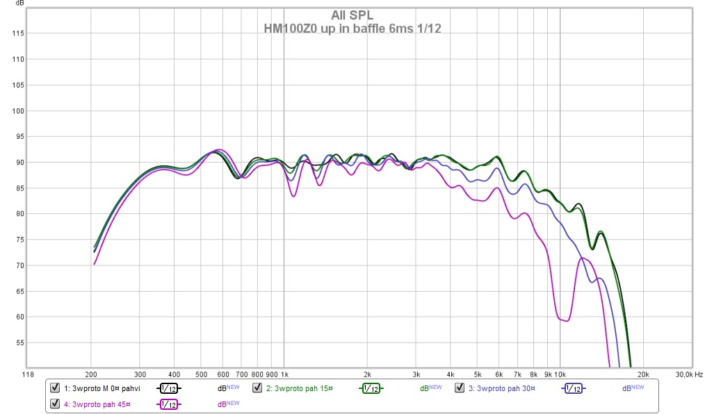

Changes in baffle size lead to changing the relationship between the on axis and off axis response. For a "flat" on axis response, changing the baffle shape changes how much energy is dumped into the room in the mid range. Or vice versa, changing baffle size while wanting to keep power response the same calls for changing the on axis.
No one has reliably determined how to determine how to balance the on axis and off axis response other than Olive/Toole studies indicating people prefer to have them similar in mid range presumably so early reflections have a similar tonal balance to on axis.

Diffraction happens at the edge of the baffle, so I like to think of the edge of a baffle as the location of a set of secondary drivers. The level coming out from the diffraction is reduced by 1/R distance between the edge and the driver. So a small baffle will have more amplitude coming from the diffraction sources as the edges are closer to the driver. The distance also determines how delayed the sound is coming from the edges and thus the phase relationship to the primary sound from the driver. At the listener the sum has ripple in the response due to the diffracted sources being in or out of phase at different frequencies. I use Jeff Bagby's Baffle Diffraction and Boundary Simulator to estimate the frequency response with different baffle configurations. So a large baffle with round edges will have lower response ripple. I find that tiny baffle speakers, B&W Nautilus, or mini monitors, tend to have wide dispersion and the resulting reflected sound due to the more omni pattern tends to call attention to the location of the speakers and recreate a performance in your room, where as wide baffle speakers, with a more focused forward only pattern reproduce more of a window into a performance in the room where the sound was recorded.

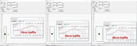

What comes to imaging, I don't believe in simple explanations like "narrow baffle images better" at all! Baffle width and driver diameter are most important parameters. Baffle width has bigger role in diffractions and driver diameter in directivity. Both are very much frequency-dependant. Look at Edge-simulations below! Mic at 1m distance, on-axis and 25/50cm off (roughly 15/30¤)
Listening impressions about imaging capability and problems published in magazines and forum have no correlation at all to baffle width of directivity profile! At least I can't see that! This is a very difficult topic. Griesinger gives some psychoacoustic baselines of the dilemma, which is also very frequency-dependant and obviously we humans have great variance in how we hear it. Room has a very big role too.
My guideline is to get as smooth and stable directivity as possible and to avoid edge diffraction ripples at least between 1-5kHz. This is a very demanding task to achieve!

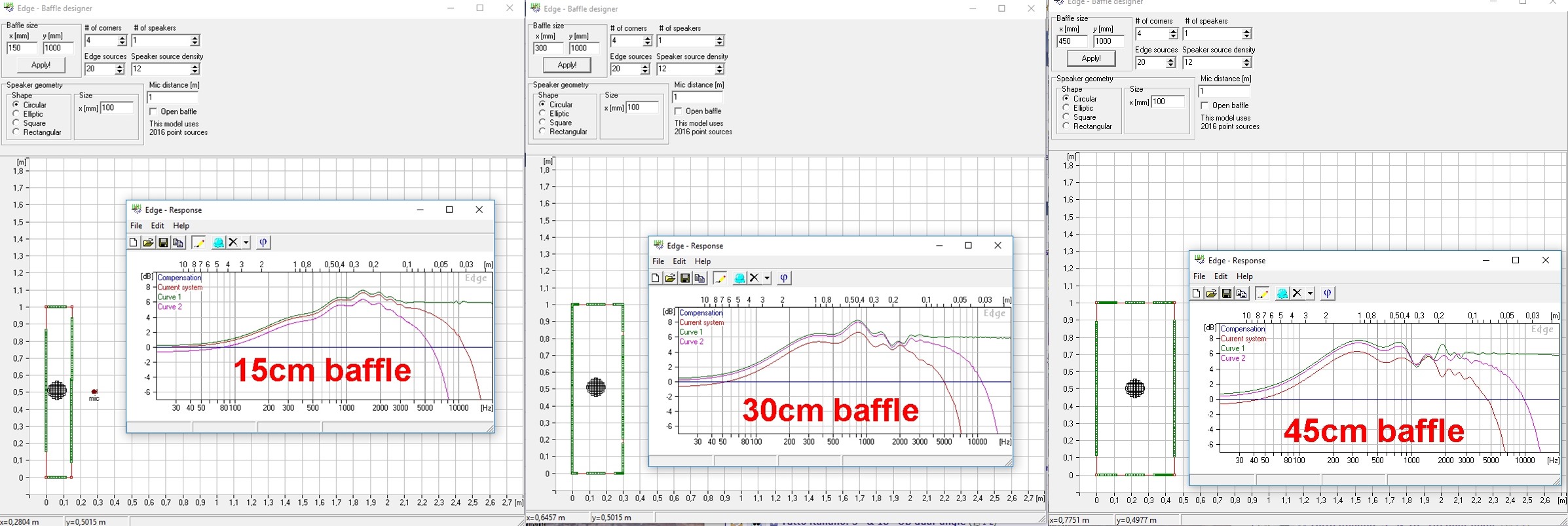

My proto measurements in narrowing baffle, mid up vs. mid down. Definitely better to place the midrange on the top of the narrow baffle! Test baffle has 90¤ edges.
