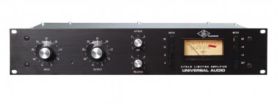

This is the weapon of choice of those who started the Loudness Wars. Another problem is that the main protagonists, the Lord-Alge brothers, mix at very low volume and you can tell because stuff they touched (or ruined IMO) sounds ok at muzak levels but atrocious and obnoxious at anything above.

Chris Lord-Alge records everything onto his ancient Sony 3348 at 16bit while his brother Tom uses the 24bit version of the same, sample rate is either 44.1 or 48kHz.
Those things hit the market in around 1982.
Chris uses a 48 channel SSL E-series which he likes because it has in built compressors on each channel plus a rather nice bus compressor. Those are additional to his many outboard 1176. Apparently he spends between 30 and 60 minutes on each mix for which he got paid around $8000 each in the late '90s.
So it is safe to assume that every instrument track goes through 3 rounds on compression plus whatever that digital multitrack does to the sound.

Probably you know this, but 1176 had been using regularly long before the loudness war started, and it is used for individual instruments, not for 2 mix buss. When we say loudness war, it's about 2 buss compression, and loudness war actually started when a digital compression based on psycho acoustics was invented, such as Waves L1, if it has be explained more accurately.
We usually do not call pre-digital age loudness manipulation "Loudness War".
I wrote this recently somewhere, but analog compression and peak limiting is absolutely necessary for commercial recordings, because the dynamic range we can record is much narrower than the dynamic range of the real instruments, and also because we listen to the music much quieter than the sound level of real instruments.

Sorry I missed an entire page this is meant to answer Plasnu's post 1610
Sure I know that the 1176 is a mono compressor but as I said above Chris Lord-Alge, the main war criminal in the Loudness Wars, uses probably 30 or more of those things ie he possibly compresses each track on the way into his 48 channel SSL with the onboard compressor, then treats each track individually with an 1176* each and compresses again with the bus compressor on the way to the stereo master.
While he has a plug in suite of compressors named after him he uses the analogue originals.
*probably a few other vintage beauties like Pultec but mostly 1176s
