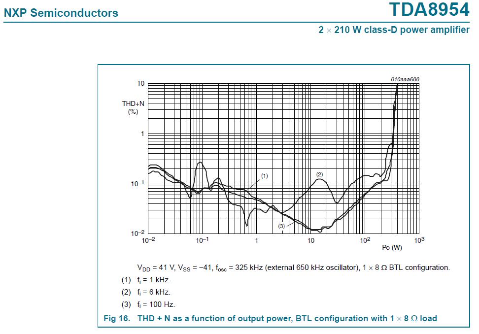

Thanks for the insight JMF, I didn't know that about the unreliability of those chips. I'm having trouble finding the STK series from a vendor. The most powerful class D chip I've found so far is: http://www.mouser.com/ProductDetail/NXP-Semiconductors/TDA8954J-N1112/?qs=sGAEpiMZZMtxdzBvM0rKcbaYt4XXYNSfuKhFKotYIUw%3d
210W/ch @10% THD, doesn't list power at lower levels.

Let me bounce this off of you guys and I might be way off base here so correct me if I am. I looked up the max that the positive DC rail can be for the top 3 contenders of the most powerful amps (not getting into bridge or parallel configurations).
If you figure a max rail to rail swing for the supply into the 4 ohm load with no losses and then look at max rated power, can you get a ballpark idea of efficiency or will it not even be close to real world measurements?
LM3886
42V -max supply -220.5W average power into 4 ohms @100% efficiency
?W in 4 ohms @10% THD 68W in 4 ohms @ 0.1% THD
~31% efficiency
TDA7293
50V -max supply -312.5W average power into 4 ohms @100% efficiency
100W in 4 ohms @10% THD
32% efficiency
TDA8954 Class D
42.5V -max supply -225.8W average power into 4 ohms @100% efficiency
210W in 4 ohms @10% THD
93% efficiency
Has anyone on DIY ever measured the TDA and LM against each other for max unclipped power?
