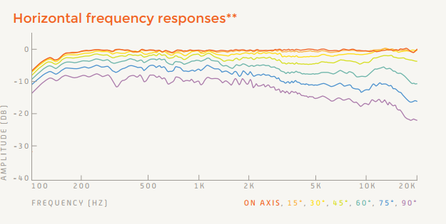

Computer simulations only got us so far. Ultimately you just have to build and test it, especially the waveguide!
Those are shockingly flat response plots. Maybe flat and smooth isn't the be-all, end-all of monitor design but if flat and smooth is what you want they seem to do the job.
Not everyone seems to agree, and that's fine. I used to think differently too, but right now I'm aware that there already is a very solid scientific foundation when it comes to loudspeaker design. When we designed the 8c I really felt like we were standing on shoulders of giants. The design criteria for the 8c were very much in line with the teachings of for instance Floyd Toole.

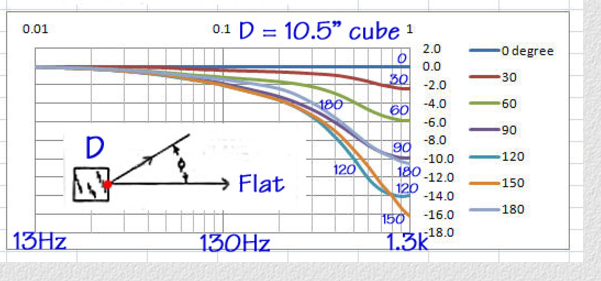

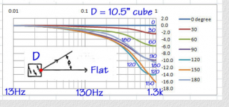

You shouldn't be. It happens in any speaker and usually all that is done is EQ the on-axis peak. The difference is we actively used the phenomenon to achieve a certain directivity.
What i criticize is the current high DF trend/fashion: The more the merrier.:bfold:
You will of course answer that it is not a fashion, it is science, and if you can atenuate -10dbs at 90º, it's better than -6dbs, which is also better than -3dbs.
Of course 6dbs of full BSC + eq -3/4dbs of diffractions ( free gain...😀) will give you aprox those 10dbs, but aiming for this is may be your religion but not my religion, just a politically correct choice to please a given market target who also happens to follow this religion.:wave:
In a word all these choices are not about science, but pure ideology, as almost always happens in audio, and all these choices have a sonic signature of their own, for the good and the evil.
