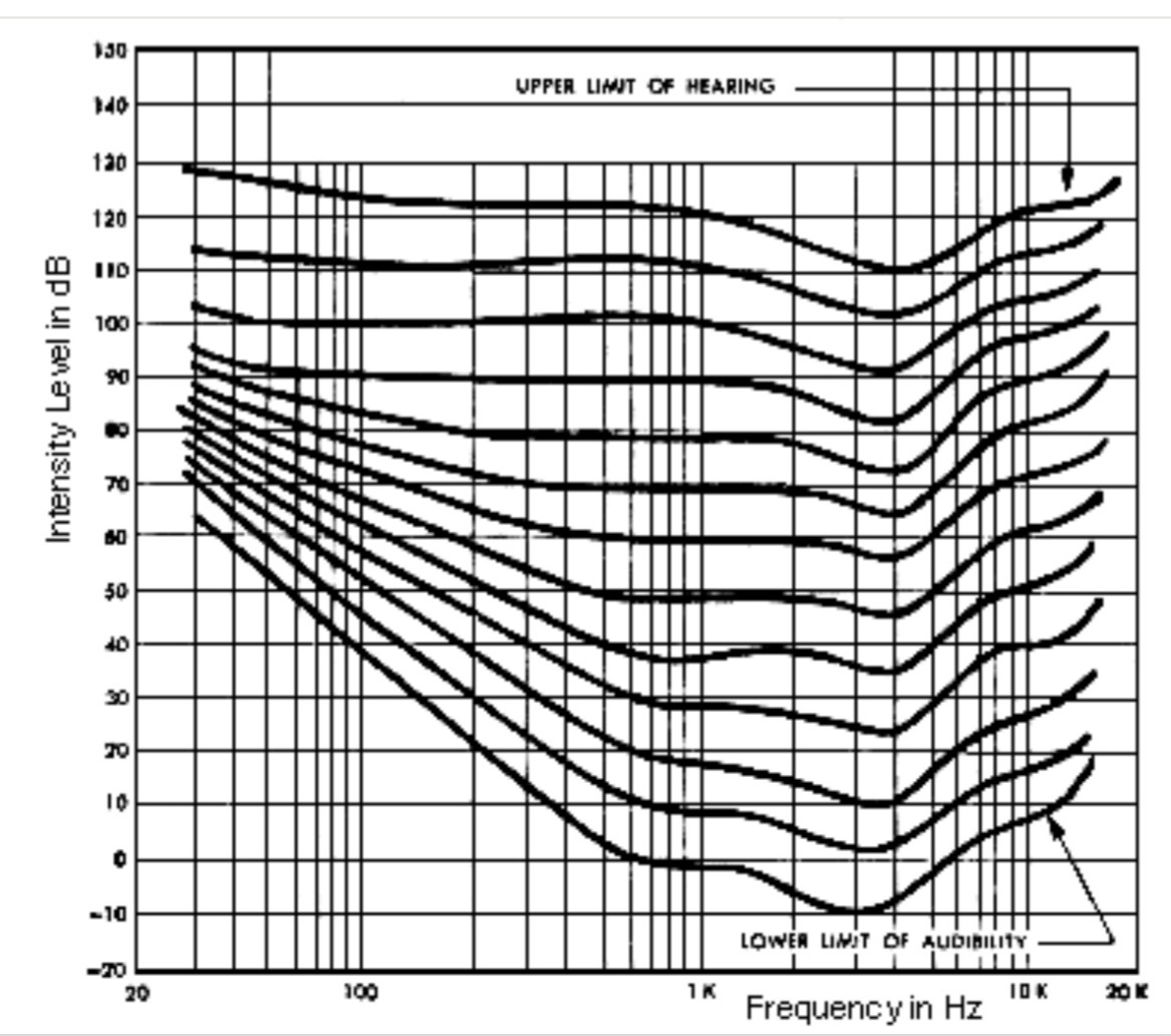

Those fletcher-munsons curves are often misunderstood!
They are : Equal-Loudness-Contours (ELC)
Natural FR is HRTF , depending on angle in all XYZ directions!
In all those years there was no one who told the people where the deep 8kHz dip in the ELC is coming from!
Still waiting for a mastermind to explain on that ....

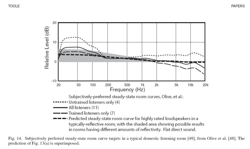

Subjective preference for steady state room curves according to Toole and Olive:
Still depending on the directivity of the speakers used and the room itself though. Though I do believe it is wise to set
and use a specific SPL listening level (on average) when looking for these kind of preferences.
While preferences can certainly be all over the place, arguing FOR wild deviations from 'flat' response with claims of them being justified by "research" (as in the above graph) is seriously misguided.
Because any capable sound engineer (here I am impyling he/she is competent enough to only use 'flat' operating gear - as well as reasonably 'flat' operating rooms.. - for ALL reproduction! purposes) would already have "adjusted" the spectral balance of the recording in accordance with what the audience he/she is aiming at probably likes in terms of 'sound'.
Hey, I'm only presenting a graph from the research of Toole and company. My preferred curve from tbat set, as I need to draw my own with arrays, is the dashed line (trained listeners). I landed on that curve before ever seeing that graph. Fact is, what measures flat anechoic, would not measure flat, steady state, inside a room at listening distance.
I would not want to listen to that "untrained listeners' curve either. Or it would have to be at very low SPL levels.

Look at this loudness graph and see how non-linear your ears are at various volume levels - thats why its important to compensate FR for listening level. Keep in mind this isn't the exact curve I follow, but it shows the areas where hearing is non linear and something that sounds flat at 70 dB won't do so at 90 dB.
I know alot of guys aim for ruler flat response when designing a speaker, but flat rarely sounds good with most music, except for maybe jazz, classical. I always design a slight amount of BBC dip (maybe 1 or 2 dB at most) into my stuff, mainly because I usually run everything straight up without any EQ and like to listen on the louder side (requiring more mid dip to keep ears happy). If you're striving for a flat response at any cost, its important to factor in what kind of music you mainly listen to. Yes, an ideal speaker should be able to play anything well, but it doesn't work that way in reality.
