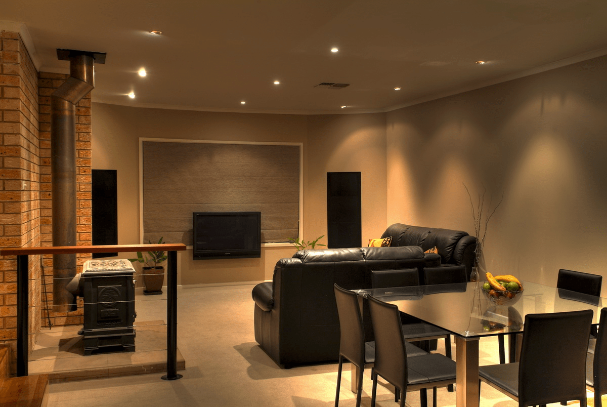

William Cowan did similar-ish maybe 15ya ...
Well that's one way design solution to potentially bring diffraction down I guess. Brilliant build and nice to get the speakers hidden too. How did they image? Did they pull the trick of imaging behind the wall? @cowanaudio
I can comment regarding the imaging capabilities of in wall or soffit mounted speakers from studio monitors used in similar configurations. The imaging of such a speaker setup can be holographic and sound like the image is out in front of you closer than the speakers themselves. It really depends on power response and off axis linearity, plus the phase linearity characteristics in the critical midrange from 500 - 10k.
I've heard soffit mounted Tannoy Monitor Golds in a well known studio with highly optimized passive crossovers. Hearing them was one of the top 5 best speaker listening experiences I've had to date. They were driven by a modified Crown DC300 - not what you would consider high end by far.
