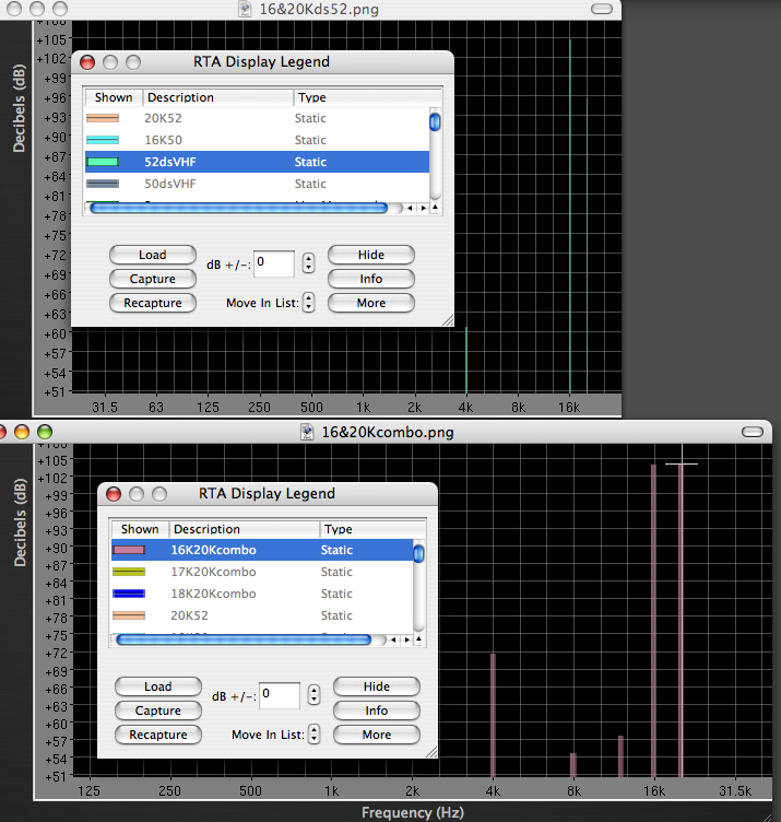

When two tones are presented to a HF compression driver, a sub harmonic is generated at a frequency that is the difference between the two tones, for instance 2093 (a “C” note) & 3729 (a B flat note) Hz tones produce a distortion component at 1636 Hz, somewhere between a G and G sharp note.
Not good, but the 1636 Hz distortion tone is so far below the other tones in level it does not seem to present an audible problem.
A sub harmonic of 16 kHz and 20kHz (both of which would be inaudible to me and lots of other fellows of a mature age) is at 4K, where ears (without noise induced hearing loss) are most sensitive.
Tests of a half dozen different HF drivers proved that the 4 kHz sub harmonic distortion was also quite low using a dual sine wave tone of about 4 volts . (-20 output level in Smaart, Crest CC2800 at “0 dB”, X20 gain setting).
The sum of two different signal powers is roughly + 3 dB if the two powers are equal . The dual sine wave tone presents about 2 watts, 1 watts at each frequency in to the nominal 16 ohm load.
Screen shots below show the 4 kHz sub harmonic of the BMS 4552 over 32 dB down from the fundamental tones, about 2% distortion.
The BMS 4550, having less 20 kHz output, generated a 4 kHz sub harmonic 48.4 down from the 16 kHz level, less than .5% distortion. The dual sine wave tones were at two meters.

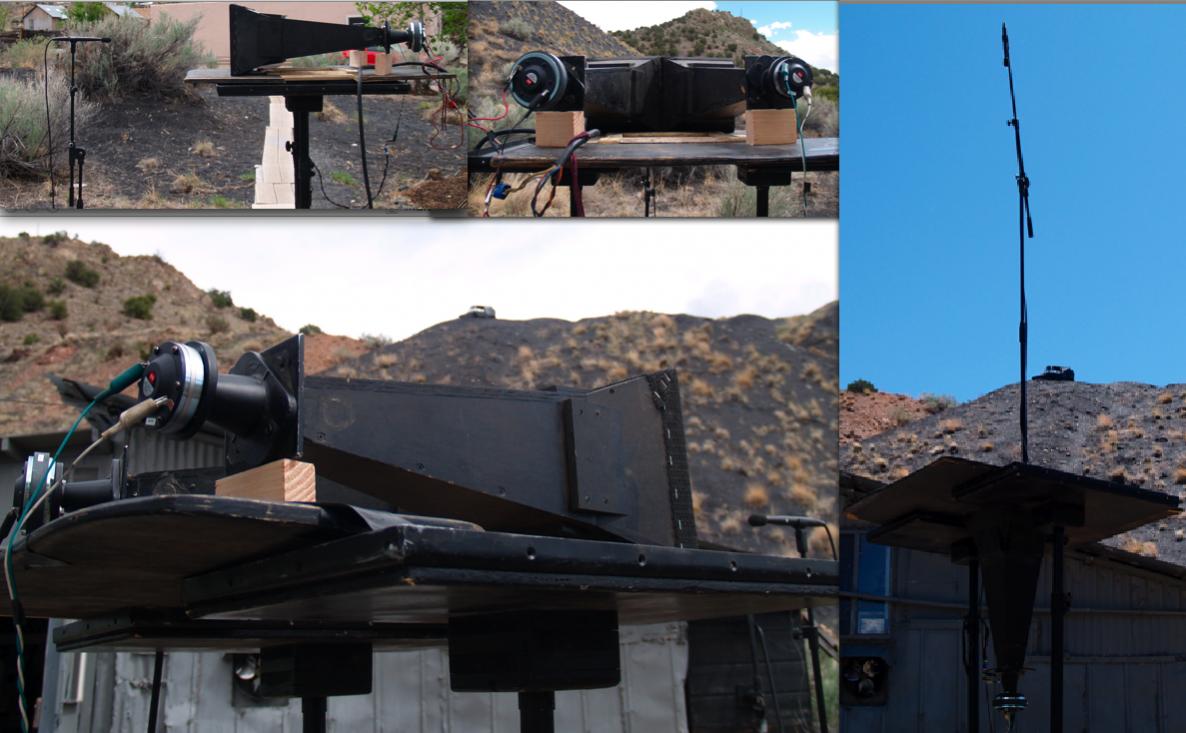

It should be noted that the Maltese horn used for the tests is a conical horn of 13 degree dispersion (-6 dB points above 2.5K) , so it is about six dB louder on axis than “typical “ horns.
The test:

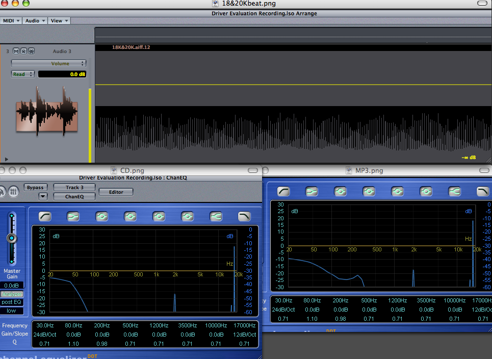

Beat tones were generated using a 20 kHz sine wave from the Smaart generator, lower tones generated from a BK Precision 3011 B 2MHz Function Generator.
B&K 4004 microphone 22.5” on axis from each horn, using Panasonic SV3800 for some gain, it’s digital output recorded with an Alesis Masterlink, the Redbook CD recording then transferred to Logic Pro 7, then bounced to MP3.
The recordings are made full scale, the beat tones and my vocal explanations are some 35 dB below the VHF tones, I would suggest a playback level at least 12 dB down from “normal” to start with.
The MP3 does not seem to have reduced the VHF level from the original recording, those of you with hearing to 20 kHz will find the recordings quite nasty.
If you have access to a high filter, cutting above 15K would reduce stess on the playback system and your ears.
The files with “.zip” are actually MP3, change the suffix to open them.

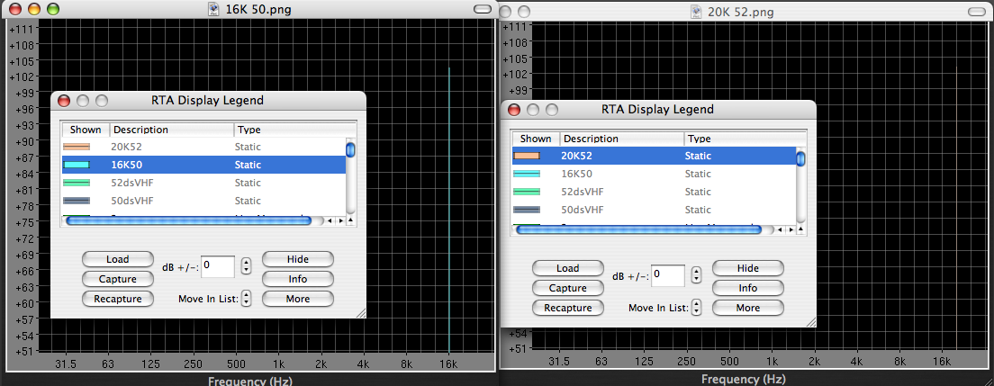

Sine wave level was -14, about 8 volts, 8 watts in to a nominal 16 ohm load.
The dual sine wave tone would be about 16 watts.
16K50 16000 Hz through BMS 4550 (103.4 dB)
20K52 20000 Hz through BMS 4550 (103.2 dB)
16K20Kcombo 16K and 20K combined response (two separate horn drivers recorded by the B&K microphone)
4K 71.6 dB, 8K 54.7dB, 12K 57.9 dB, 16K 103.9, 20 K 104.0
52dsVHF (16 kHz & 20 kHz) 4K 60.6 dB, 16K 104.7 dB, 20K 95.7 dB,
50dsVHF (16 kHz & 20 kHz) 4K 56.4 dB 16K 104.8 dB, 20K 94.5 dB

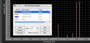

17K50 17000 Hz through BMS 4550
17K20Kcombo 16K and 20K combined response
3K 70.4 dB, 14K 55 dB, 17K 102.5 dB, 20K 104.2 dB
18K50 18000 Hz through BMS 4550
18K20Kcombo 16K and 20K combined response
2K 70.3 dB, 14K 53.2 dB, 18K 104.8 dB, 20K 104 dB

Recordings of each combo, and tone sweeps were done with the BMS 4550 from 15K up to around 20K.
Although it may be said that a beat tone 35 dB below the (inaudible) fundamental is too low to be considered, I have witnessed many orchestral and big band conductors “call out” one out of tune player quite some distance away. While the beat frequencies I recorded are certainly no proof that everyone would benefit from frequency response above their HF frequency threshold, I have no doubt some can perceive the difference that is clear in both the screen shots and the audio recordings.
Many recordings were made, in one a frequency of beating at 100 Hz , the difference of 19900 & 20000 Hz is clearly audible with a high flying jet and bird noises also in the background.
This test proved my point better than expected, I had tried a similar experiment years ago, but the horn/driver combination I used was not up to the task.
The BMS drivers on Maltese horns were.

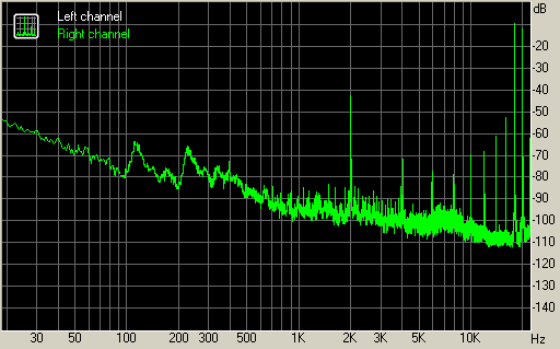

Thanks Art! There is certainly a lot more going on there than just the two high tones. See my shots below.
Would be interesting to know what the output of the amp looks like at the driver terminals, and also at the terminals of a 16R resistor. I.E., how much is the source, how much the driver, how much the tones in the horn throat. Some real promising stuff there that we amateurs rarely get to see.
