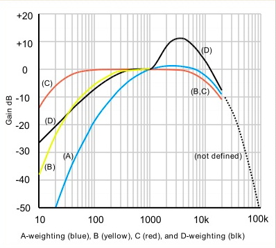

I did toe in the HiVi done tweeters. From what I can find, the RS meter is within a decibel or so at 18-20Khz. (Surprising). Verified with my recording mic and that seems to be about right.
I tried the test again louder with ATP50 horn tweeters. Set at 110dB at the mic. Similar results.
Most likely the close distances you used preclude your ear from getting in to the convergence zone.
Seems the RS meter does not adhere to the A or C scale weighting in the HF, it should be 9 or 10 dB down at 20K.
I'll compare my old RS analog SPL meter to Smaart and the Terasonde Audio Toolbox response on "A" scale next time I do some HF testing.
With all the ringing in my ears the recent compression driver and VHF tests have caused, that may be some time from now, must give the ears a rest...
