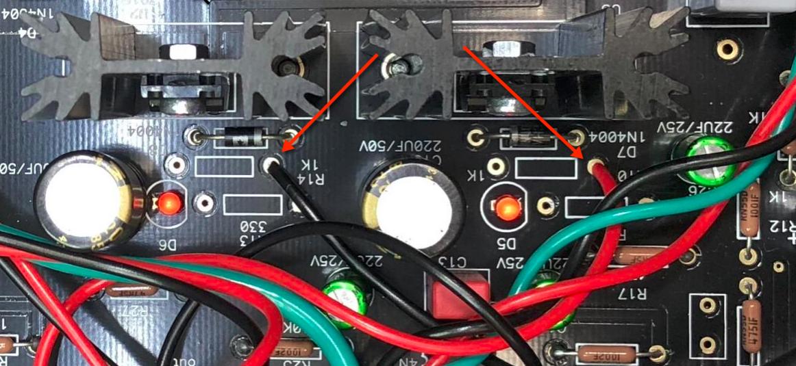

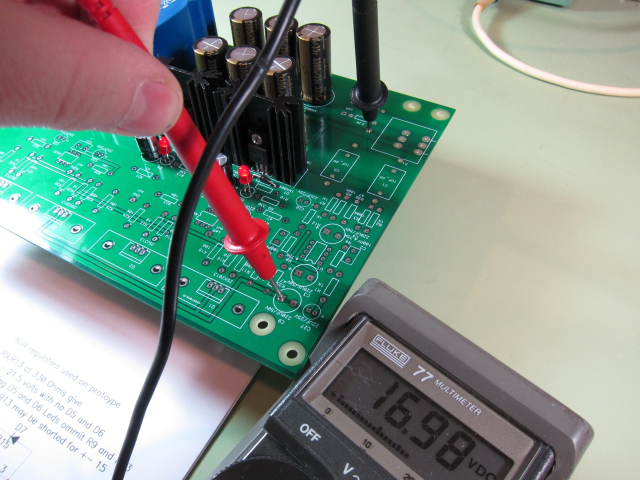

You'd just tap into the power post-regulator, connect the other end to neutral. +15-17v would be fine for that.
Wayne-would there be any advantage to using a more advanced Vref in place of the LED?
Nate,
Thank you. So, I can simply tap into these 2 points as indicated by Wayne (see attached pic).
I'd have to look at the board layout to recommend an "ideal" spot. That spot looks like it gets a capacitor put over it, scabbing on to the backside with some leads would probably work fine. I'd try to get as physically close to the output of the regs as possible to keep the LED as far from the audio bits as you can. The draw is going to be so minimal that I doubt it matters much where on the rail you tap in.

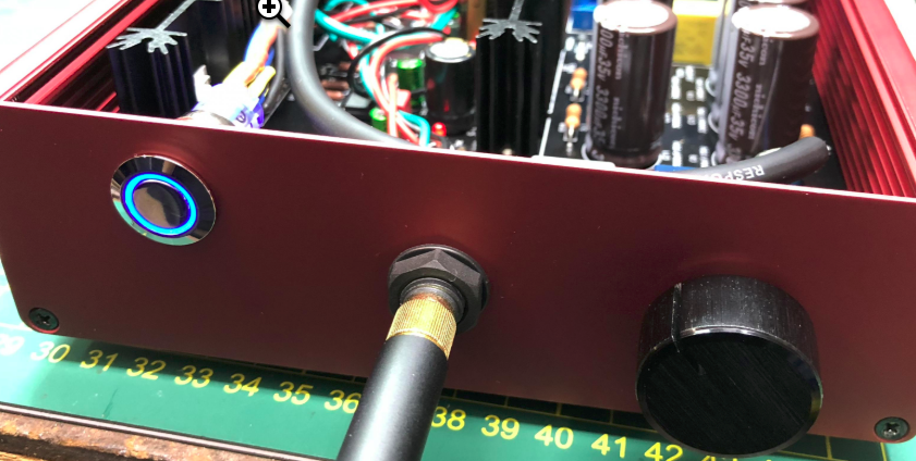

Has anyone used a LED Illuminated push-button power switch on their amp?
I like to use this switch on the front panel:
Push Button Stainless Steel with Blue Light Circle 250V 3A O16mm Silver - Audiophonics
The LED is rated 12-24V on the spec sheet. What is the best way to power the switch's LED from this amp's power supply side?
Thank you.
Hi PC997,
I used that exact same power switch. Please see post #293 in the thread.
The easiest and cleanest way was to simply added a feed from R10 & R14 (as they are not used anyway) to the v12 LED (power Switch) with a 4.7K limiting resistor on the R10 +V link side. See below:

Hi PC997,
Mark.
mbedwani,
Thank you very much for the information.
