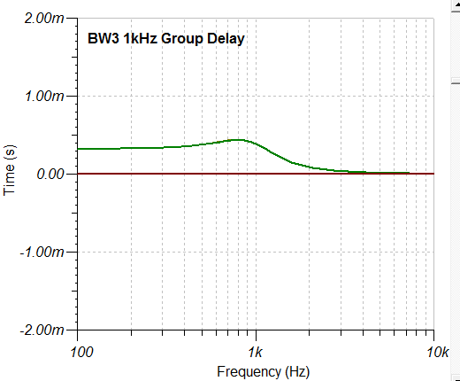

I also like my maths and quantum theory. Here's something (Group Delay) EVERYBODY glossed over:

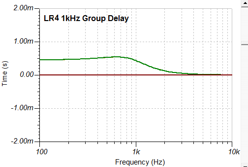

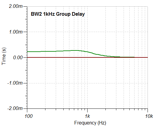

The relationship between Butterworth and Linkwitz-Riley. See, two BW2 cascaded makes a LR4! And it follows that two BW3 cascaded makes a LR6.
Interestingly it matters not one whit what you do to tweeter polarity, the group delay remains constant. So two wildly different impulse responses and frequency responses have the same group delay. It actually gets a bit like the quantum theory. The big question is always "What can you actually measure?"
It seems to me that you can measure as exactly as you like, but still be uncertain if the tweeter is on top or below the woofer, or what the polarity is.
I am greatly enjoying taking speaker design into the quantum theory. For those of you living on a different planet with (HIGH-EFFICIENCY) horn tweeters or fullrange (FULLRANGE) drivers which are a very different discipline from MULTIWAY, I can only say loosen up a bit. But I seriously wonder why you hang around here. We do what we do.

group delay is the derivative (negative) of unwrapped phase vs frequency, so polarity won't have anything to do with it. Reverse polarity does nothing but move all the phase values by 180 degrees, the slopes don't change. But polarities will have a lot to do with how wavefronts from tweeters and woofers will combine, and the resulting group delay (and frequency response magnitude) of the combination.

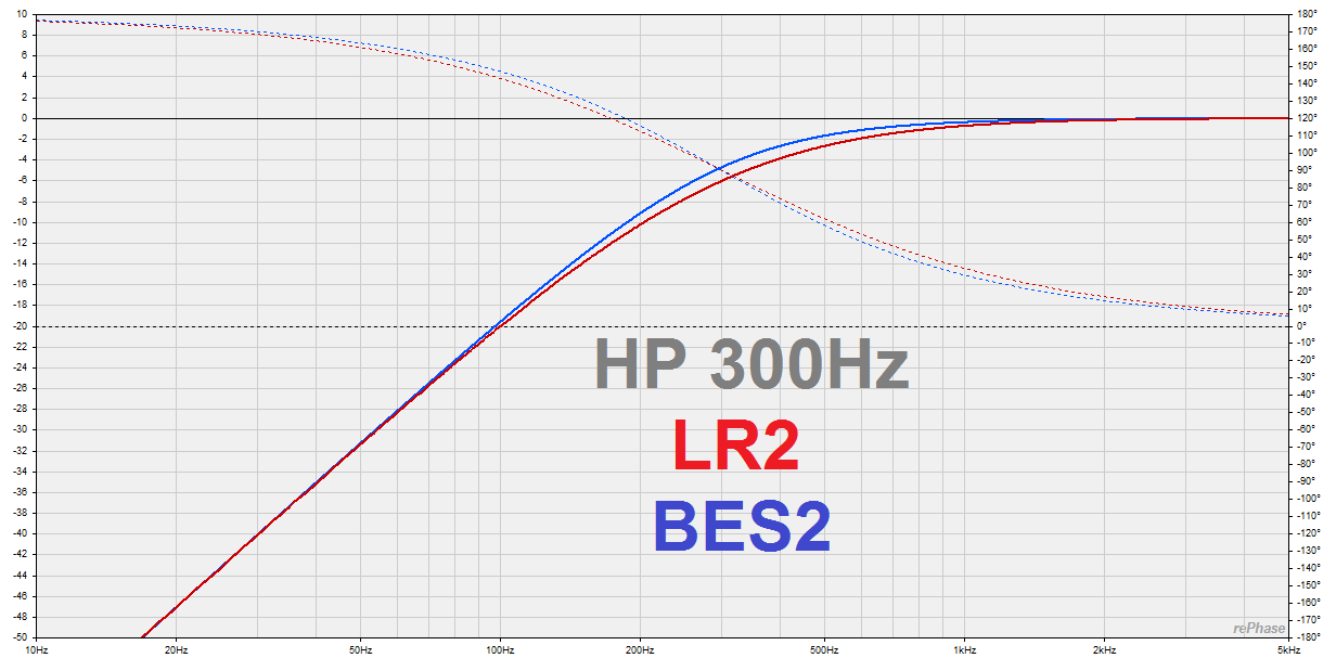

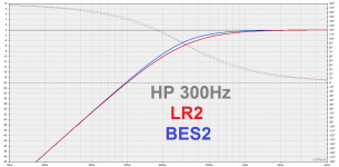

.....I went with bessel originally because of the theoretical time domain advantages, and also because virtually no one else seems to (I like to tread the path less trodden). I think people tend to shy away from them because they don't sum completely flat like a LR.
Interestingly for whatever reason, I always find in simulation it is easier to get the drivers to match the bessel slope than a L/R one.
One interesting thing about the 2nd order bessel is that it is actually a steeper slope than a 2nd order L/R whereas with the 4th Order it is the opposite (ie L/R is steeper than bessel). So if you are worried about power handling with a 2nd order slope, a bessel may help somewhat.....
About 2nd order BESSEL agree they don't sum flat as 2nd order LR do, but don't agree it tax less on used driver. In my notes doing research in past to simulate 2nd order BESSEL slopes into Rephase/REW/XSim it reads take a LR2 slope and add a PEQ Q0,58/+1,3dB at frq of XO point and its now transferred to BES2 as seen below, can you agree this .
Hi Brytt, I think probably my wording was wrong. I said steeper slope, but when you look at your example, it is more a steeper knee. If you look at the LR4/BES4 the knee would be reversed, ie the bessel would be the one that starts rolling off earlier with a bigger overlap region between the drivers.
That's probably what I should have said, the overlap region of the drivers is narrower with the bessel compared to the LR with 2nd order. Some adjustment can be made (to the bessel) by using asymetric crossover points, provided it doesn't mess with phase too much, to get flatter summing. This is a good article on bessel filters used for crossovers A Bessel Filter Crossover, and Its Relation to Others

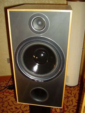

WLM produced the 8" plus 2" cone splendid WLM La Scala design:
These are extremely cheap Visaton drivers which I happen to own. You take your chances on the filter. I would favour at least 18dB/octave at 3kHz. Or about 3rd order. It has its strengths. Cone tweeters can work very well without sounding overly bright.

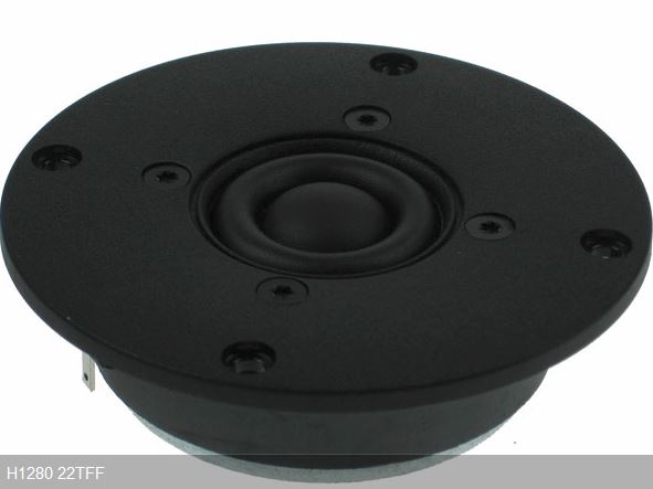

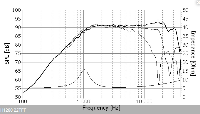

The H1280-06 22TFF is an animal like this.
But, TBH, whatever I think of soft-domes, a 1kHz crossover is a bit low for a 3/4" tweeter. I wouldn't expect that to go loud in comfort. 3kHz would be more like it for the big orchestral pieces.
