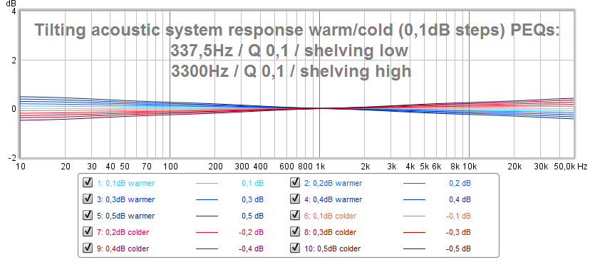

Thought i share this homemade tilting EQ tweak here because it also influence a lot on "you are there" and "they are here" imaging in room balance, and think it works pretty good after house-curve is dialed in as a last stage subjective tweaking tool where one can step small 0,1dB numbers at a time and evaluate acoustic domain performance. Its not a strait line completely ripple free when zoomed into but if it was it will take too many PEQs to change then every time one would step filter, so ended up use only two shelving filters to get it done.
attachment.php
650664d1513004688-suppose-shallow-vs-steep-argument-3001-png
Thx BYRTT, I really agree that such simple shelving EQ can have a major effect on how we perceive the issues being discussed in this thread.
In fact, I think the boost or roll-off on the ends of the spectrum, inherent in most all recorded material, has a super influence in how our systems responds in general.
My first attempt to address this issue was with sets of shelving filters, that allow me to basically create a seesaw frequency response, where I can control the fulcrum point and the tilt of the frequency response.
Though a lot of trial and error I've settled in on 640Hz as the fulcrum point, with 3 or 4 low shelf filters below, and 3 or 4 high shelf filters above. Filters are generally spaced an octave apart.
Works really well for making almost any recording sound natural. (My systems all start tuned flat without any EQ...really flat , freq and phase:)).
My latest attempt, to make the above less cumbersome, is I now have a volume control on each passband on my 4-way system. Each passband is about 2 to 3 octaves wide.
I use a mixer where I have 4 adjacent sliders for relative passband adjustments, all controlled jointly by a DCA for overall volume.
Each passband is linear phase thru x-over and summation to at least -20db, so I have a lot of ability to maintain linear phase throughout the spectrum, even as I move acoustic x-over points up or down.
I'm loving this setup. I can make almost anything sound good.
What I've learned in adjusting the passbands is I'm really compensating for whatever spectral tilt is in the recording.
My theory is: let's assume our hearing is reasonably the same...whoever did the mastering did their best to make the recording sound good in their mastering room.
Which means they dialed in levels and tonality in response to what they were hearing from their speakers with whatever spectral bias the speakers and room imparted..
I don't know a lot about making recordings, but I assume all must be mastered, whether recorded in studio or in live ensemble. If this is true, then all recordings reflect what the mastering room/speakers sound like.
If recorded where speaker/room was flat...I don't need to touch the sliders. If recorded where bright, the mastering will turn down the highs and I will hear they need to be turned up.
IOW, if I hear a spectral imbalance on any of the passbands relative to each other, I figure that reflects the opposite imbalance in where the recording was mastered.
All FWIW:D
