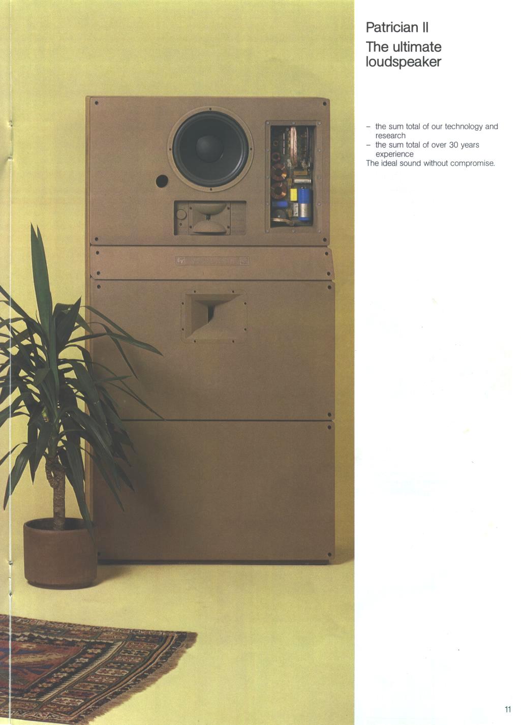

Don't know of Australian speakers but I do know of an Australian guy who owns or owned a pair of Tannoy Westminsters alongside a pair of Electro Voice Patrician 2s.
(That is a 12" cone mid)

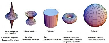

At a mathematical level, not only does the geometry of the device matter, it also matters what the space is that it is embedded in. This is Bernhard Riemann stuff. Which means the speaker geometry matters, and also the room.

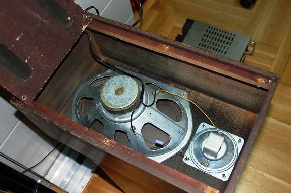

Here's something that is not perfect, but a lot to like:
We just do our best.
