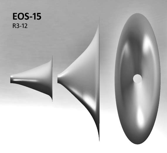

We are on making E-OSWG-15. What other sizes are welcome? OSWG-12, E-OSWG-10?

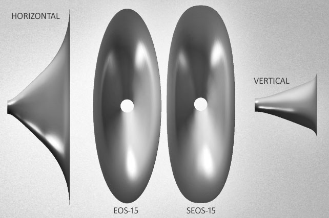

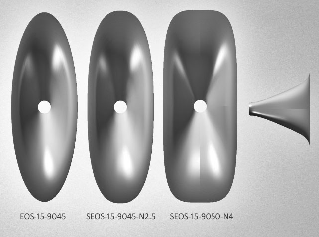

doug20 - I'm collecting opinions from both forums. I will prepare super ellipse mod soon - SEOS-15. So we have for now:
SEOS-15-9050-R3R13
SEOS-15-9060-R3R13
which means 15" super elliptical OS waveguide, 90x50 coverage, roundover R3 and R13 (vertical and horizontal in cm)
Thanks Jack. At first blush, doesn't look much different but upon closer examination it does look to be a bigger "scoop". I think in the case of 90x50 where vertical << horizontal a slightly larger n (say n = 4) might be beneficial. I am not trying to create more work for you, I am impressed on how fast you were able to do this.
