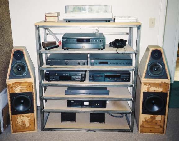

Here is a shot of my unfinished quazi watt puppy clones. There is an alignment flaw on one of the cabinets that I was going to fix when finished but I just don't care right now.
This room is a home office and good speaker placement is not possible, still the sound is great. I did not attempt to make an exact clone because there were some things that I did not like about the watt/puppy. The stereo rack is also home made and because I liked the industrial look I never painted it. It is all assymetrically braced and all steel tubes are filled with plugs of lead shot fiberglass and silicone glue to reduce vibration.
These are the things I changed over Watt/Puppy design. THe bass module of watt/puppy moves air and is dynamic but too high a Q alignment for natural sound. I used only one nine inch driver since this room is small and get better transient and more natural bass.
Silk dome tweeter instead of titanium is better for a lot of less than stellar CD recording. THe WATT tweeters can be killers if the program material is not of near perfect virtue.
To save a little money I used a Audax carbon fiber cast frame midrange driver. THe natural timbre of this driver in the midrange is outstanding.
Cabinets weight about 150 pounds each. All walls 1.5 inch thick MDF except upper cabinet which has 2.25 thick front baffle. Cabinets are aperiodic loaded. This is somewhat less bass but gives outstanding transient response and endows the mid bass and midrange with glorious natural timbre quality.

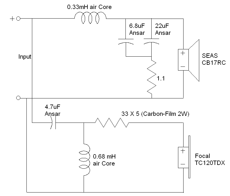

Konnichiwa,
There is no simple way to modify the crossover. You would have to use the same process I used all these years back. That was to work from information present in the public domain about the filter topology (there is non on the current WP's) and the published electrical impedance measurements of the speaker and the known driver parameters to derive values that would give a reasonable frequency response AND match the electrical impedance curve shape.
As you actually want to use completely different drivers even that will not really work.
Sayonara
minh_827 said:I'm doing the watt puppy clone right now. But instead of using the seas and focal. I going to use the scanspeak 8545k and scanspeak 2904/9800 for the watt. Can someone help me modified the crossover to go with the new drivers.
Sayonara
bfard said:
Those are really nice. Excellent job - possibly the best I've seen. Would be interested in seeing your crossover and drivers used.
