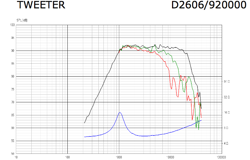

I measured it and it is the result off fast phase shift above 10kHz of a tweeter with poor of axes.

You can't control dispersion with the crossover >8kHz And I rever to a ribbon off-axes like this -20dB 20kHz.
First, I wrote that dispersion at low frequencies must be controlled with a waveguide AND that then equalisation is needed in the crossover to get a flat frequency response.
How you come from that to what you claimed to be what written (control dispersion with the crossover) is a mystery to me...
You are showing a magnetic planar driver without wave guide and one at that who has a poorely designed "phaseplug" (or whatever you want to call it), leading to a cancellation notch. This in turn is made to look worse by the way HiVi Measure...
I am unclear what you measured, but the Watt does not use the D2606, never has.
I am only talking Dispersion above 8kHz what is poorer with most planar drivers
