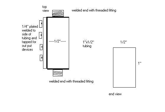

heres another idea for a heat exchancher that you could build out of rectangular aluminum tubing. this is a crude drawing that i did in windows paint but it gives the general idea. the tubing is cheap but you'll need to have a little welding done with a mig or tig.

I started with rectangular aluminum but wasn't happy with the results I was getting. Plus, a propane torch is all you need to solder copper pipe. That's cheaper and easier to handle than a welding rig.
To my eyes, copper looks sexier than aluminum anyway. I polished it, then shot it with ordinary spray-can lacquer so that I don't have to keep going back and polishing it.
In addition, I believe copper is a better conductor of heat than aluminum.
For the Alephs, I set up two banks of six (using 8" long pieces of Cu bar, spacing the output devices 1" apart), then set them parallel to each other about 6" apart--wide enough to put the front end board between them. Then I used a T and two 90 degree elbows at each end to supply and remove water.
This gives a rectangle something like this. Ignore the periods--they're just there to keep the diagram from collapsing. If I can find someone who's got a digital camera or a scanner or something, I'll take pictures and post them.
.|-------| (bank of output devices)
-............- (water inlet and outlet on opposite ends)
To attach the vinyl tubing, I soldered on pipe thread fittings, and screwed in barbed brass nipples on each end.
Grey
For my aluminum blocks, I just used epoxy to put the plates and fittings on the ends. For the Leach amp, I just put thermal grease between the tubes and heatsink and screwed it down.

a few ideas
I like your water cooling idea and i think for big amps it is reasonable. I know a few things about it from overclocking computers, 1st thier is no need to use braided hose, instead I would go with beverage tubing that you can get at home depot for cheap, it has a metal braid in it and stands up to high heat (like 300F) and it also comes in lots of different sizes. 2nd if you haven't thought about it yet car transmision radiators (even a small engine radiator) make good heat exchangers also you can get them in nice polished aluminum or even chrome, remember to use distiled water thou and have a few fans blowing thou them. 3rd your pump is way small, you'd be better off lookin into a ehiem pump from your local fish/pet store, they last long and the smallest are like 250 gph with a small footprint also they are pretty quiet.
