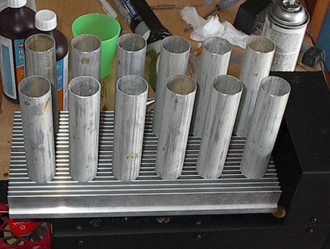

I used the chimney cooling on a high power amp here
It is very effective. I have driven this amp very hard and the cooling that I get from this arrangement has been enough.
Granted, this is not class A but there is still a lot of dissipation at high output.

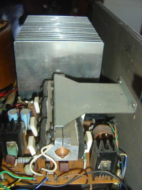

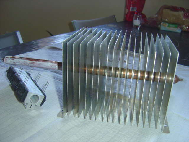

I think this will solve the issue for a nice solid metal to metal connection. Per the pic, a channel is machined to encapsulate the pipe into the block creating a solid metal to metal connection. Yes it will take a lot of solder with the length of the piece at 12", but I think this will be optimal.
IMO

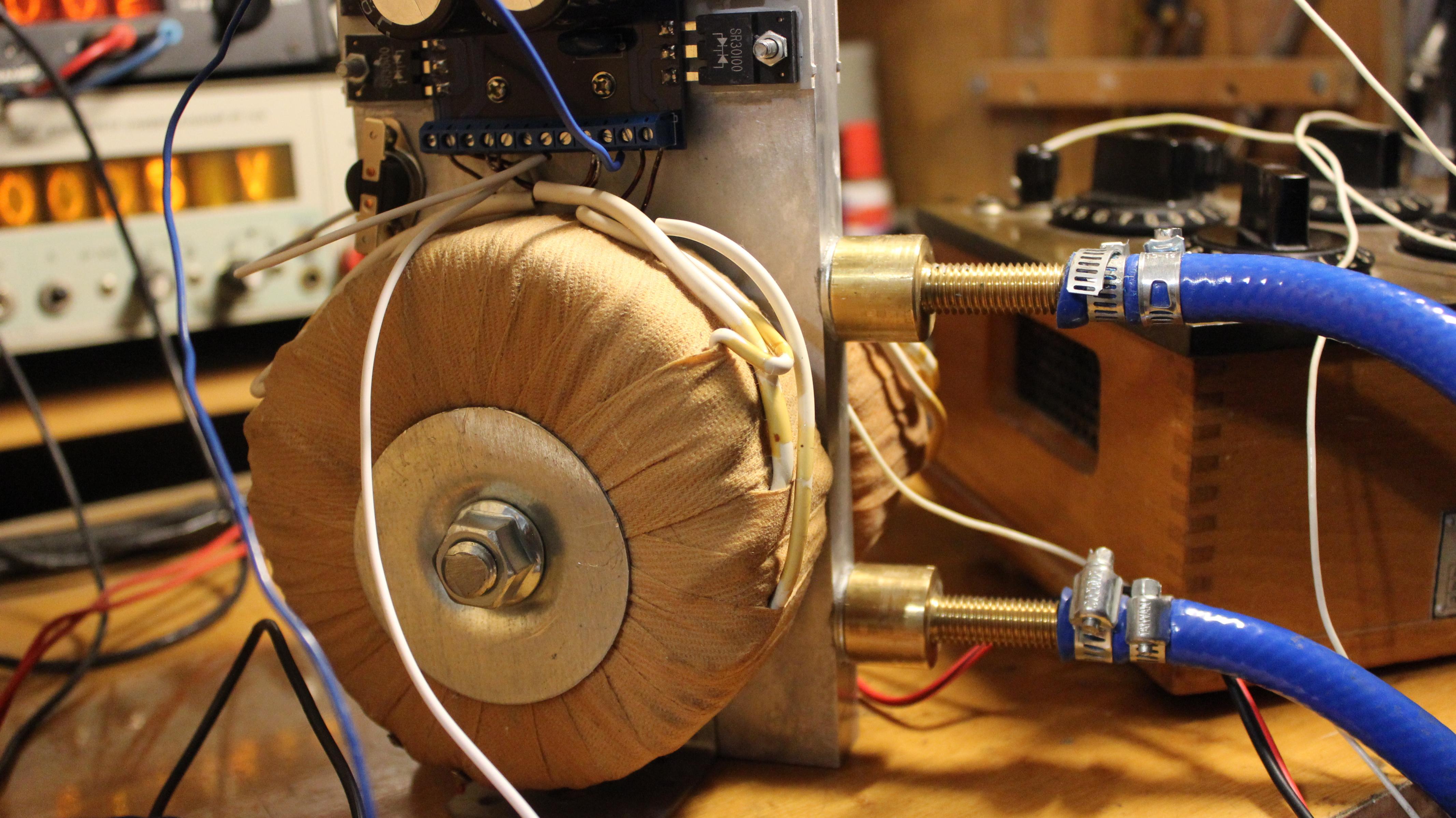

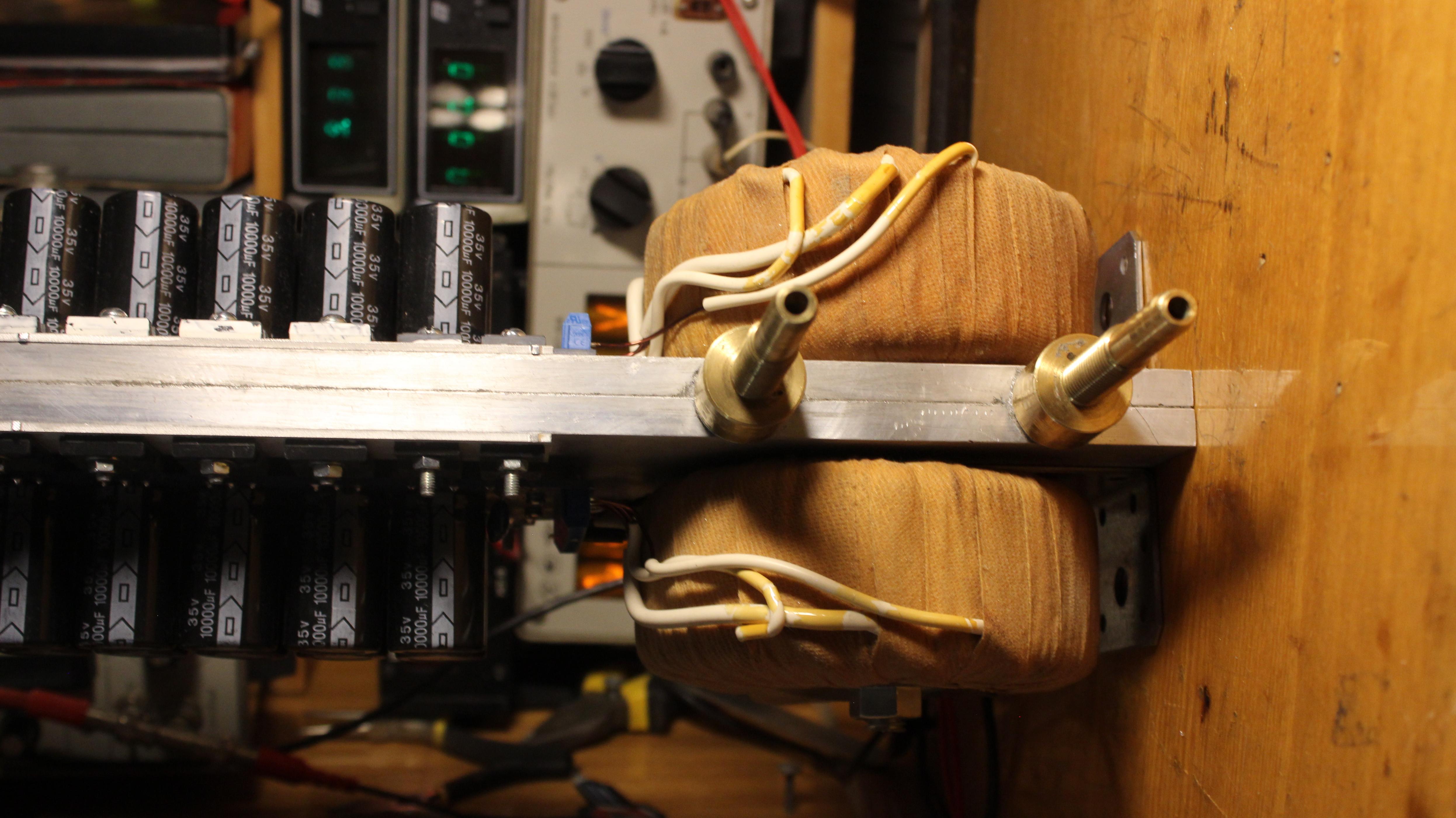

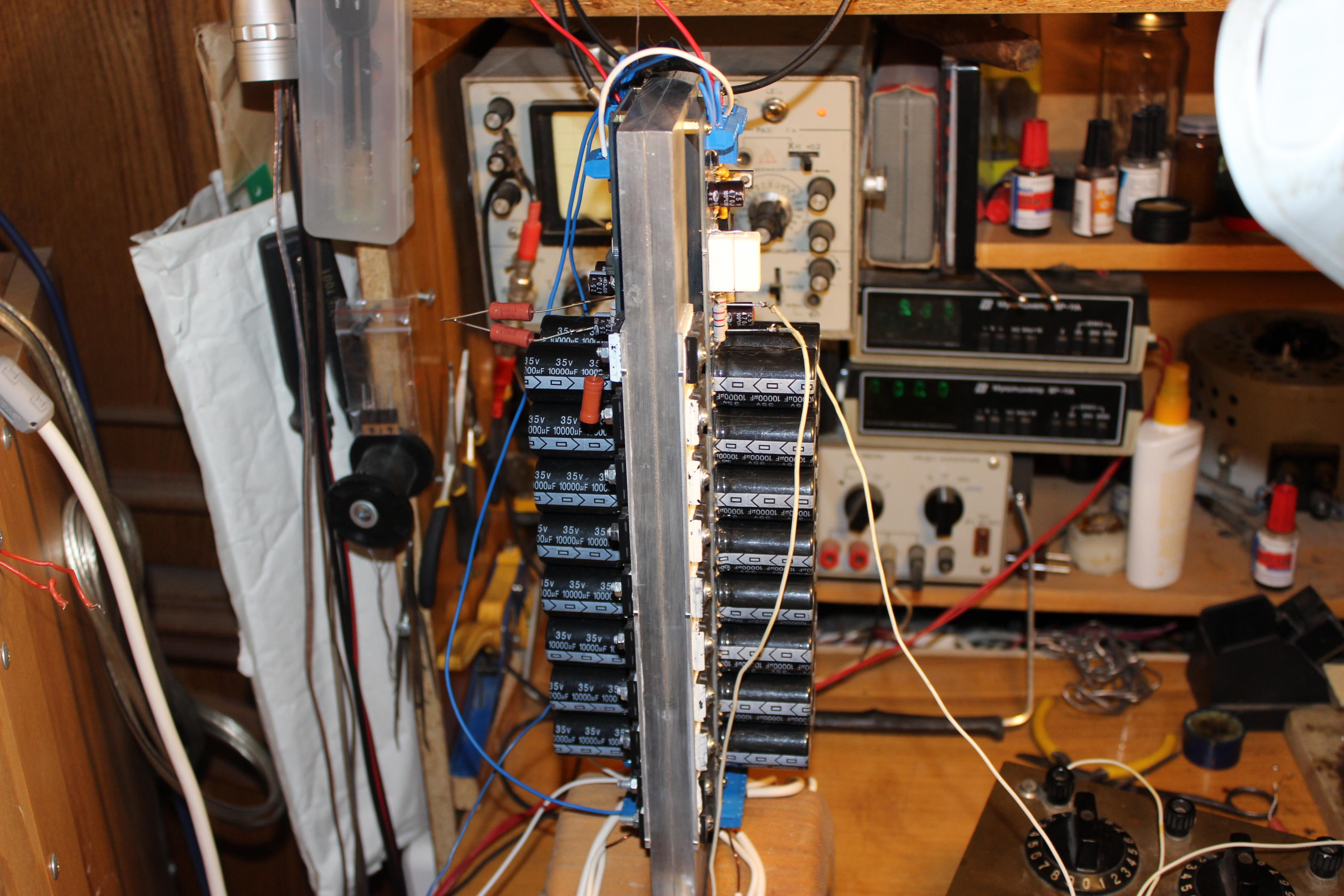

My new system. Repeater 120 watt Class A - three bands perfect solution AKVABLOK ??????????? ???????????? ??????????? - YouTube and even roller ??????????? ???????????? ???????????. ?????2 - YouTube
Monoblocks are water-cooled completely silent in operation and moreover are compact enough. Quiescent current repeater 3. 5 A for the N - P - N channel and P - N - P channel in the amount of 7A. Power supply + - 36Volt.Vyhodnaya 100 watts
http://www.diyaudio.com/forums/soli...nnel-p-n-p-channel-repeater-plated-input.html Post 174 compact monoblock szes scheme
