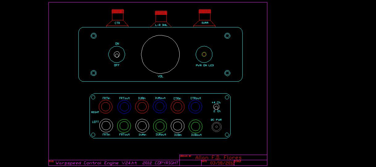

HT App
V24.ht on Fig. 3 or 4 of post #190...

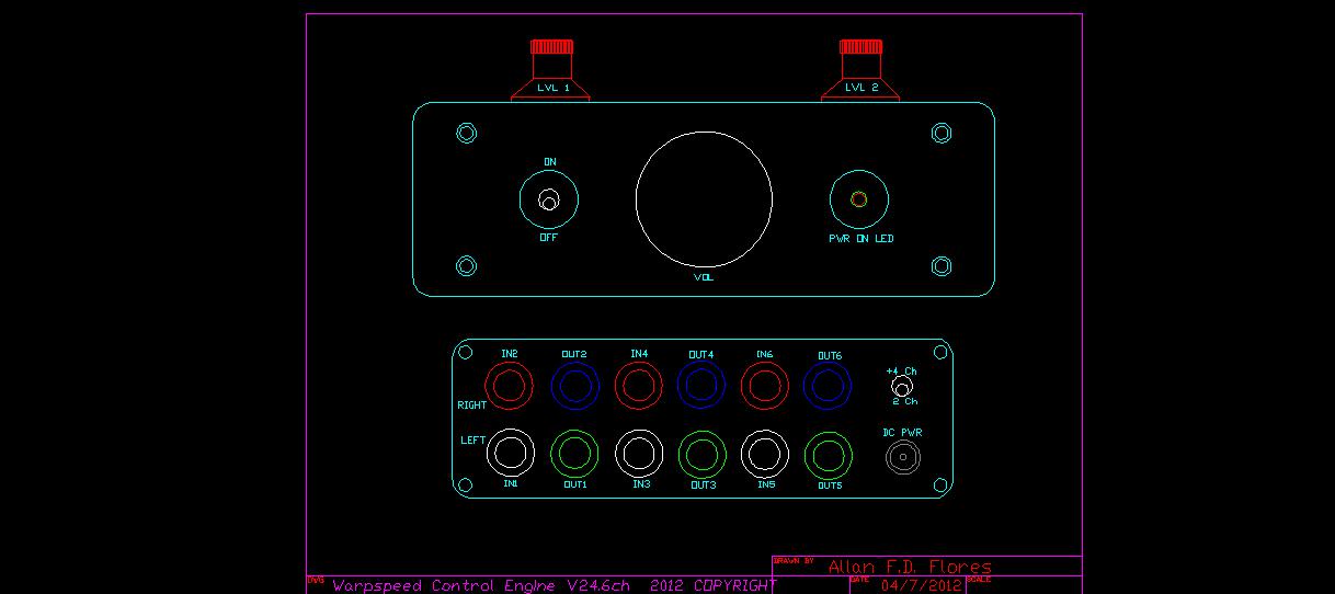

To explain the the rear panel switch labeled +4ch > 2ch...this enables you to switch off 4 channels when you're cruising in stereo. Another green way of doing things and save on battery power if not in HT mode. :warped:
Also, the LVL controls on top adjust levels relative to each channel and these levels will be maintained when the main volume knob is rotated.
The V24.6ch build is complete and it's on the test bench...tested a couple of parameters...the inclusion of the low current draw circuit sacrificed about 2.5dB of attenuation range of channel level (LVL 1-6) control. It now has a range of about 5.5 to 6dB down from the original 8dB. This is still great and will be more than enough to level balance each channel with respect to one another. Aside from that it is mirroring the 'Squid's technical performance and precision.
The LVL pots are calibrated with the Kraken while set at midpoint (5 scale on the dial) so we have an adjustment range of -3dB thru 3dB wherever the main VC setting will be.
