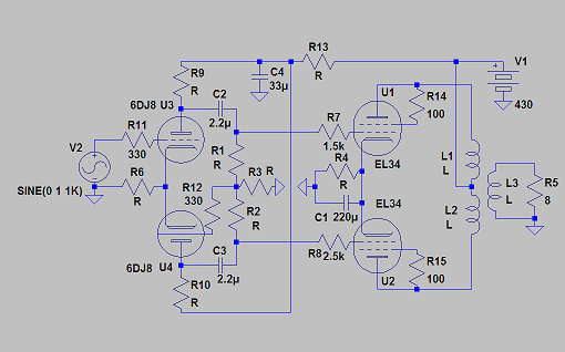

If you want a dynamic sounding simple amp without NFB you will have to get rid of the terribly unlinear ECC82. The investment in one 6DJ8/E88CC per channel should be no problem. The same guy that did the AI series 500 is behind this one.
With the right OPT this one will deliver over 10W ClassA with below 1% THD.
If going only Class A you can save money by skipping the EL34 cathode cap.
If you want to try other OPTs it can be adopted to be used with a 115+115:6//6V 50VA mains toroid as OPT. The EL34 cathode circuit will then need some sand to get equal current through both tubes.
By the way, do you now the impedances and other data of your OPT?
Sensitivity is on the low side but I suppose you have preamp? If not, it could easily be constructed using a single 6H30 together with two Lundahl LL1544A.

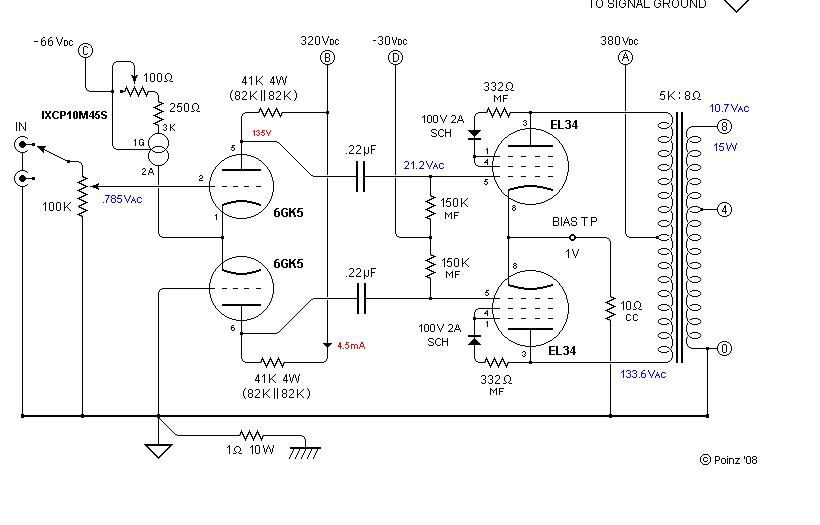

SY: Poinz's 6GK5 schem is attached. Any comments/improvements on this design? I have a pr of hashimoto HW-60-5 (60 watts, 5K) Output tranformers, a quad of EL34's, KT88's, and 6550's and misc driver tubes so I am open to suggestions. I am comfortable designing the PS but I would like to use a published and proven design for the rest. I am looking for a triode design. (pretty much the same as the OP)

A CCS diff amp is an excellent way to go SE to PP. I know that it violates his philosophy, but I'd sure want to put grid-stoppers in.
Understand that this circuit will not be good for all loudspeakers because of the low damping factor. I'd guess that it would pair best either with sealed boxes with lowish QTc or as a treble amp in a biamp setup.
