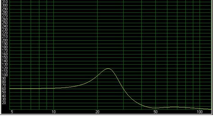

1. do you think the 150 watt to 4ohms amp http://www.lautsprechershop.de/hifi/det150 en.htm will be powerfull enough for the 10" peerless xls or do you think i should go for the 300 version (its a bit over my budget) i have attached a screen of predicted SPL with 75watts (worst case i think)
2. Should i put Damping Material in my box
Given the 8 ohm impedance you get less than 150w. The more powerful amp would be advisable, but it depends on budget. It's not a huge SPL difference (3dB), but the difference is clipping is more likely on the lower powered amp.
You should check:
* have you modelled all the filters included on the plate amp?
* check apparent amplifier load - it shows the actual load the amplifier will see and while you input 75 watts, it may actually require 500 watts due to the effects of impedance and eq
* check driver excursion that xmax is not exceeded at any point

Overall, 4 ohms is better for a sub driver as you get more power out of the amp, but the XLS impedance drops down quite low at its top end. This isn't a problem for those who cross low at 40 - 60 Hz but in your case, you want to run it up high where the impedance is low. I'm not sure its a good idea to use the 4 ohm version and run it up that high from an amp point of view. Risk of overdriving your amp to the point of failure increases.
