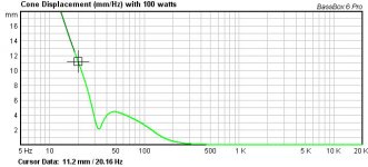

Do those charts take account of the rumble filter? It doesn't look like they do. GD will go up, excursion should be controlled below tuning. Look at excursion - you reach xmax at 100w because the rumble filter is either not shown or not doing its job - the driver is idling above tuning and below it is out of control.

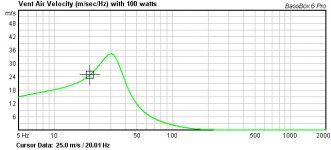

Vent velocity is too high. This will be improved by the rumble filter, but those charts don't seem to show the effect. Again, they need to be included, then you will see how the rumble filter will reduce turbulence by reducing the extreme excursions below tuning.
Look up Collo's vent calculator - which shows acceptable vent velocity for a vent of a given size and flare radius.

I did some sims in WinISD.
Try this:
35L net box volume
20 Hz tuning
Set highpass (rumble filter) to 10 Hz 2nd order (based on the bk amp specs - a bit of a guess)
Set lowpass (crossover) to 2nd order @ 55 Hz
Result:
F3 @ 20 Hz
Upper -3db point is 100 Hz
With 100w max excursion is exceeded below tuning as expected, but this should be within the suspension limits of the driver so it is safe and would mostly only occur with movies. Above tuning the driver is idling at 100w. For music it will have an easy job.
Vent velocity is high. A 65mm PVC pipe needs to be 660mm long to achieve tuning and flares on each end are essential - as big as you can mange to build. Vent velocity reaches 28m/s which may be a problem at times. If you go with a bigger vent this will reduce vent chuffing, but because the box is small, the vent will be long. You could improve on this aspect using a 45L box with a 90mm vent which will now need to be 1m long but the velocity will remain below 17m/s now.

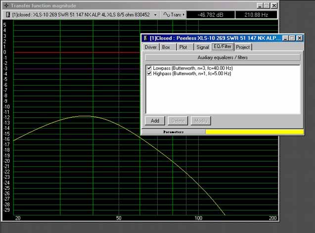

hi
I emailed BK a pic of my winISD project to see if there BSBP 200/8 amp's had the filters i was using in my project ( Lowpass butterworth n=2 fc=40 and Highpass butterworth n=2 fc=7).
this is the info on the amp i got back
first email
The BSBP 200/8 has two low pass filters in series one is fixed at 140Hz at 12dB / Oct the other is variable from 40Hz to 120Hz at 12dB / Oct this filter can be bypassed.
On the low end the natural filter of the amplifier gives a -3dB at 5Hz
I think for any custom filtering you would need to run the amplifier with the filter bypassed and build in your own filters
second email
I modelled the Peerless driver in a 50 Litre enclosure and set the eq. to HP 5 hz single pole and low pass 40Hz 3 pole which would be more like what the panel would give set to 40hz and I have attached the image
so now i know that amp wont do the job unless i build my own filter can anyone point me in the right direction how to build a lowpass butterworth n=2 fc=40 filter or better still where i can buy one
thanks guys

ok thanks for the help its just when he modeled the responce he put down n=3 if you look at the attached image from my last post and when i use n=3 its not anywhere near as good as when i use n=2 for what i want
(just incase my post was not very clear the second email was from bk also)
thanks
