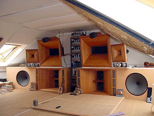

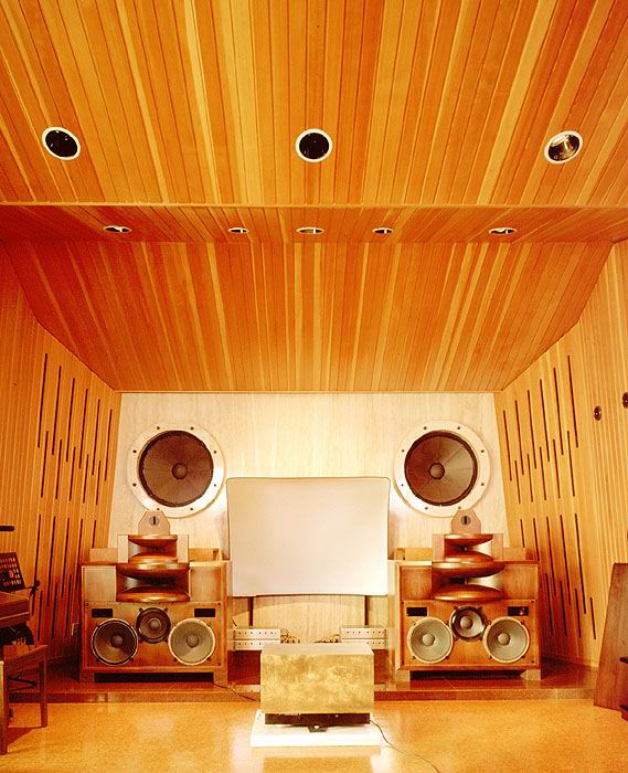

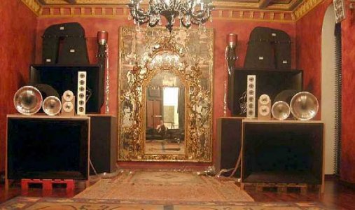

Nelson posted this pic awhile back and I thought you might enjoy seeing it if you didn't before.
Pretty much solves the WAF problem I would think; not to mention lack of bottom end...
