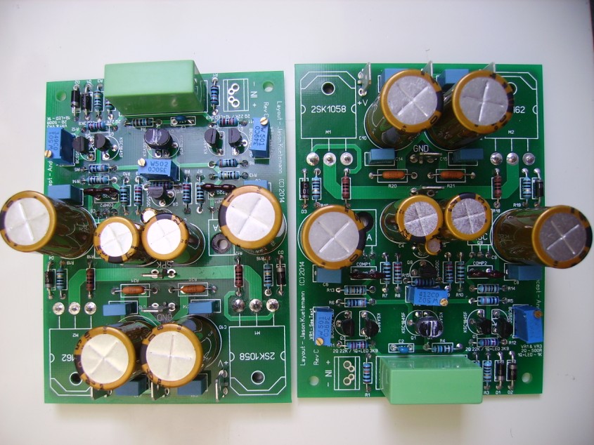

OK Been busy(ish) Now have two boxes with SMPS fitted Both work Or at least there is 26.5 V on each rail ..both SMPS's read equally.. surprisingly given their humble origins.
15 v on secondary SMPS output rails
VSSA boards are on their heat sinks.. All ready to go.

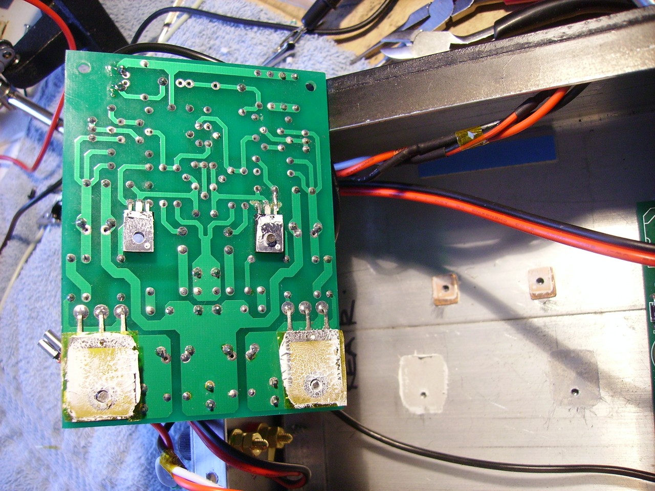

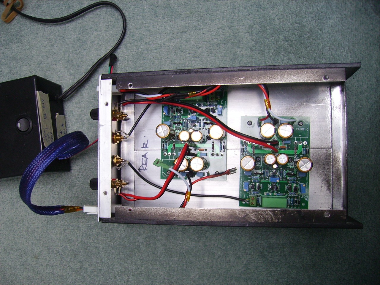

We have flame And smoke
Added 11 ohm resistors betwixt + And - power input spades and their power supply wires as suggested.
Pretty well instant smoke then Flames.
Resistors burnt to a crisp.
No other damage evident.
Clearly I've bungled 'something" Sighhh. No Idea what though.
I did ..triple.. check the board stuffings. Months ago though
Attached photos for study... in case I've done something Obvious ??

Good question.. So I just now checked No shorts to the chassis On all 4 transistors on the board (s) I just powered and the as yet unpowered/tested one.
Was worried that I may have bits of wire /solder touching the heat sink metal.
Doesn't seem so ..so far.
Flamed resistors were 1/2 watters.. If that's significant ?
DO have a short/continuity between + spade - spade and Gnd spade (or any combination... on both PCBs ...tested one and not yet tested one.
Seems as possibly intermittent ..transistors working?? no idea
Frightening? or not??

I can't see how you have the transistors mounted to the heatsink. I looks like the outputs and VAS transistors are mounted through the board. How did you get them all 4 tight to the heatsink when they are different thicknesses?
If you have a short from V+ or V- to ground it will obviously instantly burn any fuse/resistor that is in the path. You have got to find out where the short is. Can you give us a clear picture of the bottom of the board?

Try to do a diode test on all the BJT's. + lead to the base leg of all N-channel transistors and the - lead to each of the other two legs. For the P-channel use the - lead to the base leg. You should see between .4v-.7v. Q1, Q5 and Q6 are N-channel and Q2, Q3 and Q4 are P-channel.
Try to get us a picture of the bottom of the board.
OK.. photo attached;
Slight soldering traces bungle .. I had initially gotten the wrong part # bit in the wrong place bit messy admittedly but it all meters as OK despite appearances.
Other board has no such weirdness.. mercifully.
No apparent evidence of dangly solder wires/bits even getting close/shorting to the Heatsink metal.
Did have to check though as you raised a valid point ..that was in the back of My mind as well.. to be honest

Yessss I too was worried about bungled fitment of the Black Box transistors .
As I ..had... gotten them wrong on first install, albeit months ago.
But I Did correct them..back then. Sreened numbers match the part # Or So I thought? [ OK just bent them over and Looked ...part # ARE correct}
Also had 'Some confusion' as to which direction the Smaller transistors faced in relation to the Heatsink. You gave an answer and I followed it.
Could it Still be wrong??
