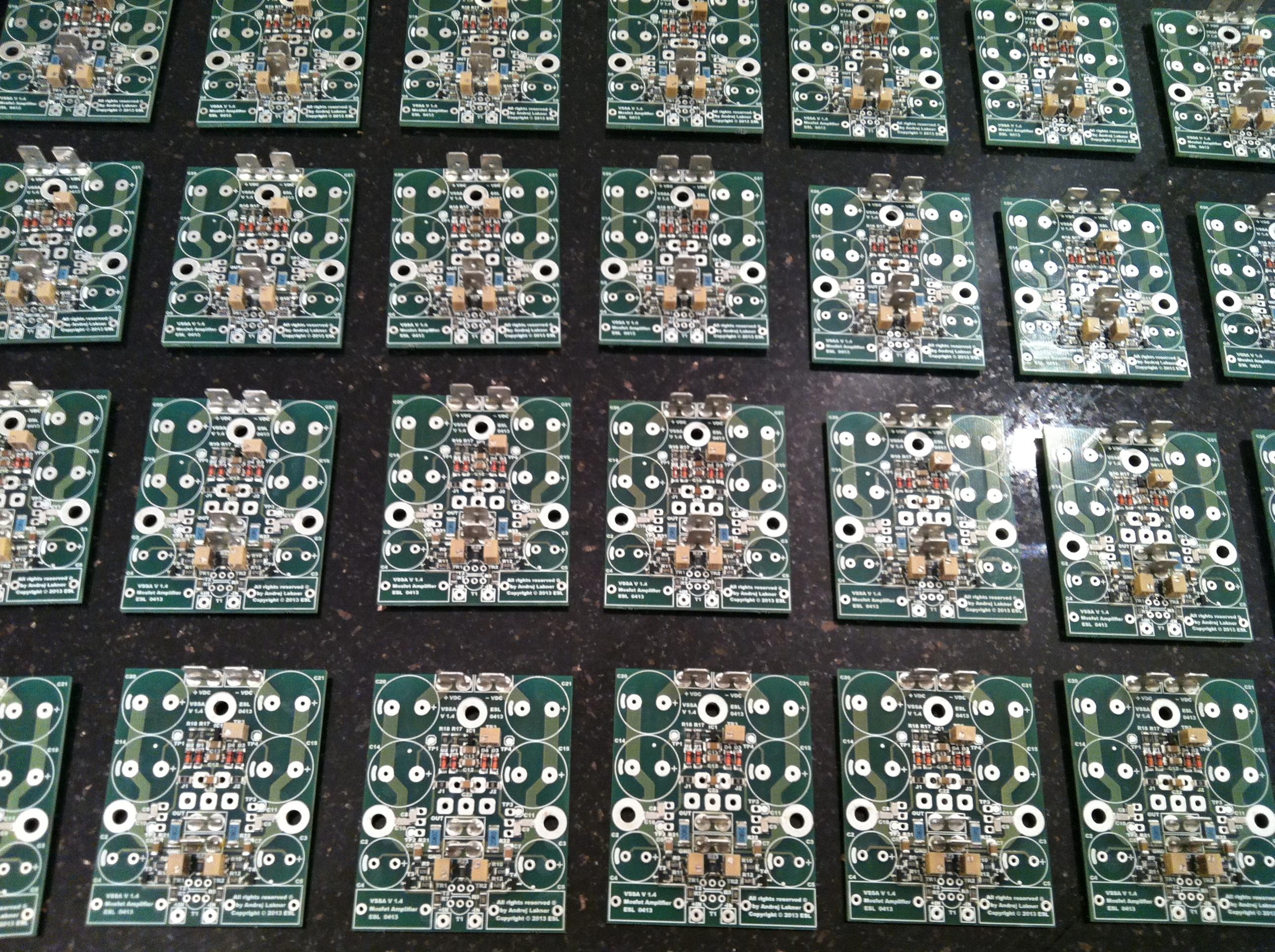

Silmics are too big(16mm) to fit properly. Max. that can fit in that position is 12,5mm in diameter. You can bend a current source transistors a little, but those 10uf MKT are also in the way. See post #318,#332. I have also trouble finding Nichicons FG 2200/6.3 and 1000/50 together so it means separate orders and shipping cost.
GB Capacitors dimensions info
I am repeating the info posted in #978 just for clarification how big capacitors can be, not a mm bigger.
Yes, there will be 250 sets in this GB, so at this time there are still some 30 PCB sets available.
Capacitor dimensions for VSSA PCB:
- 10 uF/63 V, MKT, Vishay-Roederstein, 2 pcs
Lead Spacing: 15 mm
External Depth: 8.5 mm
External Height: 17.5 mm
External Width: 18 mm
- 2200 uF/6,3 V, FG, Nichicon, 2 pcs
Lead Spacing: 5 mm
External Diameter: 12,5 mm
External Height: 25 mm
- 1000 uF/50 V, FG, Nichicon, 4 pcs
Lead Spacing: 7,5 mm
External Diameter: 16 mm
External Height: 31,5 mm
Three preinstalled SMD trimmers will be permanently located on PCB, type 5 tourns, Bourns, for DC offset/VAS bias (2) and output bias (1) setting.
I will also add a Kapton insulator for TO-247 and two plastic spacers for TO-126.
Assembling and calibration will be straightforward and very simple.

Hi GB members
73 out of 86 GB members already payed and confirmed VSSA orders. Thanks a lot.
13 GB members still on the move to pay and confirm. If someone from this remaining group intends to cancel the order please let me know soon, cause some new guys are waiting in the row to receive the offers.
Delivery note (without any price stated) and VSSA installation manual will be included inside the parcels shipped to each delivery address.
Invoices will be send separately to your e-mail addresses.
Tomorrow all pre assembled VSSA modules will finally be delivered to me.
Regards, Andrej

GB Info
Hi GB members
First VSSA PCB batch arrived, all others before Wednesday, since I ordered the guys to clean up all PCBs more precisely.
The delivery formula will have "and" function between order date & payment date, I think this is most fair approach.
First ones expect PCBs next week.
Regards Lazy Cat
Hi GB members
Regards Lazy Cat
