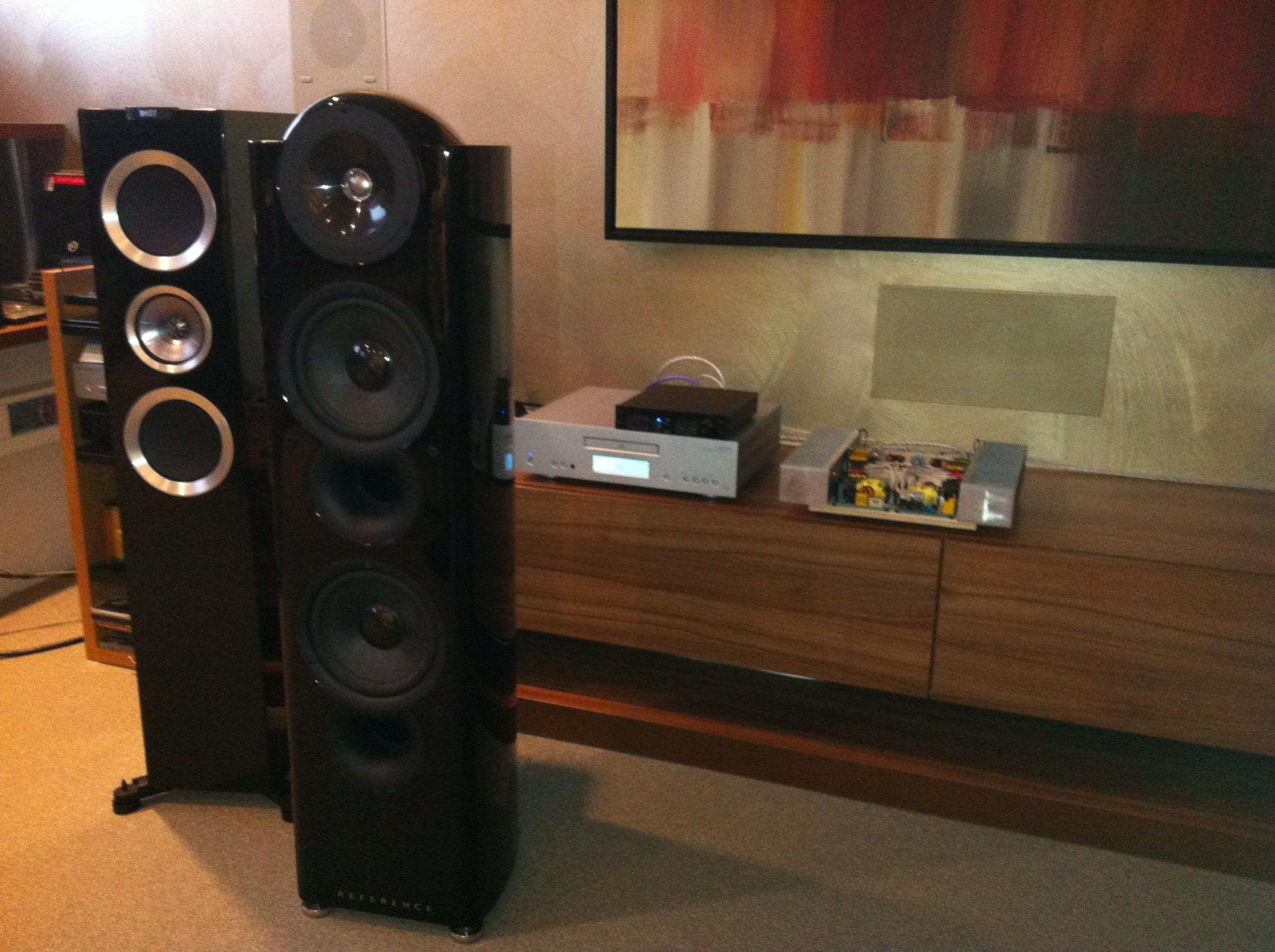

BTW last Friday we had a test in one shop on KEF R700 and Reference 205/2 speakers and shop owner already ordered stereo VSSA in a flat case. ;)
