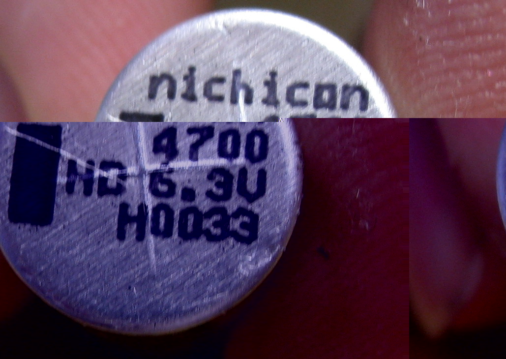

I bought this version: http://www.diyaudio.com/forums/swap-meet/265336-vssa-1-4-new-not-assembled.html
Available there capacitors:
1. Nichicon HD 4700Uf 6.3v http://www.rom.by/images/wiki/f/fe/ECAP_Nichicon_HD.jpg
2. Nichicon KZ MUSE 1000uF 50V 2 Pcs Nichicon Muse KZ 1000uF 50V High End Audio Caps | eBay
3. Nippon Chemi-Con KME 50V 1000UF 100pcs NCC Nippon Chemi Con KME 50V 1000uF Electrolytic Capacitor 16 25mm 105? | eBay
4. Panasonic FC 1000uF 50V 50pcs Japan Panasonic 1000uF 50V 105°C Radial Audio Electrolytic Capacitor | eBay
5. NIC Components Al Cap Radial NRSZ Series 50V 1000uF Nrsz102m50v16x25f | eBay
6. TOSHIN 1000uF 50V 4 x Toshin Jovial Utsj 1000uF 50V for Audio Electrolytic Capacitor | eBay
This is a list of what I buy in the city, without ordering.
They are suitable for this amp? if not, what is for him the best option?

Hi AxelFPS when LC did the build he recommended Nichicon FG. That said it will work with whatever brand and cost if capasitor works as the values written on it is electrically at the legs, but as reported many times every capasitor has a sound signature.Greetings Lazy Cat!

Here two links from this thread that can be a help for qustions including physical size made on PCB for the capasitors. A last thing not mentioned in the links is try isolate from PCB the two screws placed at VAS to not get a ground loop (The one at output device not necessary to isolate). Good soldering .
Links: http://www.diyaudio.com/forums/vend...lateral-mosfet-amplifier-254.html#post3653117, http://www.diyaudio.com/forums/vend...lateral-mosfet-amplifier-321.html#post3814157 .

Nichicon FG is recommended, but you're invited to try any brand name you can think of as long as the values are exact from the BOM.
