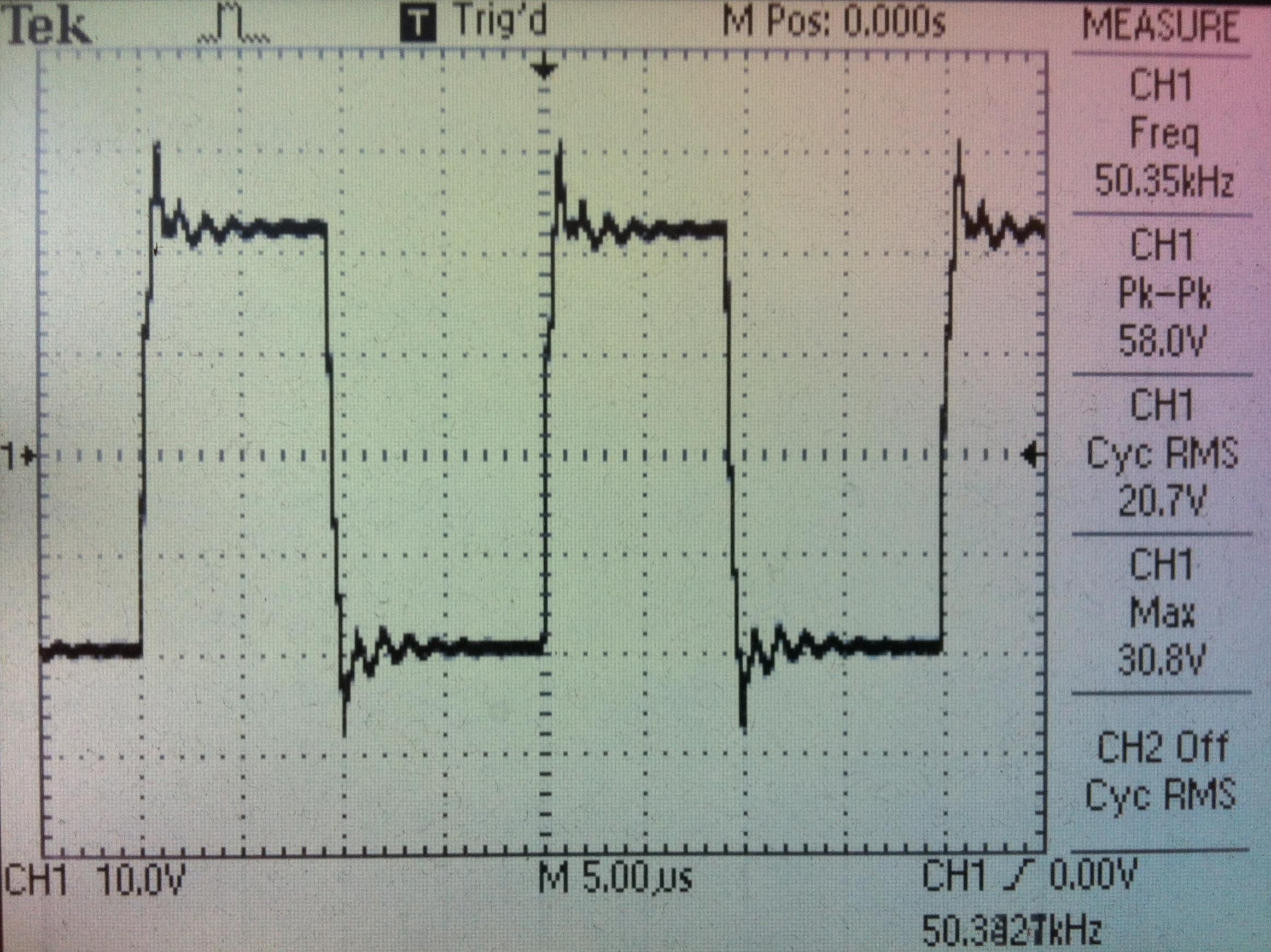

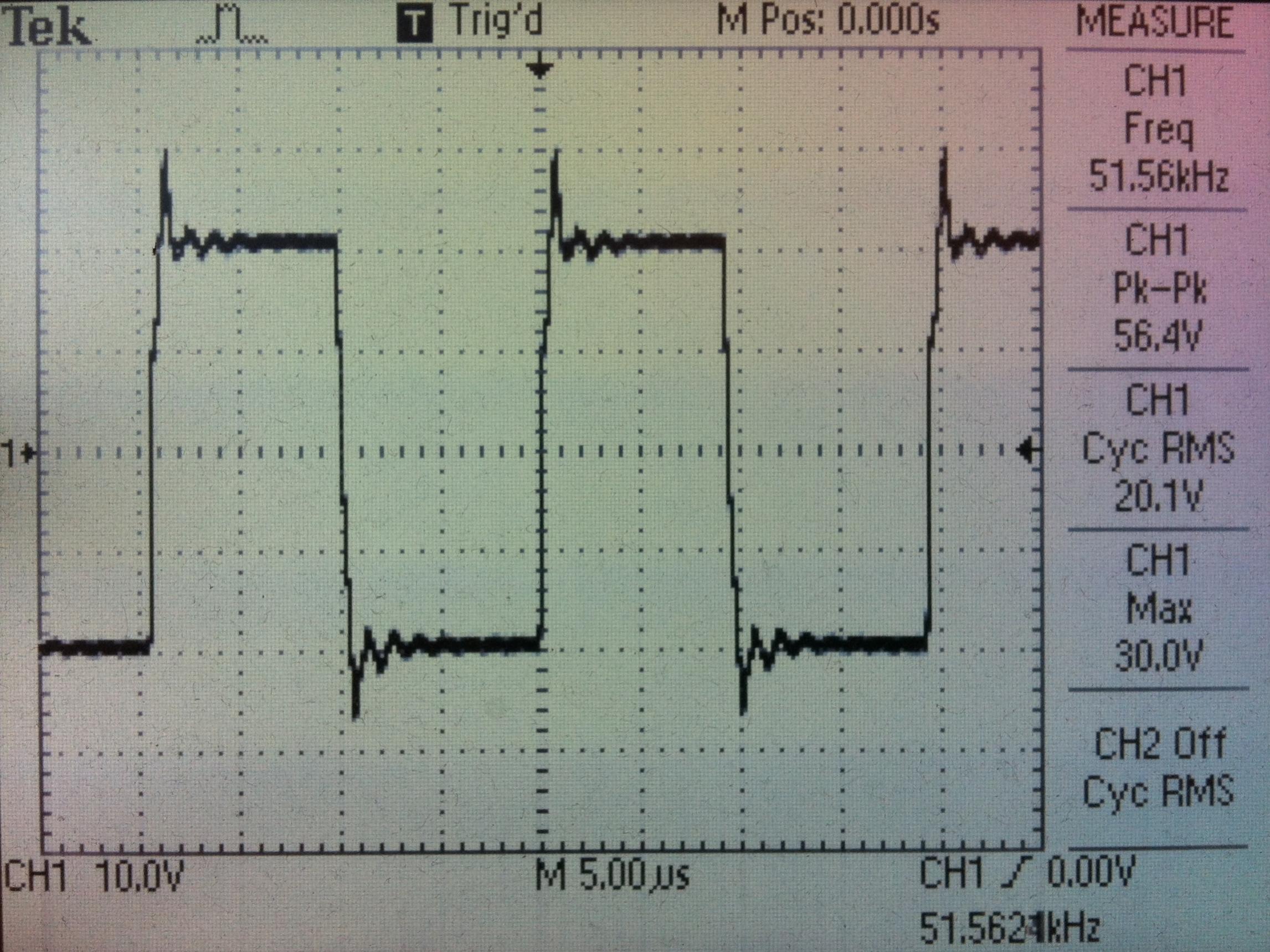

how better is THD with CCS? Reduced 3rd harmonic?
Didn't measure, but you can get quick impression by comparing these two. ;)
Before and after. :D

My intention was on purpose to check behaviour with current injection resistors as I explained detaily before why. For CCS I could drawn them in the first sch pic, but as I said, current injection resistors here have so special position that they deserve prime design. Also from comparisons plots you can see that the difference is so small, all in all very good result for one to use resistors only and VSSA sounds great with them too. :yes:
CCS brings a little extra to the whole picture. :D

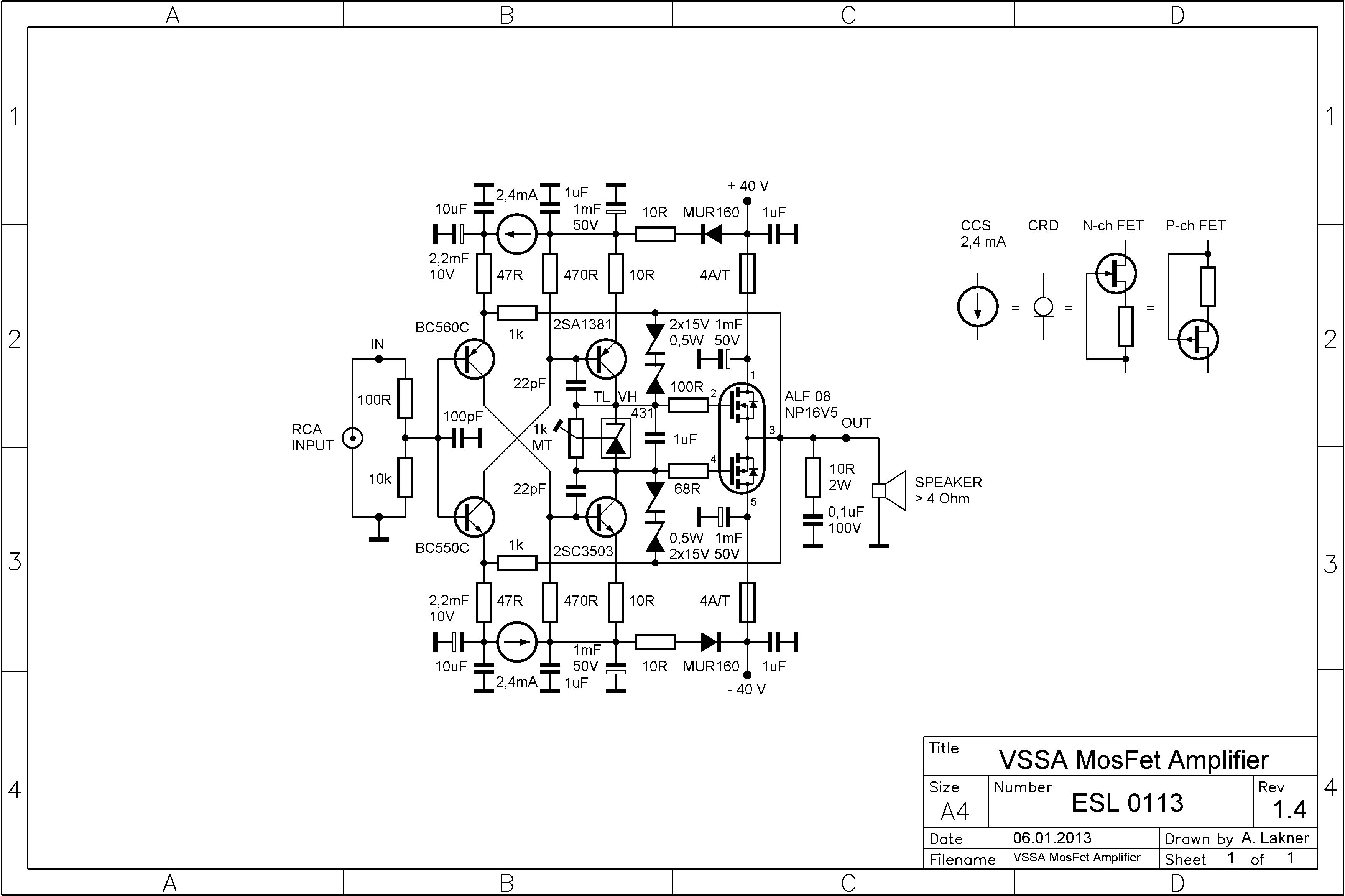

VSSA 1.4 Schematic
VSSA 1.4 Schematic final version from which I wish to design PCB. Should be two layered, very compact PCB, populated with SMDs where it is possible. VAS and output transistors mounted below PCB, fixed to the main heatsink. Initial offset and bias setting trimmers will be replaced with SMD resistors (two in parallel) tuned to exact measured value. CCSs will be probably made from j-fet plus resistor, since CRDs are hardly obtainable. For the fuses I'm thinking to remove them to PSU. All suggestions regarding PCB design welcome. :up:
Regards Andrej :cheers:
