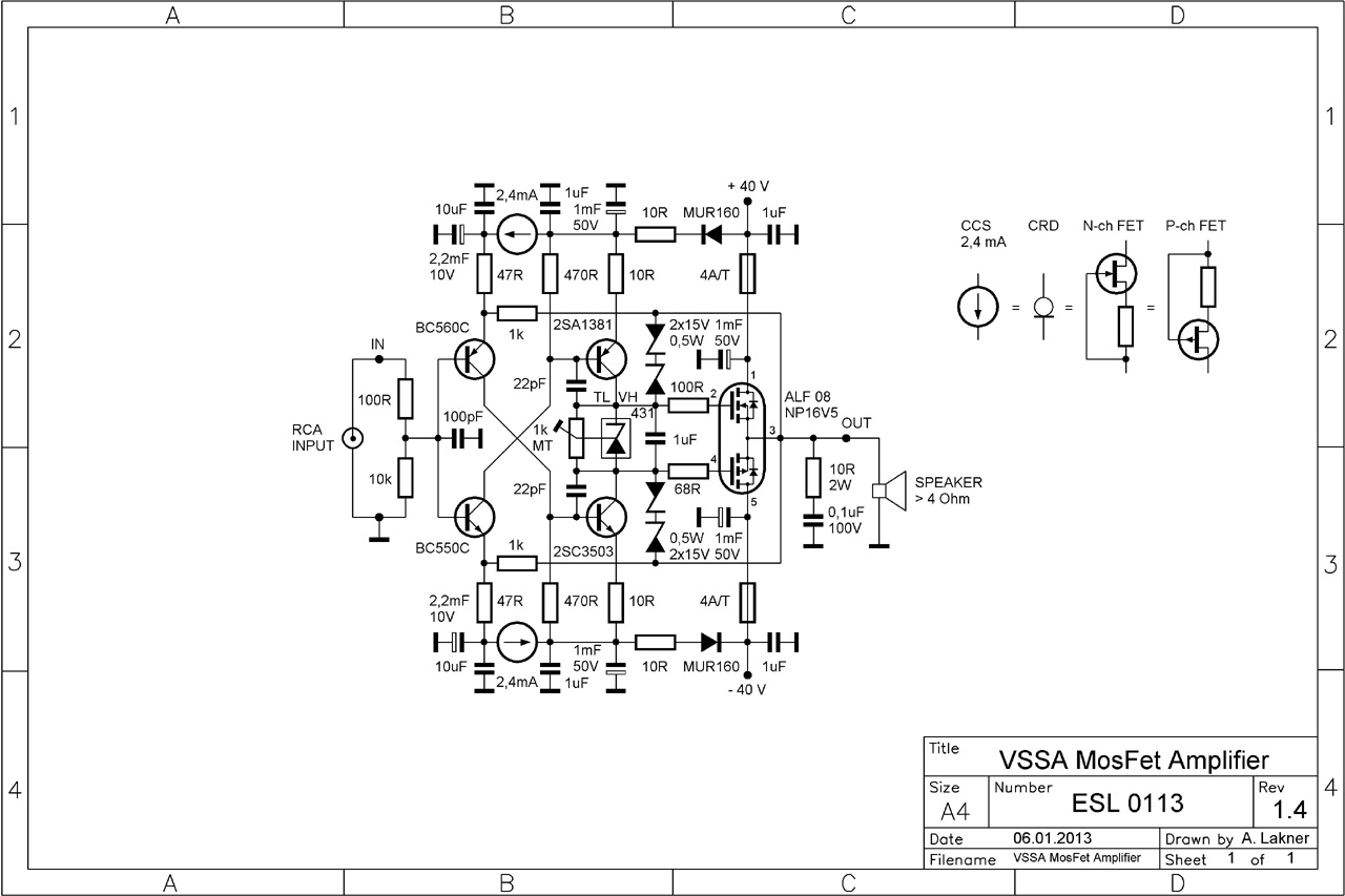

I would not do that.Can we bridge two of those modules together for a 4ohm load?

Ok so bridging not recommended. Still im interested in two more modules.

It is because your mentioned PSU and load is at edge in bridge senaria.
I think you know relationship between voltage current and resistence, and here your SMPS400A180 data is not good for bridge setup as it is for single module setup.
For bridging it is best with 8 ohm loads, but can be done i think with 4 ohm with reference to post from LC where he mention one module can do 2 ohm if ALPS 8a limit never get exeeded. So you need to control input level in a way so 8a limit is in control.
When doing bridge version PSU voltage/current dimension is very different than single module.
Regards Ricky

2sk1530/2sj201 pair can be used in this circuit? No need to change?

You need some change since the mentioned Toshiba Fets not lateral like LC uses at the orig.
If you search for HexFet or Bipolar VSSA you will find already the schematic and layout for that version to.

Different mosfet structure, different temperature behaviour, 2sk1530/2sj201 pair would need temp compensation circuit.
