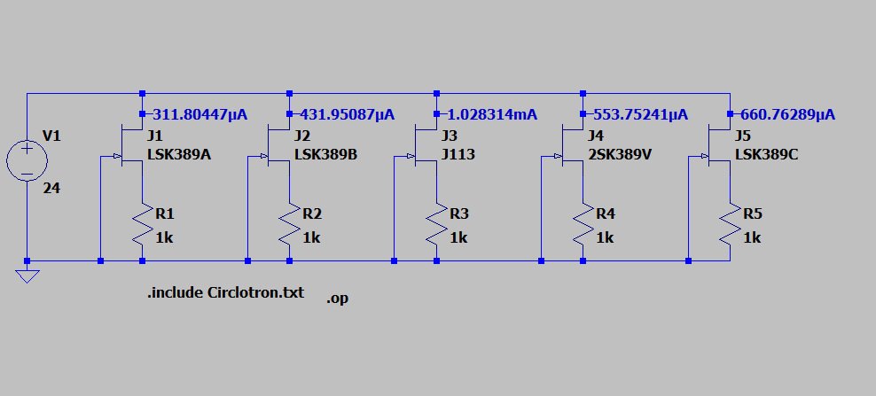

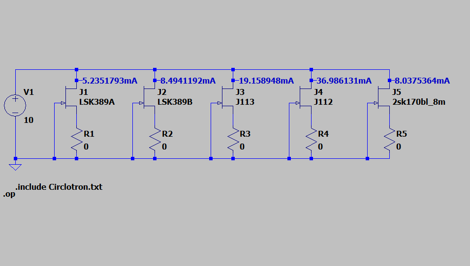

I think there is a problem with the J113, I have an IDSS of 19mA...
nothing in common with 2sk389GR
.MODEL J113 NJF(VTO=-1.2854 BETA=9.25964m BETATCE=-0.5 LAMBDA=3.03839E-2 RD=1.30170 RS=1.30170 CGS=1.05000E-11 CGD=1.20000E-11 PB=5.04493E-1 IS=9.86870E-16 XTI=3 AF=1 FC=0.5 N=1 NR=2 MFG=PHILIPS)

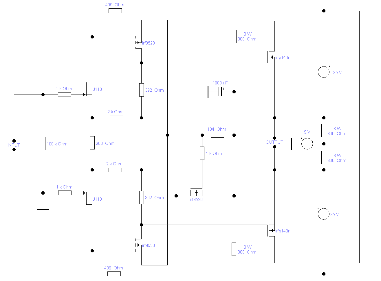

Well, I have tried to keep to the VSSA (very simple) philosophy, but you are forcing my hand a little. ;-)
A real CCS will have trouble with less than 1V across it. If the goal is run the input JFETS at a higher idle current than self-biasing would allow, I would suggest the approach shown below. This uses a battery (or its virtual equivalent) to place the output terminals at a negative voltage that lets more JFET idle current flow through the feedback resistors. This has the added benefit of reducing the Vds across the JFETs, making gate leakage less of a potential issue.
You can certainly use an actual 9V battery for this, as it supplies almost no current and should last for years. Or, you can create its virtual equivalent by adding a 9V zener shunt regulator across each floating supply and combining their outputs through two (say 10K) resistors to charge a single filter capacitor that acts as the virtual battery.
The following diagram only shows this conceptually, as I will leave the implementation up to you. What it does show, however, is that the feedback resistor values have increased to give about 4-5 mA bias through each input JFET. The input devices now see about 14V Vds, so the circuit will now accommodate a wider range of JFET types without problems, and in fact, you can even use NPNs bipolars and enhancement mode MOSFETs as input devices.
As a postscript, you may need to reduce the 499 ohm resistor values in practice with this approach due to the higher input stage idle currents, but I left them as-is in my sim and did not see any stability problems.

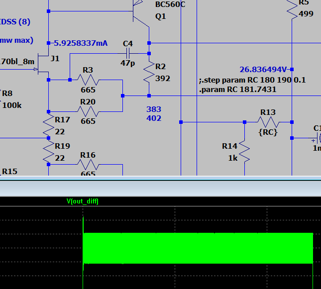

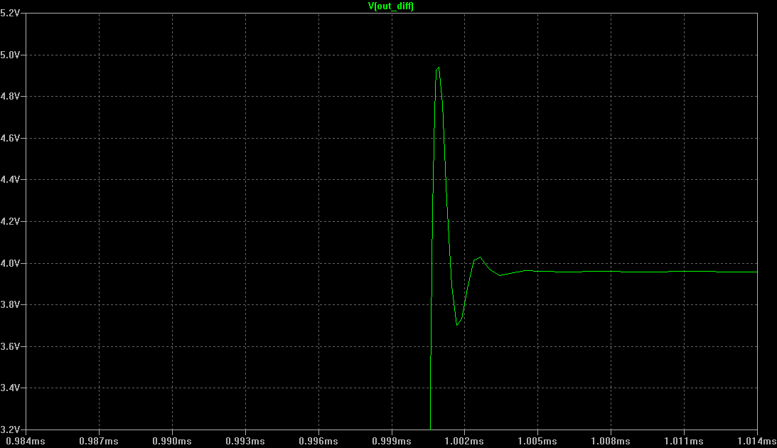

Is it the circuit in post #150 that is oscillating? If so, it may help to move the compensation caps. For example, you can try from collector to base of each Vas transistor, or from each Vas collector to the source of the JFET driving it.
Nothing wrong with using the self-bias connection shown there, as long as you don't mind a little DC on the output, which fortunately also lowers the JFET Vds a bit. And I think you'll still be able to drive the amp input single-ended if you want.

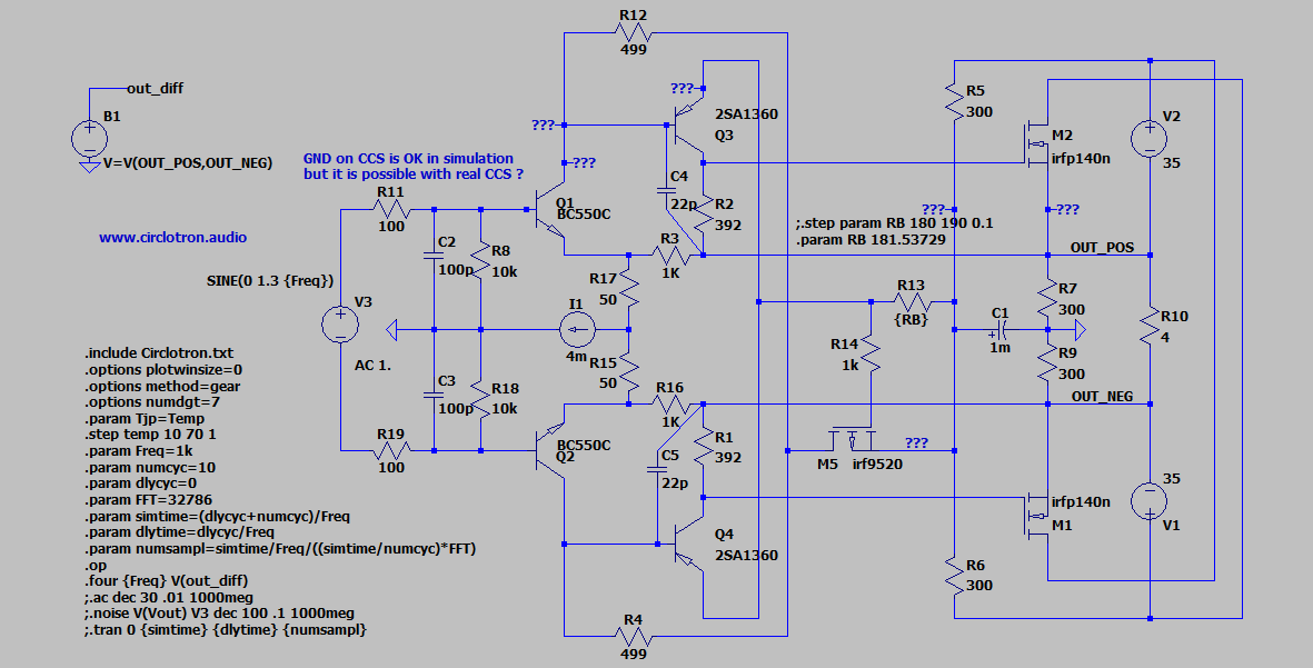

Yes it is the #150, so i try 47P on Jfet source to collector, not good.
47p on base to collector seems to work, that's enough?
In fact i have a balanced output Dac/preamp so I would like use XLR on amplifier input
what I use in balanced input is good or not ? (1k 100k 100p)

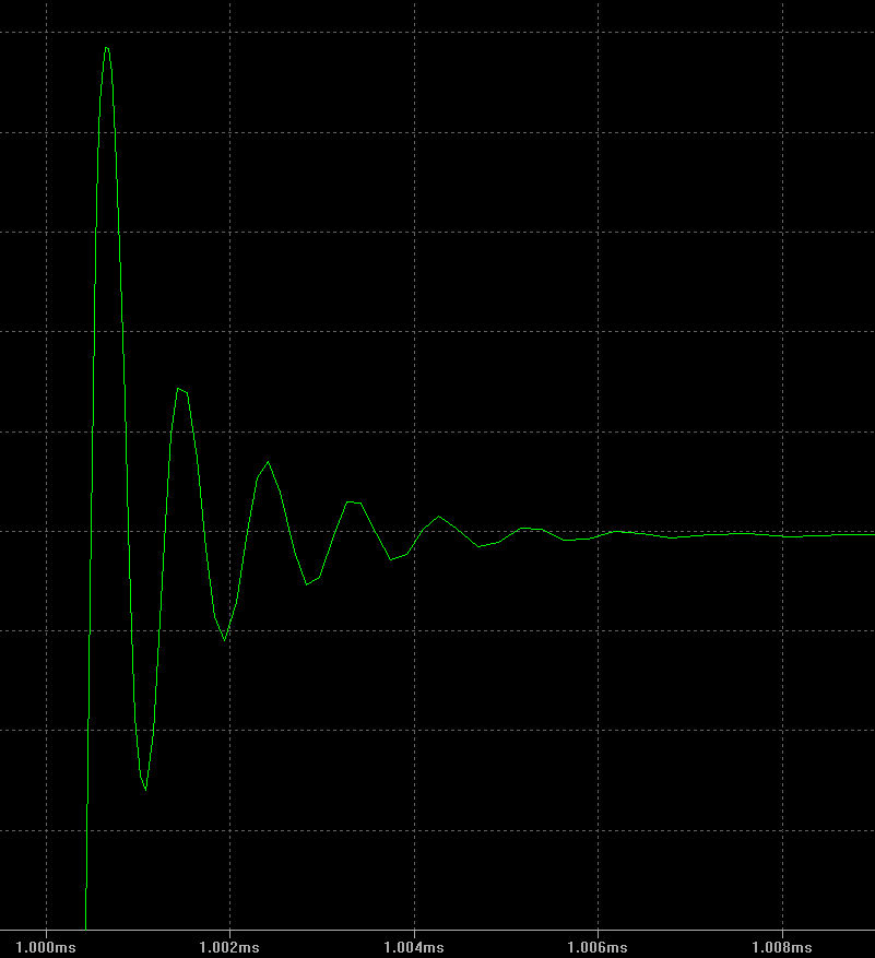

Ideally you want minimum overshoot and ringing on reactive loads. I'm not aware of any standard for this, but I like to see no more than 20% overshoot followed by no more than 1-2 cycles of damped ringing, like the results you saw from the circuit when using my component values.
You might see improvement with your bipolar Vas by adding a resistor in series with each Vas emitter. I would try values in the 10-100 range and see if that improves square wave response. You may still need the collector-base caps, but I'm not so sure about the ones shunting the inputs.

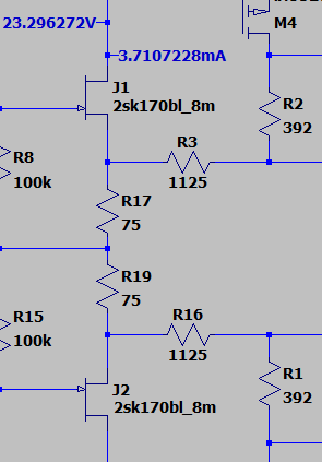

I put the j113 but with an higher current with 100ohm in parallel to keep E92 series
0 overshoot
http://circlotron.audio/data/simulation/img/20190527_J113.png
http://circlotron.audio/data/simulation/img/carreJ113.png
I also noticed that increasing R7 R9 decrease the distortion without changing the bias point, i keep 300ohm ?
The step response looks like it has some high frequency ringing. Try a freq sweep from 1 Hz to 50 MHz. In a real build, I have found these high freq peaks in gain. From the spacing of the peaks of ringing, I guess 2MHz.
